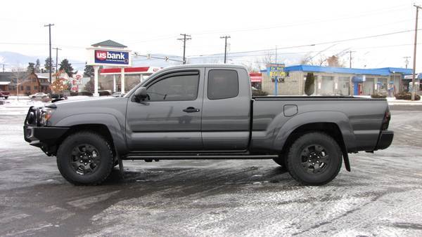

    Well I bought my truck back in October and I just finished her up a few weeks ago after much research, work and liberal use of the credit card :)
    Here is how she sat when I bought her (no its not my real hair)
    And here is how she sits today!

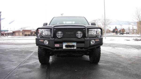

    ARB front bumper with IPF 968 6' Driving lights (no winch, I might get one in the future if I start to get into off-roading) Also installed a Grillcraft front grill and turned one of the Tacoma badges I took off into a custom emblem. Painted the chrome grill surround as well.

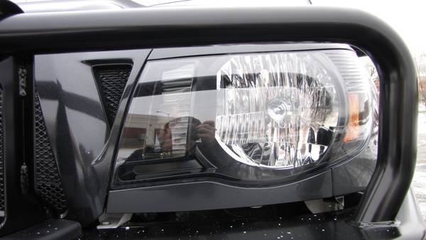

    Black Headlight Mod, in Krylon Fusion Satin Black
    Color matched eyelids and EGR deflector

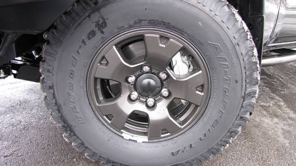

    Stock wheels painted with Rustoleum Hammered Finish Black. BFG AT/KO's in 265/75/16

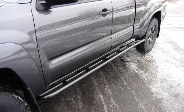

    Stubbs Welding HDSKO Sliders in Hammered Finish Black (Richard was a pleasure to work with, top notch product and customer service)
    EGR in channel rain guards. Front window tint.
    Wet Okole Seat Covers. Weather Tech Mats.
    Tinted tail and 3rd brake lights compliments of Auto Lights Unlimited. Powder coated rear bumper and TRD Cat Back exhaust.
    Other mods include a factory bed mat, Compustar 1 way remote start and an AFE Pro Dry Filter.

    Is that ARB on stock suspension??
    Doesnt look sagged at all!

    I shot them myself after talking to Westdog976. He shot his as well and turned me onto this site http://www.automotivetouchup.com/spr...t_matched.aspx the eyelids are on ebay from seller Vq5speed here: http://cgi.ebay.com/ebaymotors/Tacom...Q5fAccessories They come primed which is nice you just shoot a few coats of base and then clearcoat em' I used the same stuff on my grill surround but shot some adhesion promoter on the plastic first. The paint matches really good, it even has the metallic flakes that are in the magnetic grey color. I still need to wet sand and polish the clear coat though...I was in a hurry to get it done.
    Yeah I was a bit worried about that, even posted to get some advice. Its not to heavy without the winch, probably about 80 pounds. Little to no sag and rides fine, it may wear the shocks out quicker in the long run but by then I'll probably be lookin to lift it a bit.

    I used the same paint from automotivetouch.com that I used on the eyelids. (see post above) I also shot the TACO emblem with it. The stuff goes down and matches remarkably well for a rattle can. As I said above, I need to do some finish wetsanding and polishing on the clearcoat though and it will gloss up more and match even better. I also messed up by not waiting long enough for the clearcoat to cure (at least 24 preferably 48 hours I now know) before I clamped the grill surround back to the grill. I took the surround off the rest of the grill so I could lay down the paint nice and evenly and so I didn't have to do any masking. Anyways, the tabs that hold the surround to the rest of the grill appear to be melted into place at the factory (there are no locking mechanisms) So in the process of getting it off you inevitably break several of the tabs (I even had to cut a few out with the Dremel) and the surround wont snap back into place after you paint it. In order to get it back on securely I had to clamp it down in several places and use some plastic weld to bond what was left of the tabs to the grill. Since the clear coat wasn't cured, the clamps ended up smooshing it around in a couple of spots, ruining the finish (you can see a little bit of it on the upper left corner of the surround in my signature). Luckily, it didn't get all the way to the base coat though so I should be able to sand it smooth, shoot a few more coats of clear (let it cure properly this time) and do the final wetsand/polish work. Just a heads up if you are planning to do it yourself. Or if you don't want to go through the trouble you can order a OEM color matched one for around 200 bucks.
