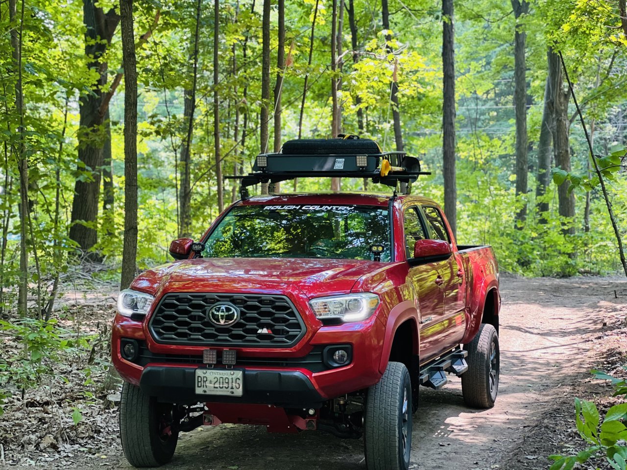

    Rough Country 6"

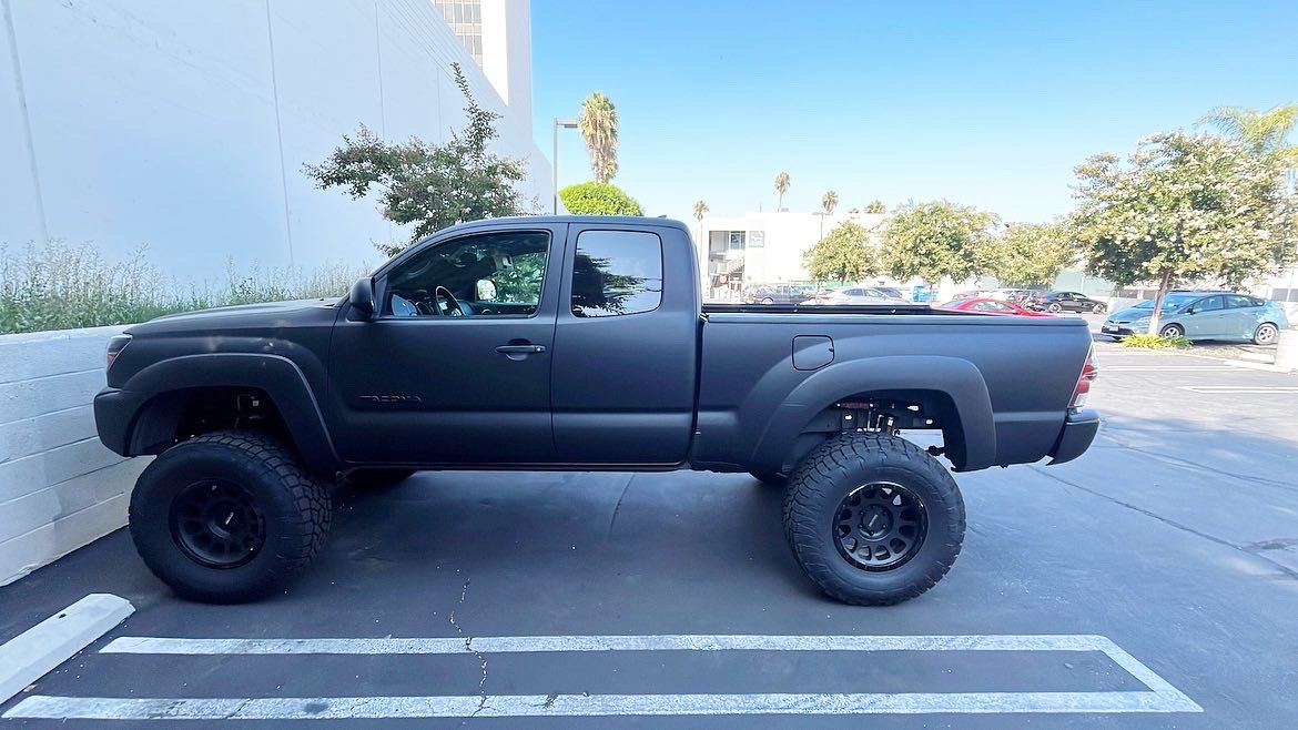

    Hey @Taylorbarton1 looks epic. I want to do the exact same thing to my taco. Which lift kit did you get? Yours looks level and great. Is the rear on blocks? My leafs sag too so which AAL did you get? And you were able to do the front with the bilsteins? Thought you had to get special 6in suspension for the lift?

    I had the same worries I went 6” with the RC kit with vertex coilovers and reservoirs and honestly my truck has never given me an issue I have 4 “ blocks and an AAL in the back and I love the way my truck looks just make sure you get it done somewhere where they know wtf they are doing. I got mine done at a 4 wheel parts by me but I could tell by talking with the guys they knew their shit plus this 4 wheel parts has all around amazing reviews. I would also recommend JBA UCAs they really go well with this set up or maybe another aftermarket UCA

    Dang that’s beautiful, what size tires are those? Forsure i would need aftermarket ucas huh?

    Thanks! 35s! I didn’t re gear either and ya it can be sluggish (on hills mostly) but it does the trick. I had 16 in wheels before but the RC lift called for 17 in tires and above so I went with 17s and then had to get new tires to fit so I went with 35s

    Everything looks great so far. I'm just going to change the steering rack because it got a leak and they told me that it's because I have big wheels. And I want to tell you if your truck is under warranty. If you do anything to it, you will lose the warranty, and this is a very bad thing, but it's all from my experience. He seems lonely so far

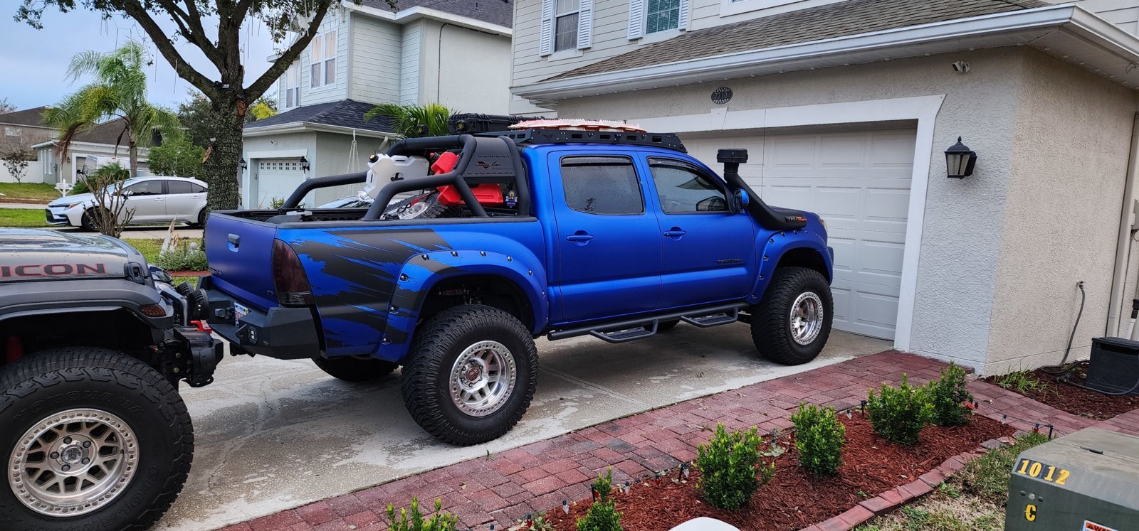

    It won't rub if you keep your sway bars connected. Once you remove the swaybar you will rub in turns and articulating. I had 4" blocks on the factory rear leafs and got rid of them and went with All Pro Expedition leafs and no blocks. I had to do the pinch welds, cab mount relocation, trim the lower rear part of the fender and max out my lower control arms forward. I have SPC UCA's so I adjusted the caster through there. Truck drives straight as an arrow and doesn't rub at all on the trails.

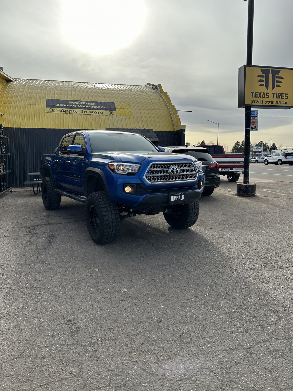

    Just got it done

    Nothing wrong with your lift,looks great too me.
