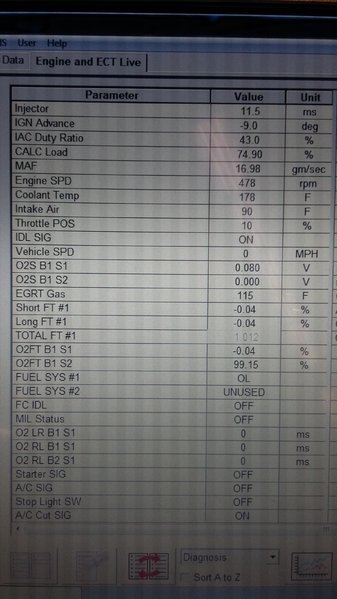

    Iv got a 97 tacoma 2.7l with supercharger and headers. When purchased it ran terrible due to horrible exhaust leak on header at the base of the O2 sensor. Secondly the spark plugs were covered in oil and tube seals upside down. Welded exhaust up, new spark plugs, new tube seals amd the engine ran like a top for about 5 minutes then started idling bad and no power again. Better than before with the leak but still bad. Only has one code noe and thats the P0101 whish would be great but its already been replaced and is brand new. Not too sure what to rry next now ideas would be great. Here is the information when idling (barely idling).
    Compression is good and so far the new plugs dont seem to be dripping with oil now but it hasnt run long since. It is still shooting black sut out the tailpipe wt the moment

    Not sure if you figured your problem out or not but idle RPM below 500 seems low and might be causing rough idle. Black soot is an air fuel problem, did you replace the MAF sensor?
    Has the truck every run properly with the supercharger. Maybe someone botched the install?

    Thanks for replying I totally forgot to post what I found wrong with it! So it had a piggy back ecu that could adjust the fuel input and the controller was missing. So when I unplugged it the first time nothing changed because it had been dumping so much fuel it took out the fuel pressure regulator! So I plugged the piggy back computer bsck in and replaced the fuel pressure regulator.ran much better but still had a hiccup on acceleration. Tried unplugging the piggy back again and ran like a top!!!! So all in all it was just the useless piggy back system someone threw in there! Runs perfect and she scoots along real good now! Thanks for all the help!
