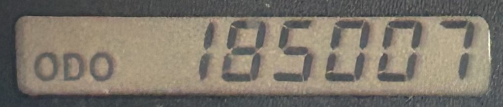

    Oh, buy new oe coils, too. Just do it. IMG_3657.jpg Cruise, cruise, cruisin’ along.
