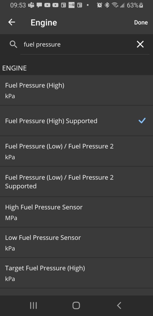

    I'm not sure what ultragauge can do, but you can get Fusion OBD2 phone based app and Toyota PIDs and have a very powerful tool to diagnose your truck. See Fusion thread.
    But ideally, you need a scanner with functions to test systems.

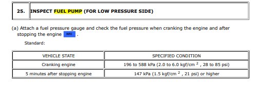

    Here is a simple test you can do to verify the pump is maintaining specified pressure once you get access to OBD2 tool
    To test the pressure drop with OBD fusion app on stopped engine, you may need to pull the pump relay
