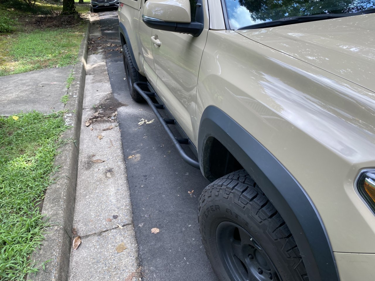

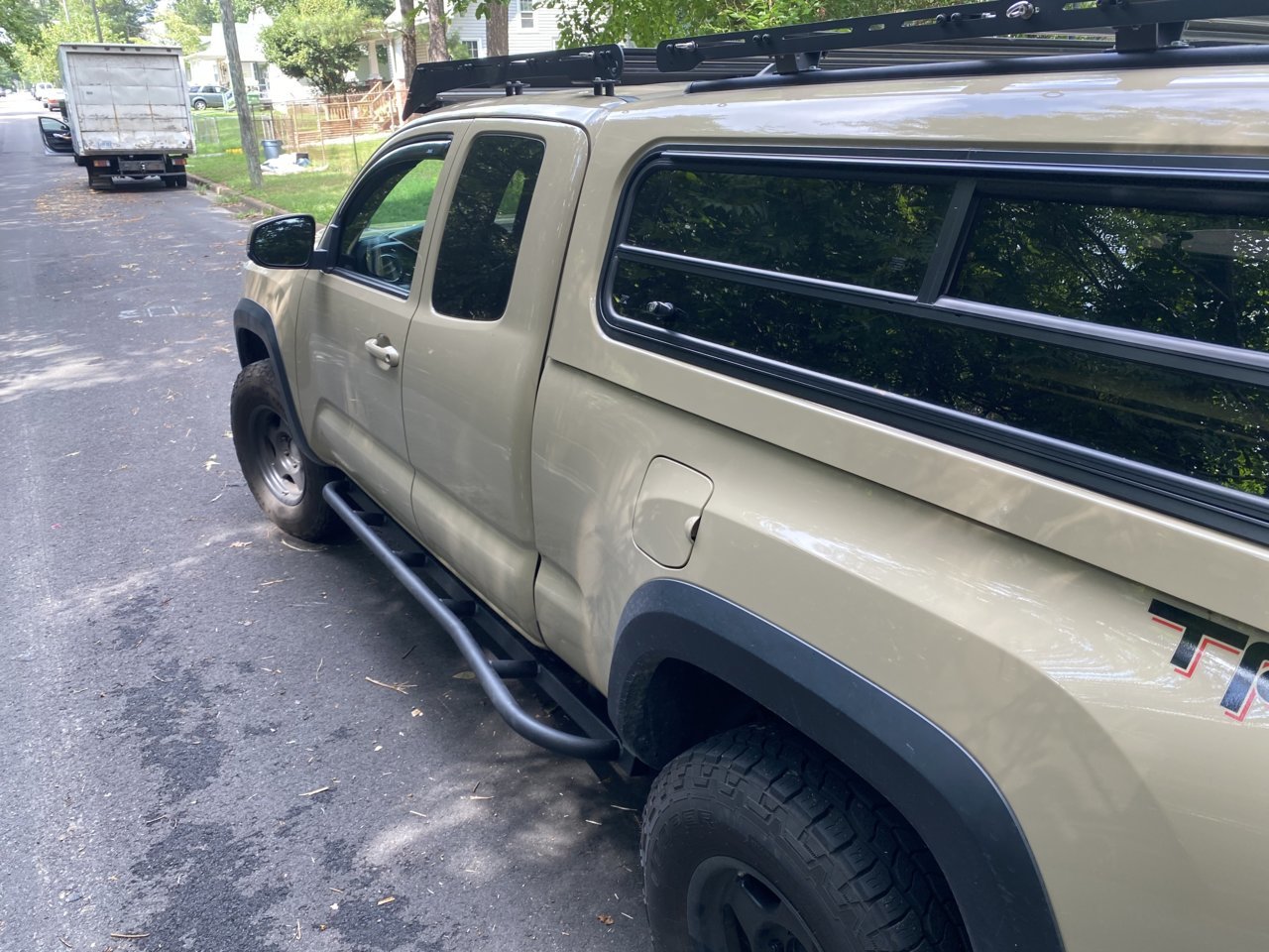

    I’m installing mobtown off-road bolt on sliders, drivers side went ok, and I thought I was on easy street until I tried taking out the bolt on the center underside of the frame.
    The thing won’t budge! It’s 14mm, and that’s the wrench I was using, but I rounded off the edges of the bolt.
    I have no clue what the best way to get this out is.
    Any suggestions?

    Ah, good info. I sprayed some kroil on it the day before yesterday but only from the bottom, I’ll try and get to it from the top as well.
    Can’t be driving around with one slider haha

    Finally got that thing out! Had to get a longer handled ratchet in conjunction with the bolt extractor socket.
    Thanks for the replies!
