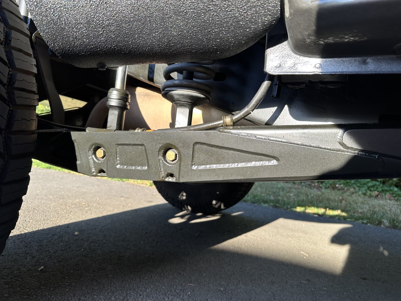

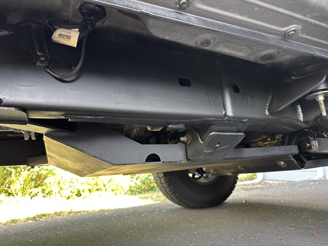

    Looks like the amber rp342 is on backorder and I didn’t feel like waiting for it to ship so I shot my frame with CRCs heavy duty corrosion inhibitor. From what I read and watched on YouTube it’s highly similar to rp342. Was easier to find locally although the only place that had it for next day pickup was Oreilly autoparts. Seems like these two products are both harder to find immediately.
    Will see how it holds up. Will shoot the interior of the frame with corrosion X HD later. Prefer non-drying liquid coats for inside of frames.

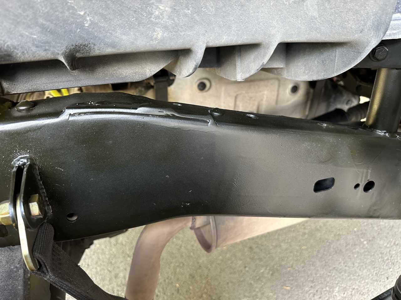

    My crc has essentially cured. Looks nice like the rp342.

    Either its dirt or you missed a couple spots.:boink:

    It’s thoroughly coated I went over it twice. Probably just the lighting and the frame has also had a lot of fab work done so it’s been repainted in places.
