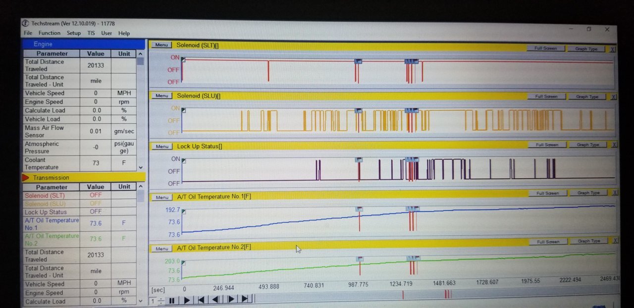

    This is visual on Lock Up status and SLU solenoid status.

    Flex-lock sure is busy...
    Looks like the 'steps' in SLU represent varying degrees of flex-lock(1/4 lock, 1/2 lock, etc.)
