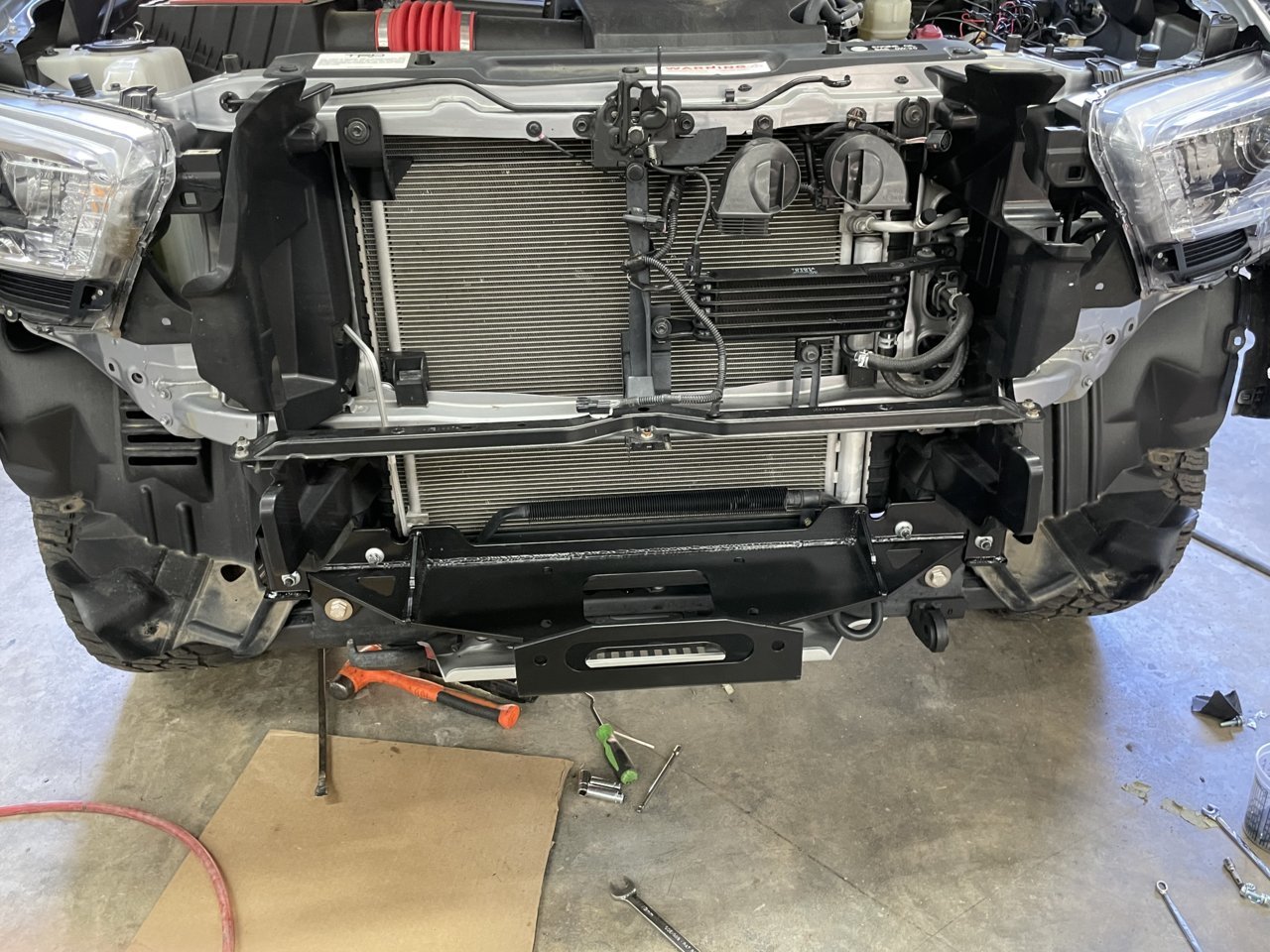

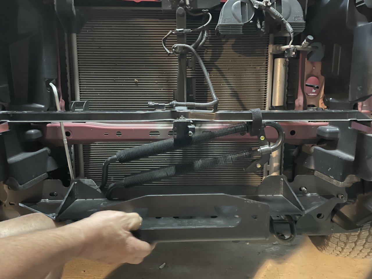

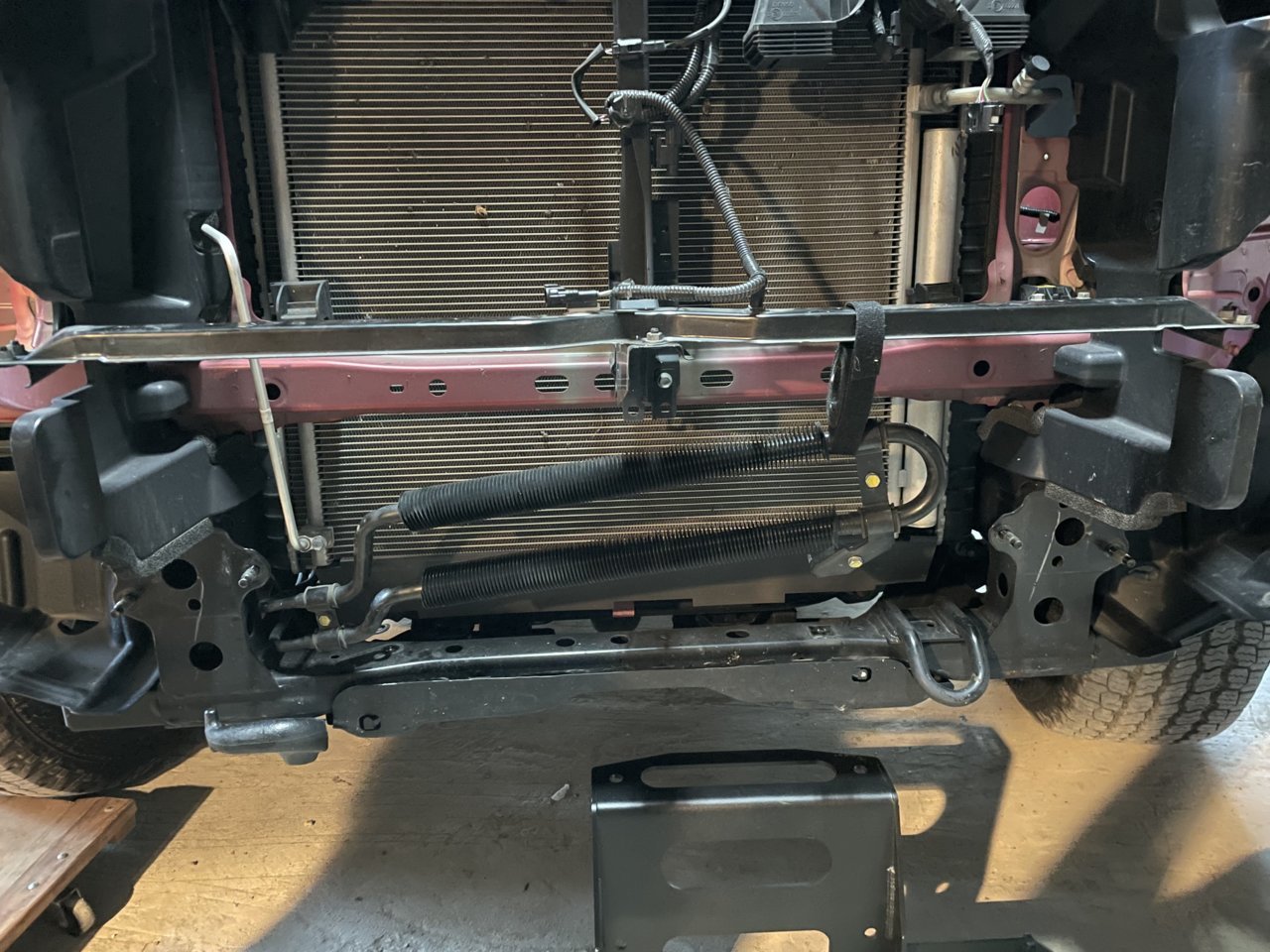

    I bought the Relations Race Wheels (RRW) hidden winch mount. The description said no modification required. So, how do I mount it with the transmission oil cooler right there? The truck in their picture doesn’t have the oil cooler.

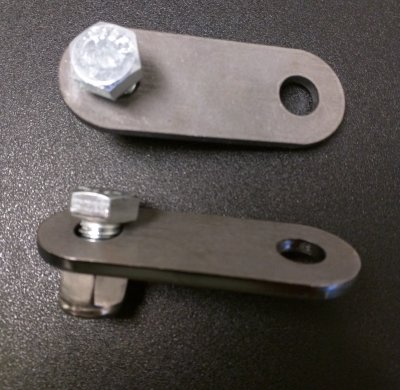

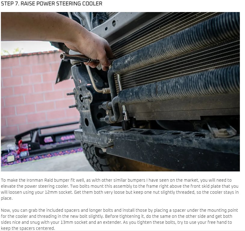

    Found this from a different bumper install instructions. Was curious, since never heard of a transmission cooler like that. It's actually for the Power Steering.

    So yeah, either you need to make some spacers, or maybe hitup the manufacturer and see if they forgot them??

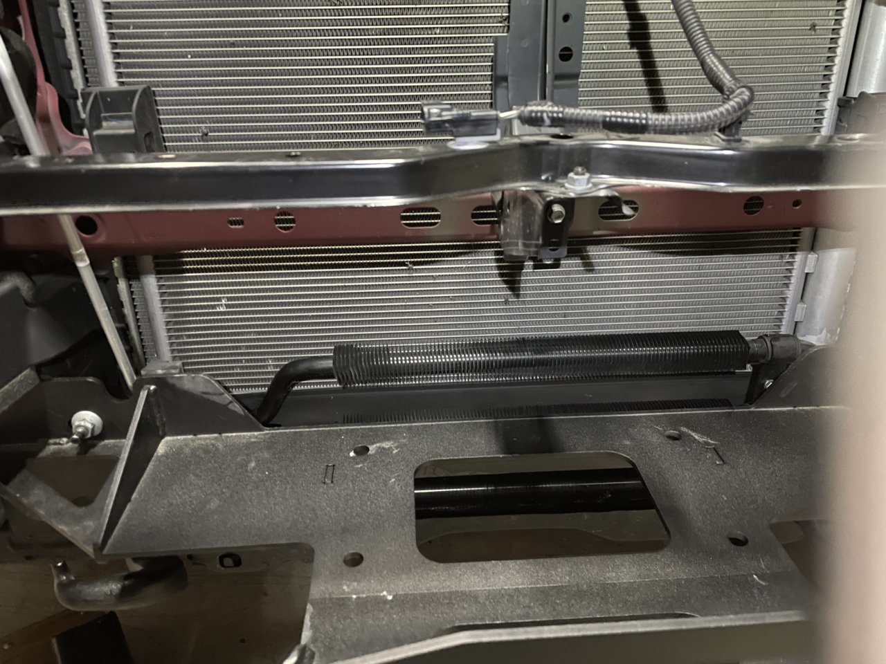

    post by another member on the issues with the RRW mount.

    The relocation brackets were the ticket. Thanks y’all! RRW did include them, but no directions or what they were for. Had it not been for this message board I’d never had figured it out.

    Did the power steering cooler relocation bracket you used come with your hidden winch mount as a kit from Torque? Or did you purchase that separately from US Offroad? The bracket only kit from US Offroad is out of stock currently.

    Ordered them separately.

    For others that may find themselves in need of a power steering cooler relocation kit, I sourced one from BAMF. As always, Jerry is the man.
