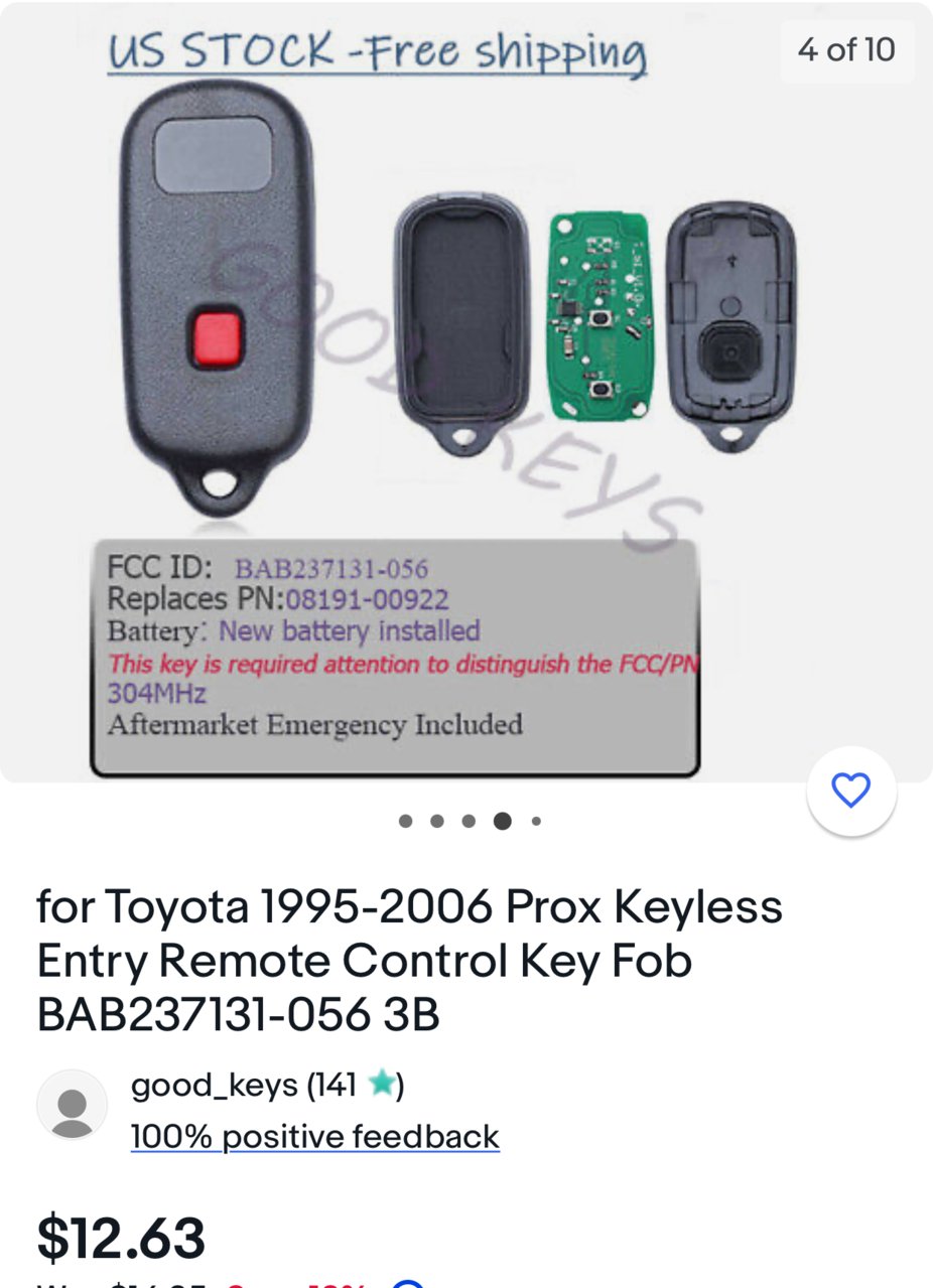

    I got this remote..
    which says it supposedly replaces the model number you got at toyota.. all seemed legit and like it should have worked. Even had the seller message me back and forth trying to get it to work but nada.. returning it now but thinking im gonna get the one with the toyota logo on the keyfob with that specific pn and see what happens then.. i just gotta find one with free returns.. lol. Heres to crossing my fingers n toes….

    The only numbers left on the re3200 that i have are:
    89730-yy140
    237000-3121
    both of which only come up with maybe one of the same units for sale but nothing with a keyfob.. not too sure on how to match the fcc id’s other than going on fcc.gov and doing a search but that usually only says what the device is and what frequency it transmits or receives based on what module the fcc id comes back to. The frequency had to have been right to communicate with the rs3200 but they all emit a certain bit signature in pulses that corresponds with the rs3200’s protocol preprogrammed per unit and will save this sequence when you show it a remote with one it likes when its in programming mode.. finding a remote that is its match is the part that i dont know how to find other than trial and error.. theres a possibility i go buy one from the dealer and that one not work.. guess im just gonna keep trying though until i get it as havent lost any money over it yet.. just time and patience.. lol
