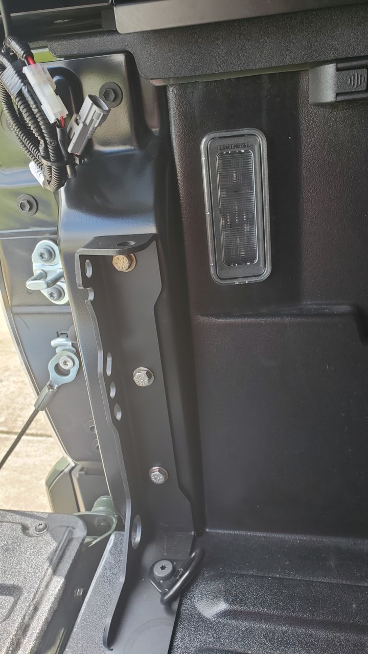

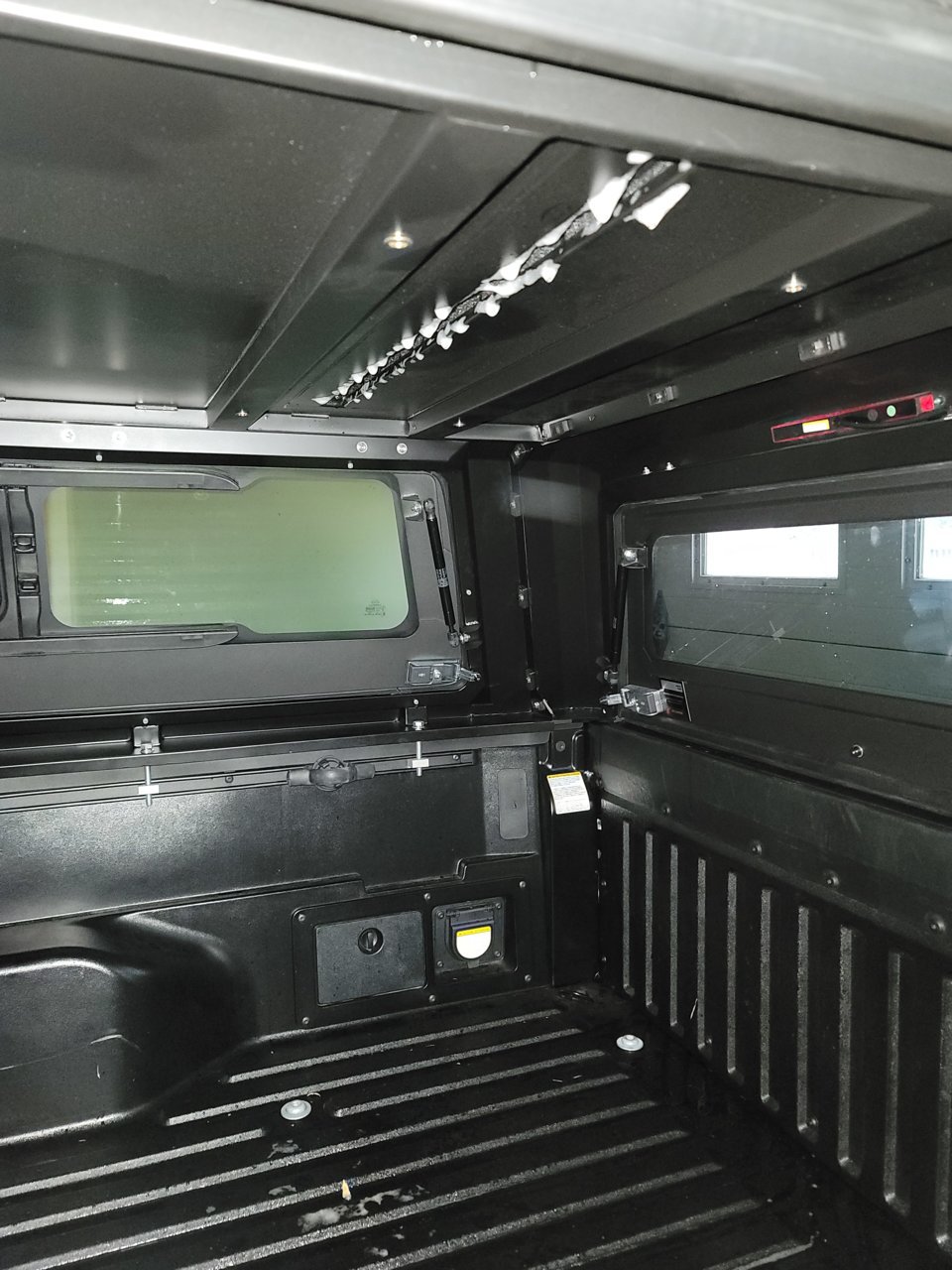

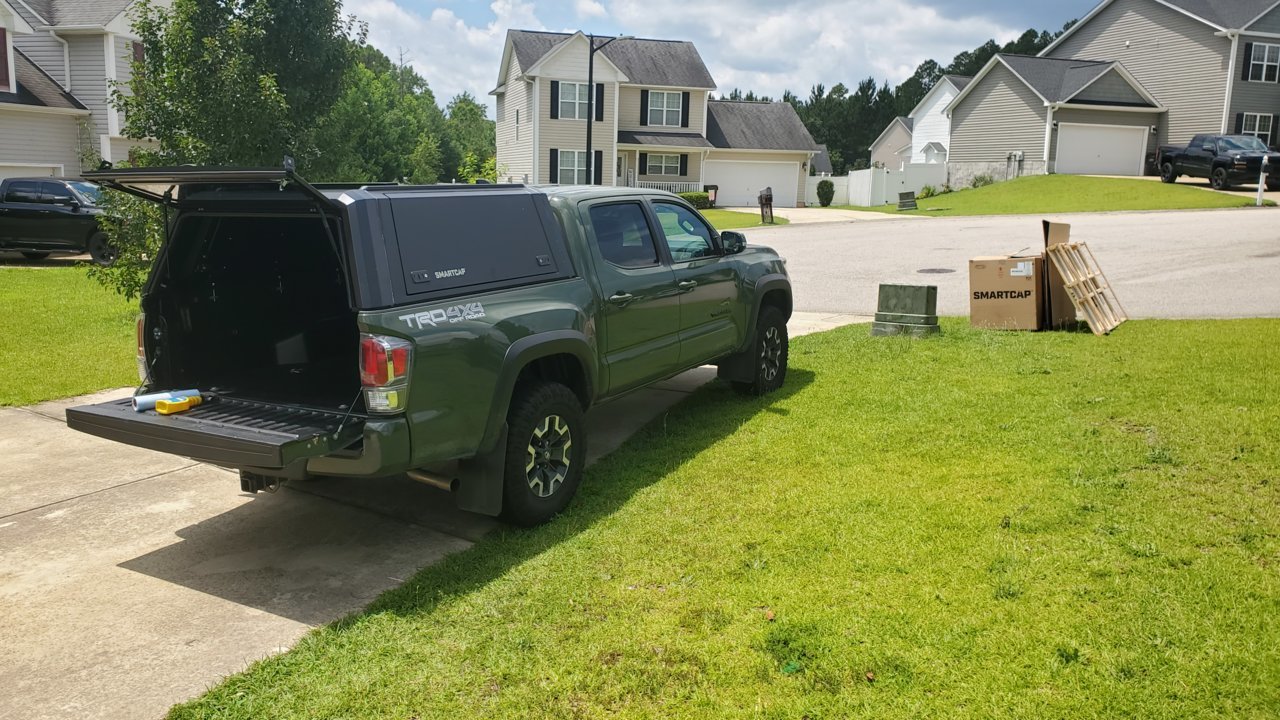

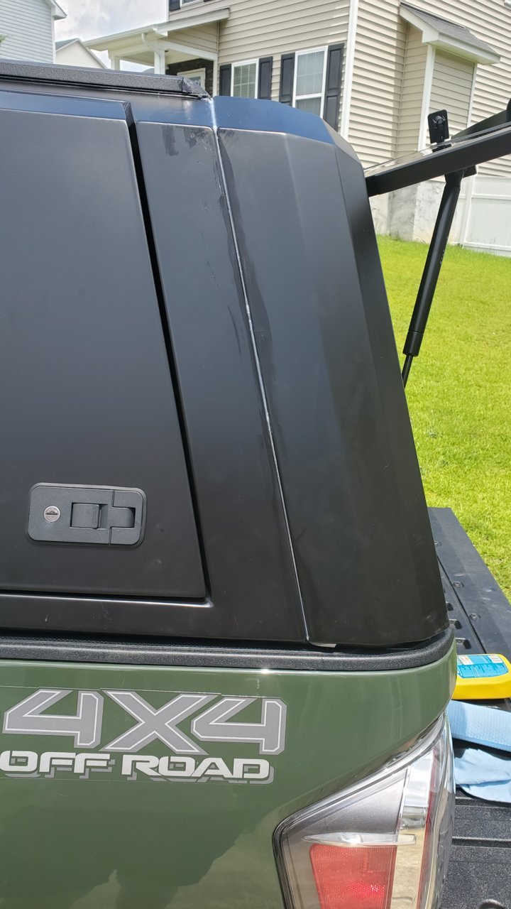

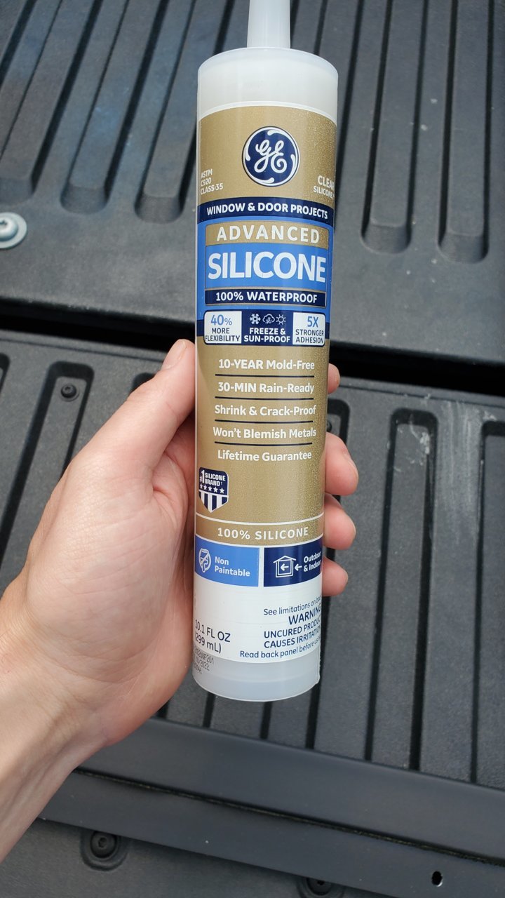

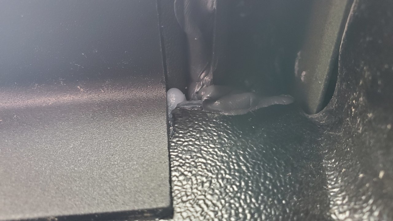

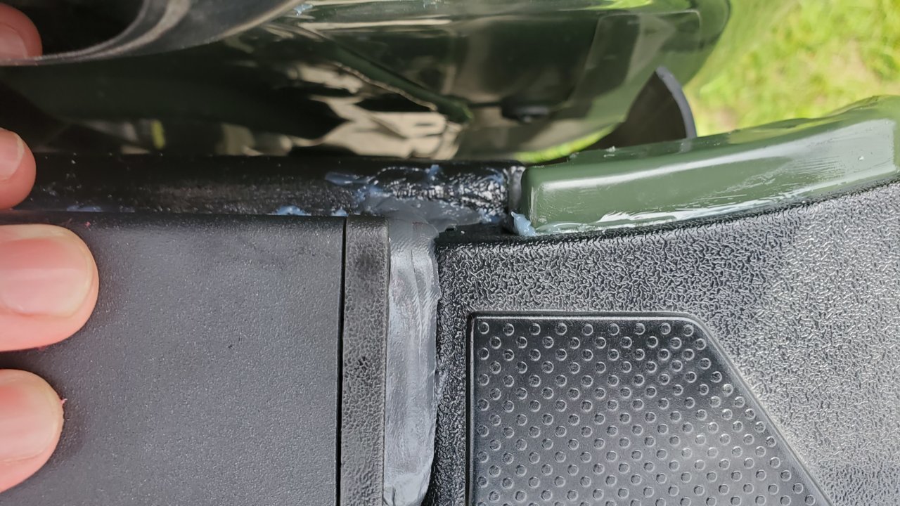

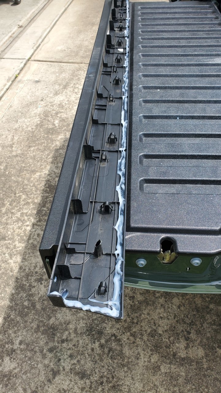

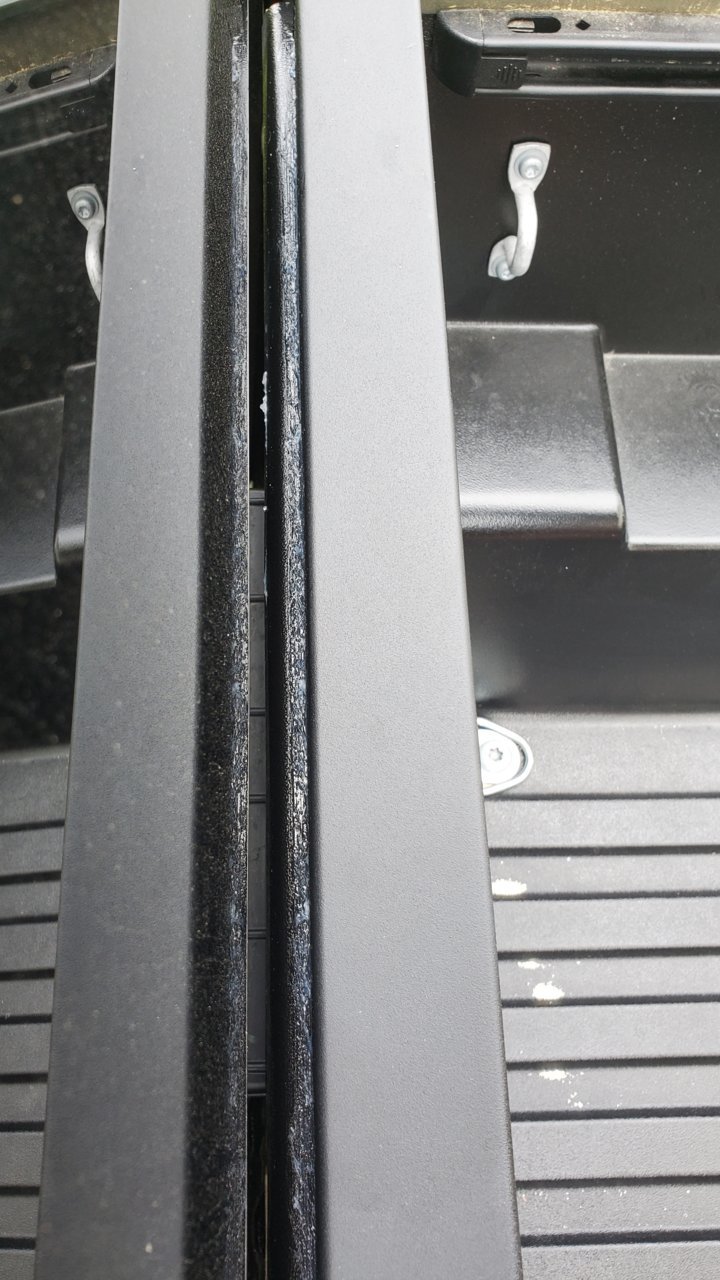

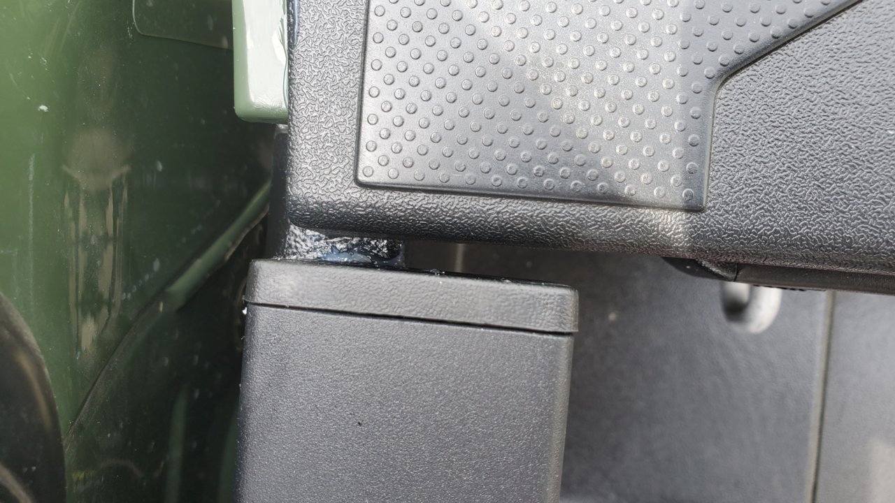

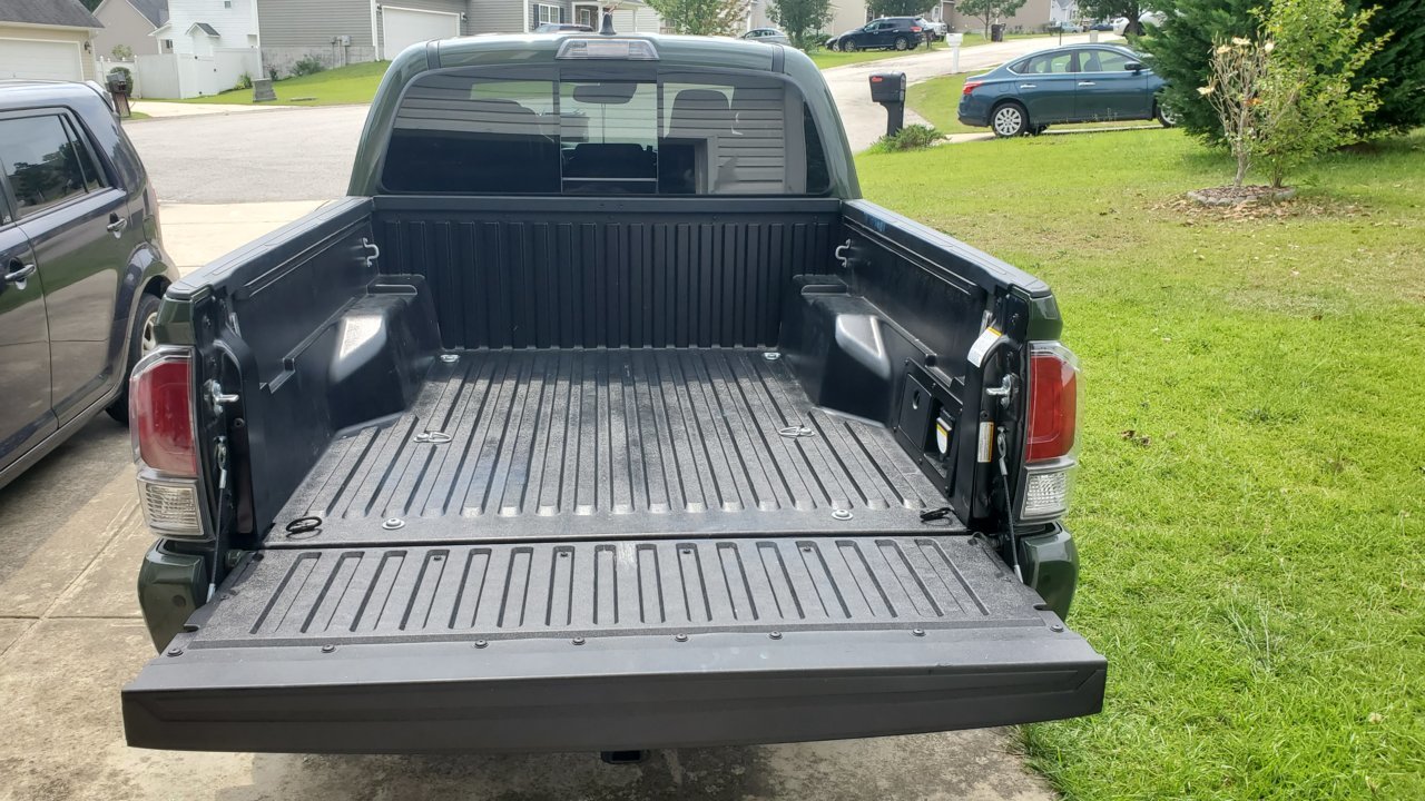

    So I got my smartcap earlier in the week. But didn't have the time to assemble until today. A few weeks back I went ahead and seal off holes around the truck with butyl tape to prep for the cap arriving. I also bought some silicone to put under the bed rails and at the front of the bed under the support rail.
    I cleaned the body and bed rails with rubbing alcohol before putting down the silicone. This stuff started to dry quick so work quickly. Once I placed the bead I put the rail back on the body.
    Once they were back on the truck I started shoving butly tape in the corners of the bed where I could see light.

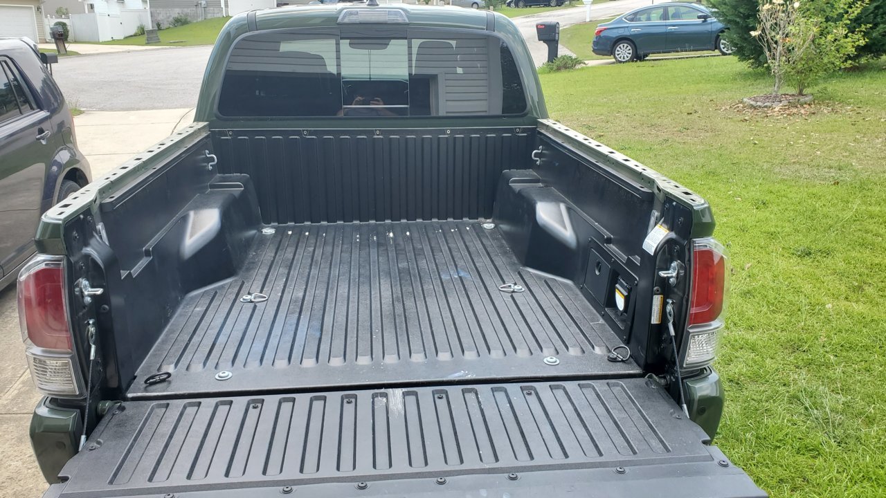

    I started to put the cap together this morning. Fairly straight forward, I didn't take any assembly photos as the RSI video pretty much covers it. I'll add that the instructions need to be updated. They call for a 10 & 13mm socket/wrench but I never used a 13mm but did need a 17mm for the bolts holding the cap in place.
    I would also suggest having a rubber mallet near by to love tap the side panels into place. I am also not a fan of the solution to attached the front and rear panel to the roof/sides. You will most definitely need a wrench to pull the caps out as almost none of the were finder tight. I would prefer if they didn't come pre-installed and just came in a bag. It would easily save 20min during assembly
    Once i got the cap installed I put a bead on silicone on the outside seams.
    Overall a fairly straight forward process. Should have at least two people. To assemble and install. The locks seem fairly cheap so I keep a lookout for RSIs solution in the future.

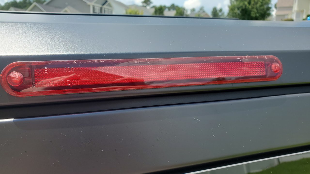

    I can't seem to find a official solution anywhere, but the instructions for the third brake light want you to put the wiring harness through the bed light hole. But I am unable to do that because I have the bed lights installed. Does anyone have an idea, something that would ideally keep a nice appearance?

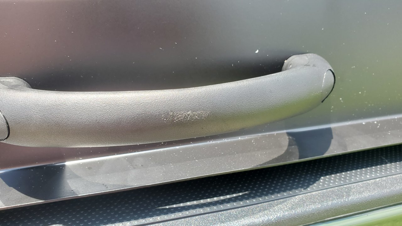

    And lastly my handle and third brake light came a little scuffed up. Going to find out if I can get replacements. It doesn't exactly bother me but on a nearly $3500 product I would expect better.
    I will also be buying some edge trim for the lip on the rear panel. I can see how that will get annoying or hurt.
    Thanks to @OffroadAlliance.com for the great customer service during these shipping issues.
    I am supposed to be getting rain most of tomorrow so I should be able to update on how watertight it is.
    EDIT: Had some heavy rain last night, woke up this morning and the bed was mostly dry except for a couple drips in the corners near the front of the bed. I drove to work and checked again and now there is a good bit of water. I am having trouble finding the source. I know that its coming from the corners but I can't seem to figure out exactly where.
    Did anyone else encounter a similar issue?

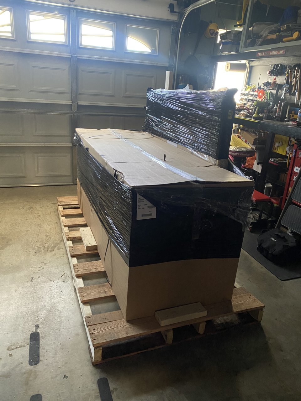

    It’s finally here!!! Big thanks to @OffroadAlliance.com for the great customer service during the entire process.
