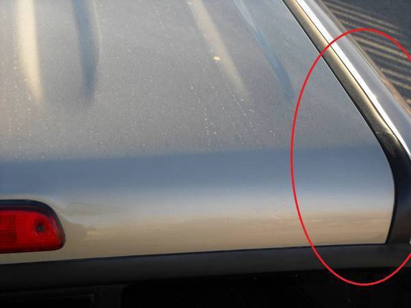

    Does anyone know the part number for the rubber moulding that runs the length of the roof? I think someone stole mine. One day the passengers side moulding was missing. I am not sure if its 1 piece (on a Double Cab), but its missing from the windshield all the way to the back window. Also, where would be the best place to buy a new one?
    Here is a picture of the piece that is missing.

    it is one piece. mine got ripped off in a carwash once :eek:

    mine tore at the lil rubber clips. i used some strong construction adhesive i had kicking around (pl premium), glued the pieces and used tape to hold them together over night.
    when i installed them back on i used 3m double sided tape on both sides of the rubber clips
    damn thing wont budge now :D

    75551-04060 Roof Drip Side Finish Molding, RH
    Here's one source: http://www.trademotion.com/partlocator/index.cfm?action=searchCatalogOEM&siteid=215498
    May need 2 clips (75561-02020, pkg of 4) for it if they are no longer in the channel. Here's a .pdf page from the shop repair manual giving details of installation:
    http://www.customtacos.com/tech/fil...6toyrm/06toypdf/06rmsrc/rm2006ta/06300610.pdf

    They're called "drip rails" and for some reason, the clips that Toyota uses for them SUCK, and they all come off pretty easily. I doubt it was stolen. Likely a carwash, or high-speed driving. They honestly come off that easily.
