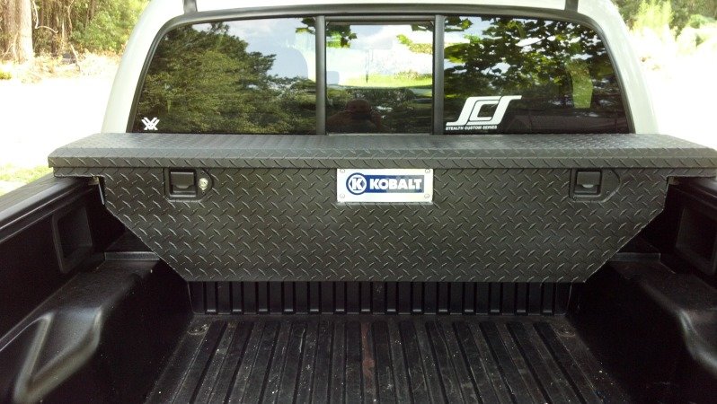

    I wanted a black tool box , but not the black box price:eek:
    Anyways I purchased a Kobalt from Lowes a few weeks ago and decided to see if this product is what it is ....
    "Outlast Rubber coating"

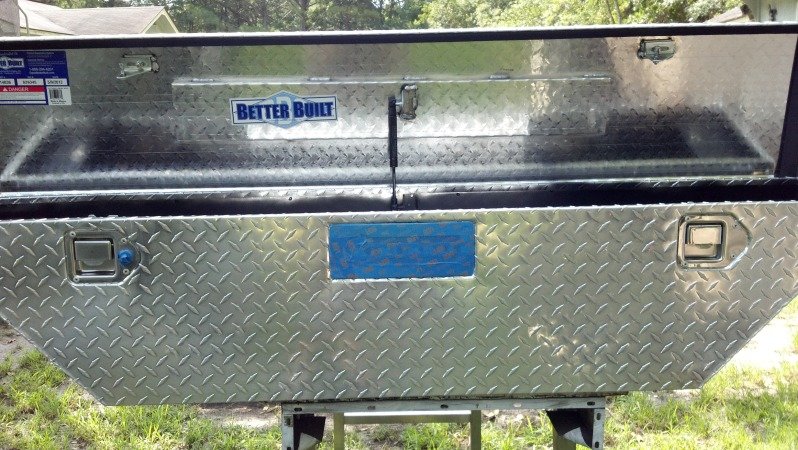

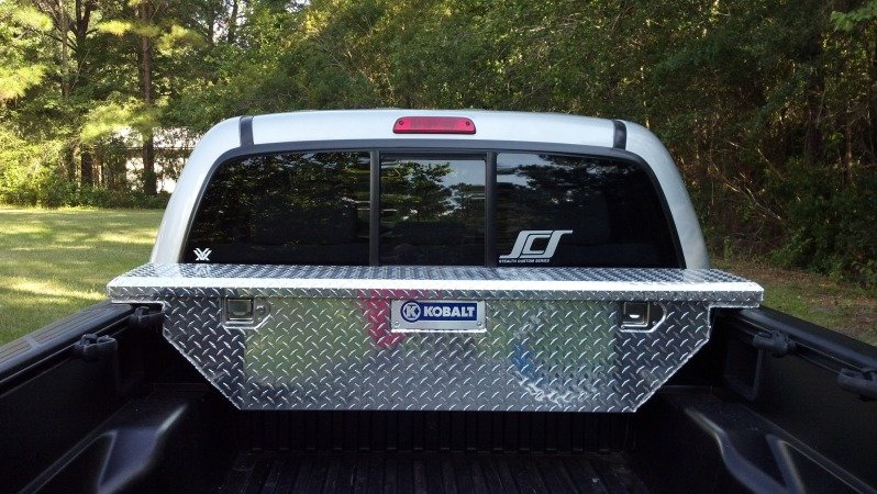

    Original

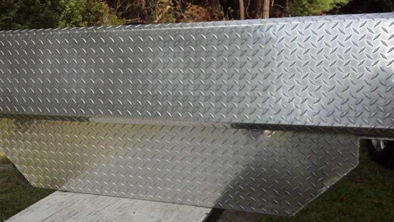

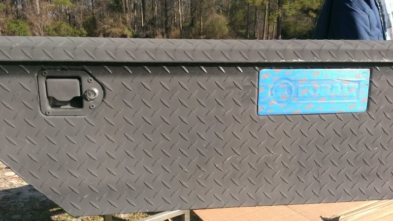

    Scuffed with Scotchbrite
    Taped off

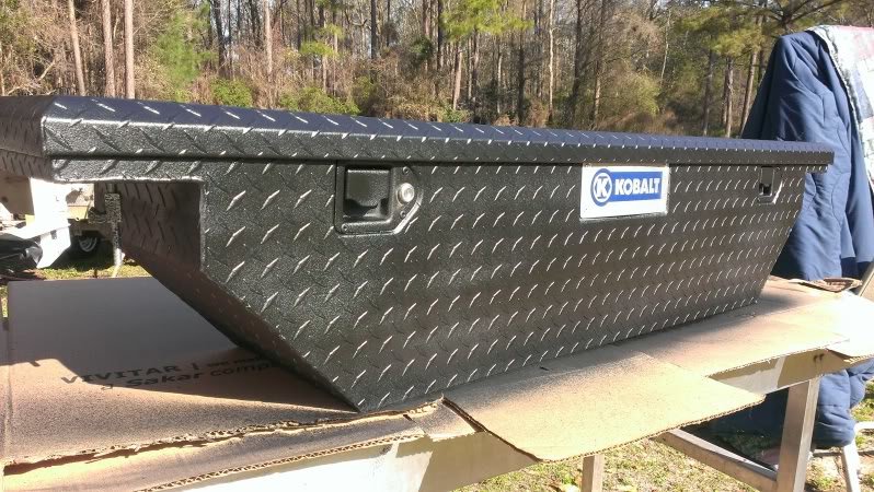

    Sprayed with 2 cans

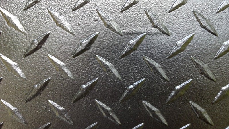

    Closeup on finish
    Finished product...Dried to touch in about 1 hour 98 degrees
    I will probably apply another coat when I get more and post how it holds up.
    I did not use a self etching primer due to the product states it adheres to aluminum well. We will see.:cool:

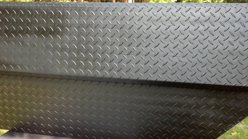

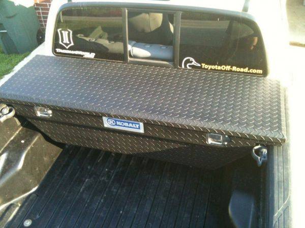

    Ok, since July last year in the sun and South Georgia weather and a newer truck I finally got around to spraying my box again and my report. Pics speak for themselves. I am happy with how it has stayed adhered and not flaked off....
    Dried...
  14. Mar 9, 2013 at 4:30 PM
    lowcountrytj
    lowcountrytj [OP] Third Member
    Jun 25, 2012
    #81325
    1,585
    Phillip
    Probably at Work
    2012 DCLB TRD SPORT "BLACKOUT"

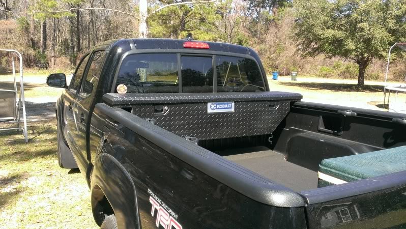

    After 24 hour's after re-spraying it really looks good. This stuff really adhered well in the beginning. It never peeled or flaked. It did fade which is to be expected ...It takes a severe beating in the sun and weather around here. I am impressed.
