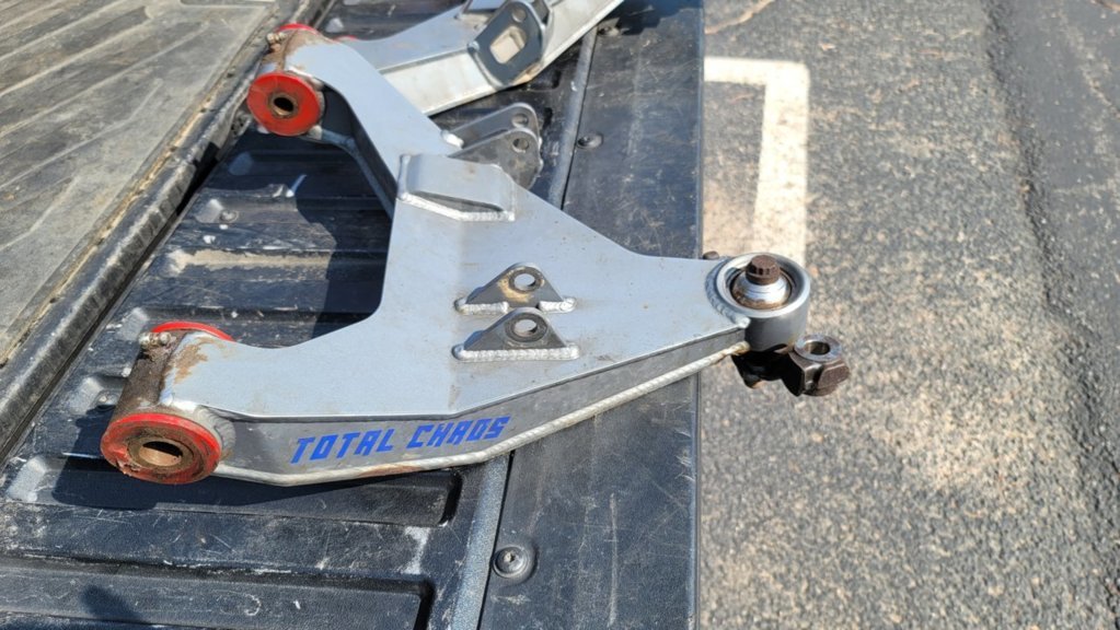

    Total Chaos Lower control arm will solve the rubbing.
    I had 33s on SCS F5s with -25 offset 3.5 BS and spacers.
    Slapped the lowers on, no more rubbing. The tab mount I cut was useless, the firewall smashing and inner fender cutting was useless

  16. Mar 17, 2021 at 7:44 AM

    I know what the new ones cost:) these are the older version. I had them on this, mix of 33s and 35s, F5s and Beadlocks
    They are worth what they cost (even the new ones)
    They help with the alignment, they are beef, have better ground clearance, and serviceable
    Long term vs short term:notsure:
