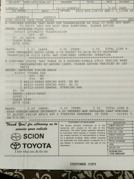

    Update 9/28/16
    Truck is completely fixed now, no more rumble strip. There is no public released TSB, but internally, field techs do have a TSB. Both leave springs were replaced and a steering damper was added.
    Updated part numbers:
    48210-04840 Spring Assy, RR RH
    48220-04480 Spring Assy, RR LH
    45713-35040 Damper, Steering SHA
    So long story short, I've had my issues w/my truck. Had several things done and been really happy with service. Dropped the truck off for the rumble strip confirmation (for the 3rd time all documented) and a possible fix that's available according to the new service manager.
    Received a phone call today saying they are replacing the leafs w/new updated part numbers and a steering damper, so that is awesome. I'll post TSB info when I get it and try to get the number to post. Last time I posted info like this for the trans flash, I got flamed for not having the number, but oh well, believe me or not, that's your choice.
    On the ride along he noticed the odd shift flaring while the truck was cold I've had post-TSB and said they would look at that since it was in the shop. Well, under the former service manager, I was told the fluid was checked and 1/2 quart low when the TSB was performed. Today, the new service manager called and said it was a quart and a half low, which is what caused the severe flaring Post-TSB and is now fixed. What a hell of a deal, lol. I even have it documented that it was manually checked and fluid was added when the TSB was done. Bahaha....finally progress I guess :)

    Current info updated. Truck is now rumble strip free and has correct pinion angle.

    I had the exact same repair done to my truck. It made an obvious improvement but did not completely fix the problem for me. The service department agrees that it is still there but Toyota Corp. calls it characteristic of the vehicle.

    No other problems, just the vibration. These do look much different, especially the overload part of the spring. I think they are trying the 2 birds 1 stone theory of trying to address the noise as well.......unless these start squeaking. It does ride a little different, maybe not as stiff in the rear, but that could all be in my head.

    Mine happened every time I slowed. 2.5 degrees out of spec is pretty big. Yours may not be out as far, which is why it's harder to make it happen. I could drive 15 mph with the cruise on and it would do it the entire time, so it's not just on decel. That's when it's noticed most since we don't tool along at that speed often.

    Information moment: These are the leaf springs that trucks produced from June, 2016 use (firm ride). The steering shake damper is sourced from a 2010-2016 4Runner.
