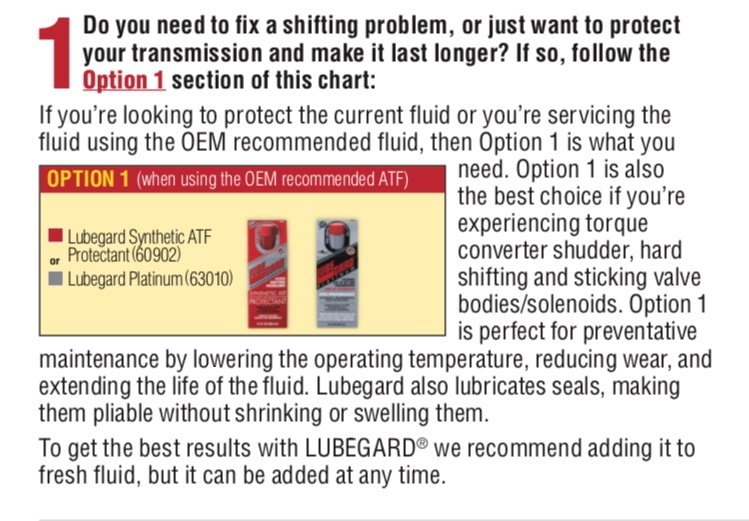

    2572FC26-E3D8-4C4A-B8D0-0CF4EA856D62.jpg 0D87F7E1-2B1F-456F-91BF-15CBD5F2E2F3.jpg
    Lubegard Red, Platinum or Instant Shutter Fix.

    ^^^ That'll do it. Very well known problem and many threads on this issue in the 4Runner forums. Fluid change and Shudder Fix and it's been gone for 2 years. It's a converter lockup problem. Do a test - put it 4th rather than "D" and go for a drive. Tell us if it goes away.
