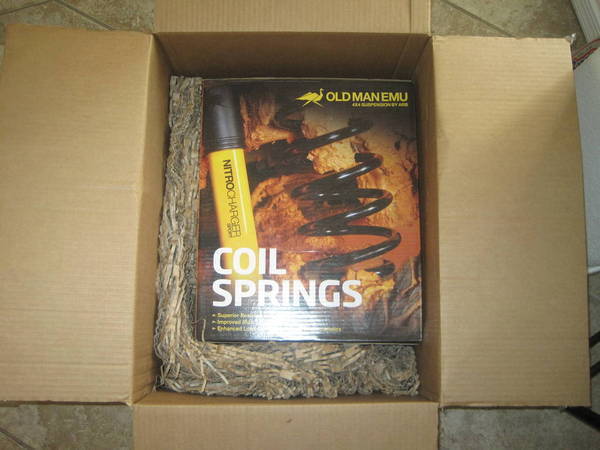

    I talked with the guys from OME and they will send me a new pare of 886 . I'm currios if they will send me the new 886X.

    All the new stock is the "x" version , so that is probably what you will get I would think

    I got my new 886X. I love them , I'm sitting higher that with the 886. Where nice ride also.

    I am DC, SB . I have bumper,winch and skid plate. I'm not sure what's my high from stock but I'm sitting 1/2" higher that regular 886. They can handel the weight better and the ride is very nice offroad. On the road I have some vibrations at 60-65 mph.
