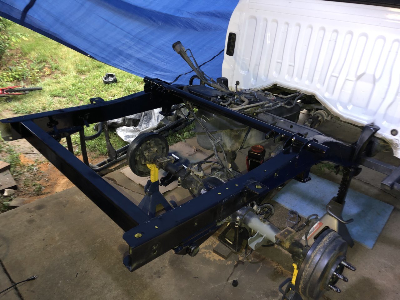

    Desperate times call for desperate measures.

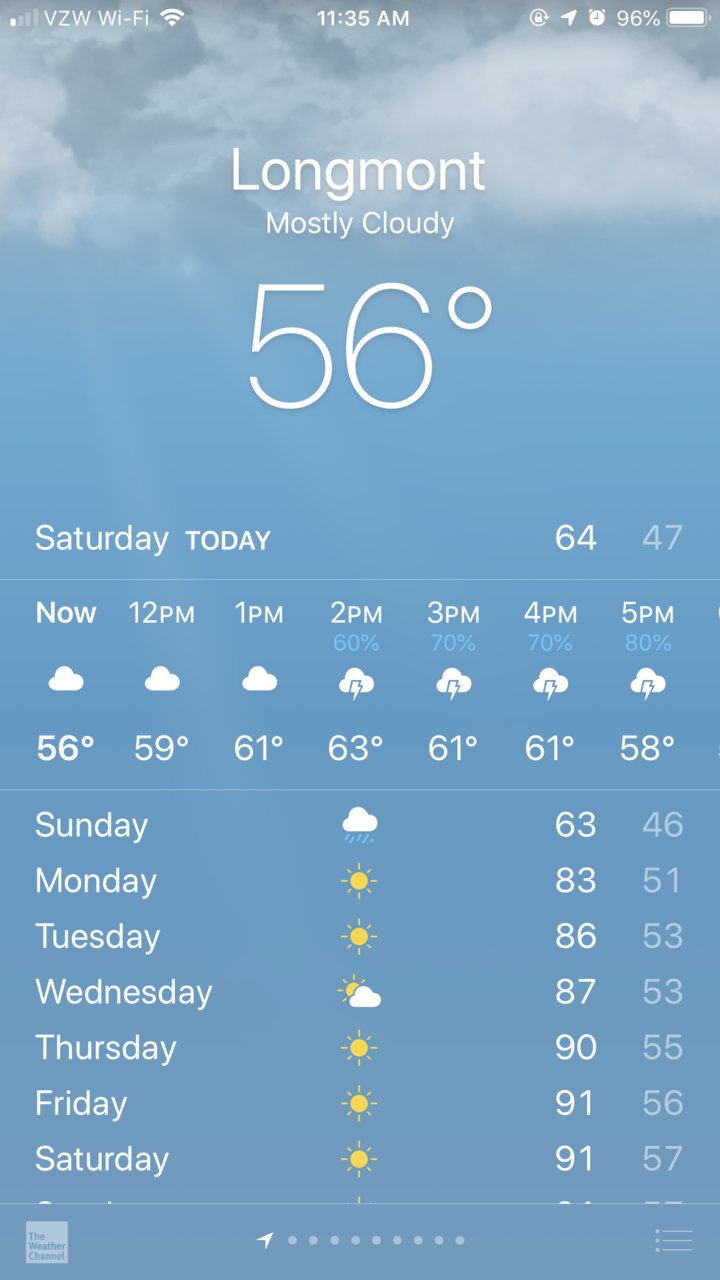

    I would kill for that weather. Currently over 100 and not looking forward to going in the garage

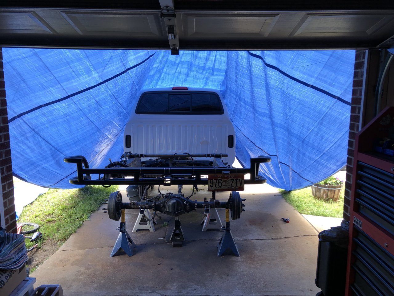

    I’m stuck working in the driveway, and we’ve had a series of storms rolling through for almost a week straight. It made the welding take twice as long as it probably should have.
    But I know those feels about the heat. I grew up in St. George and it was hot as shit in the summer.

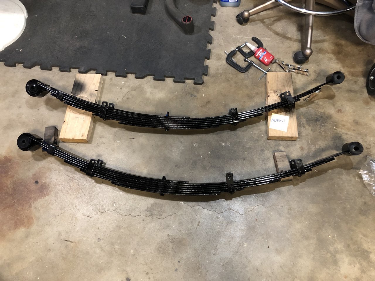

    Leaf packs are cleaned up, hit with dry moly lube on the friction surfaces, reassembled, and painted.

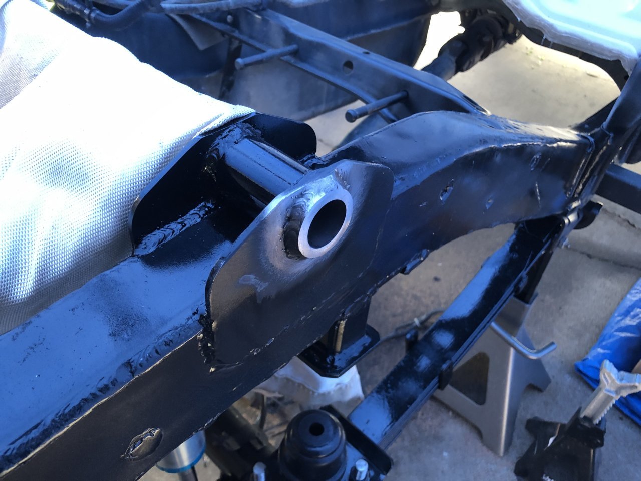

    Why does the upper shock tube poke out past the frame?? you're gonna hit that shit with your tires..

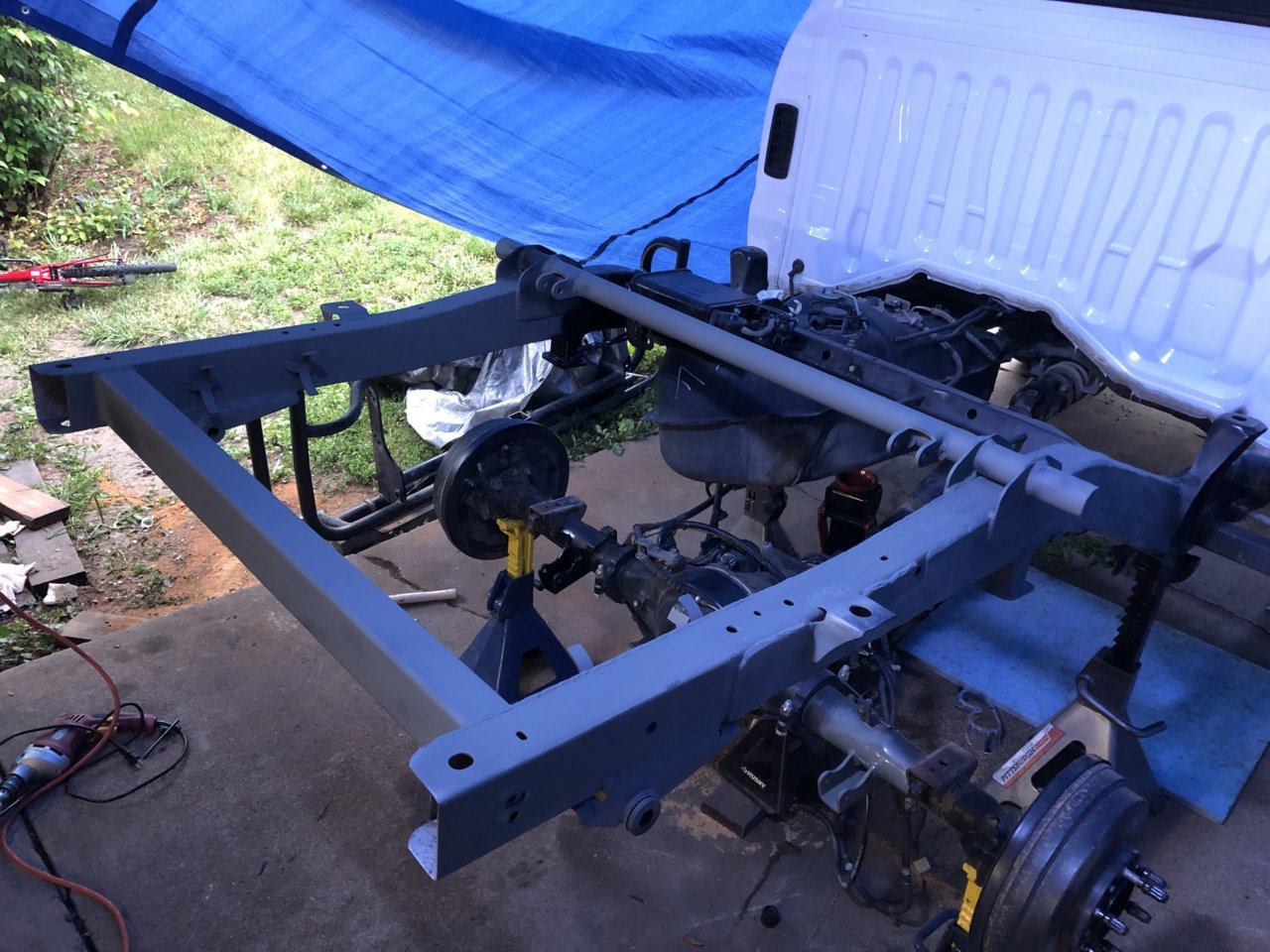

    Got a little bit further after a long day yesterday.
    I still need to bleed the brakes, but the new proportioning valve is in and the old bypass line has been pulled. Some strain relief for the valve is definitely in order, but I’m fairly happy with the results. Huge thanks to @Deathbysnusnu for his write up. It made life so much easier.
    Since the frame is now boxed, I had to drill and tap a couple holes to mount up the stock rear brake line bracket. I’d like the bends to be a little cleaner, but it is what it is at this point. I can’t believe how much less cluttered it is back there with out the LSPV/BV shit in the way.
    While I really wanted to get the new exhaust system in, I had to reuse the old one out of expediency. After immediately blowing through the shitty old metal on the muffler, I got the hang of things and got my super sweet custom exhaust tip welded on. Some new fasteners and a gasket from the dealer, and the whole thing was bolted back up, no problem.

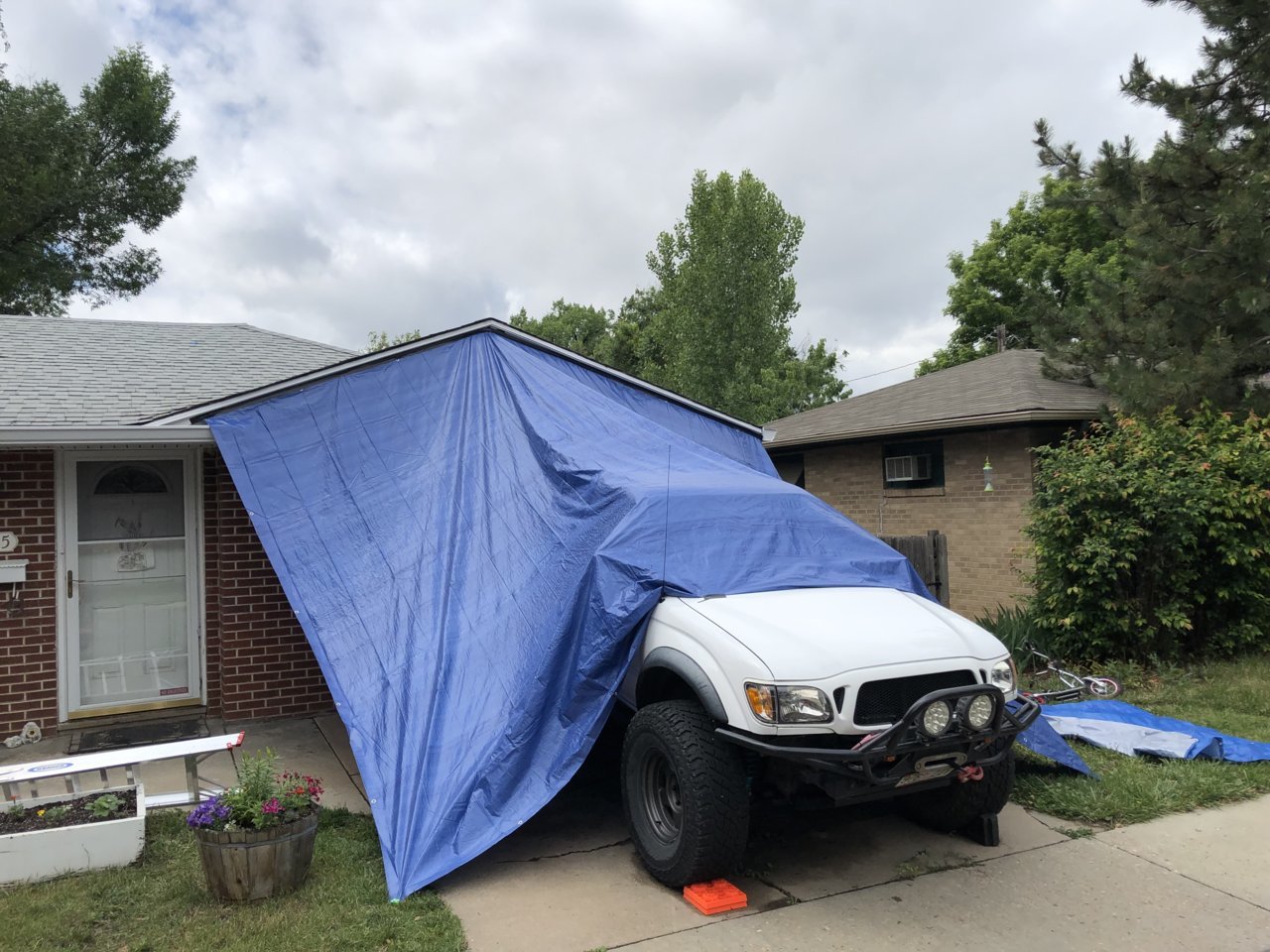

    This is a shitty pic, but we were still getting hammered with rain, so I had to take it with the tarp on the truck, but here is the finished product, basically. I made some super lame e-brake extendo brackets that probably fucked up the e-brake adjustment, but hey, at least the cable are hooked up to the bellcranks now. I also made a little spacer for the bracket that holds the e-locker harness. It wasn’t too tight at full droop, but it was enough to make me nervous, so I spaced it up. Much better.
    At this point, I just need to bleed the brakes and set the new BPV, and then I’m ready to put the bed back on. I guess it’s probably a good idea to change the diff gear oil since it saw some heat from welding on the lower mounts, but I really don’t want to because I’m over all of it at this point.
