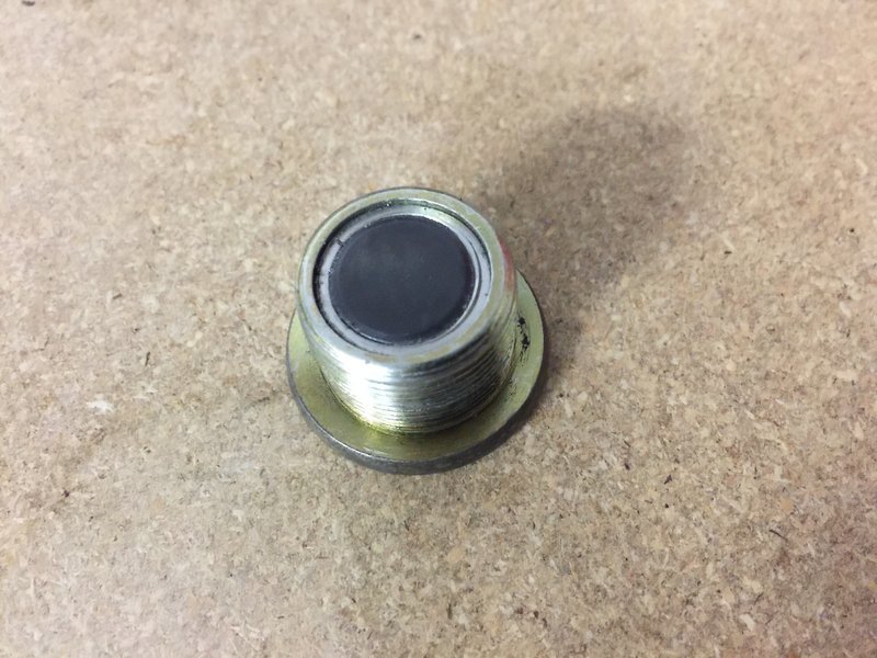

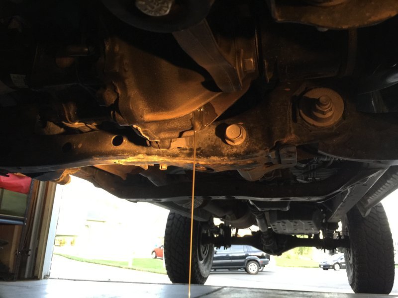

    Last night was focused on pulling the temporarily mounted skids to gain access to all of the various drain and fill plugs. Pretty straightforward stuff. Once the skids were out of the way, I pulled the front diff fill plug and then started to pull the drain plug. When I did, I damn near stripped the Allen key on the plug when I got sloppy with the ratchet. Thankfully, I felt it going, and I repositioned and things were good. I believe I'll be buying a new drain plug to have on hand for the next oil change...

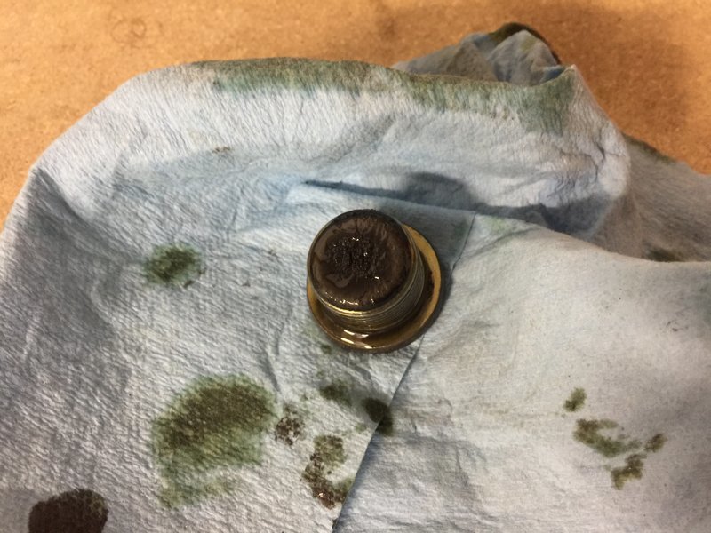

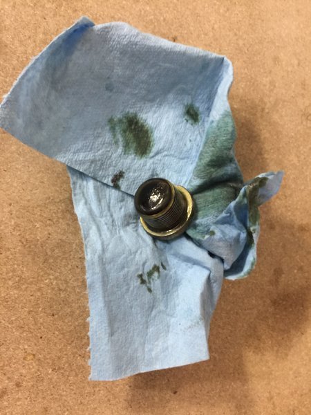

    Anyway, the gear oil looked exactly as expected; grayish, not black or gold, and with a fair amount of very fine metal content. The following pics are terrible, but that just means I need to save for a decent DSLR ;)
    The drain plug had about as much metal filing build up as the rear did after its break in. Again, no big metal fragments, just fine particles. Here are a couple more mediocre shots of the drain plug right out of the diff, and after blotting away some of the oil to reveal the particle build up.
    This is what the plug looks like when it's clean.
    After cleaning up the drain plug, I very carefully reinstalled it and torqued it to 48 ft-lb, using an H10 socket (10mm Allen). Then it was time to hook up the fluid pump to a fresh bottle of Lucas 85W-140 and start pumping. Just like last time, it took just under a quart before dripping out of the filler hole. I'll top it off again after a few days. I torqued the filler plug to 29 ft-lb, again using the H10 socket, wiped off the diff, and moved on to the LBJ bolts.

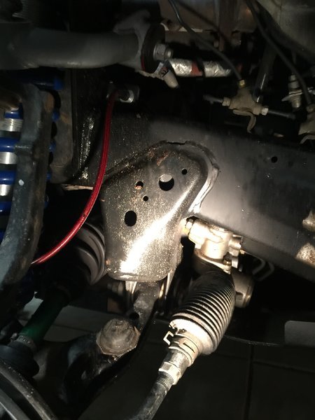

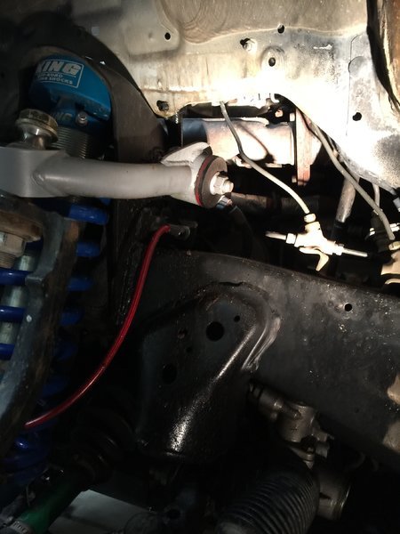

    So today I wanted to get my UCAs lubed up as part of an effort to chase down some squeaks. Turns out that that is not a terribly hard job, but it's definitely messy. But the real treat was what I discovered while I was getting set up.
    As I was breaking loose the lugs on the driver side, I noticed a film of oily junk on the inside of the fender well. My first thought was that the CV boot had split and spewed grease everywhere, but upon further inspection, it looked more like a fluid. It was only present from the coil bucket aft, and it was present above the frame on the aft side of the bucket itself. Turns out that the two breathers for (I believe) the front diff and the transmission are located right there, and the aft breather was definitely wet. So my best guess is that the breather spewed fluid which then coated everything behind it and left a small pool on the transmission skid.
    Here are some terrible pics, since it was after dark. I'll try to shoot a few tomorrow and replace these.
    Anyway, I'm gonna hit up the big brains in the 1st Gen thread to see what they think. I'm not sure if it's really the breather freaking out, and if it even is, why it's doing that.

    Those lines are off the front diff. You probably overfilled it and it burped out. Clean up the mess, check that there is still fluid in the diff and don't worry about it too much.

    I'm almost positive I over filled it, and then proceeded to do a bunch of interstate driving, as well as some high speed stuff in 4H.
    I'm gonna do exactly like you said. Gotta pull my skids to clean up the damn mess, so I'll verify the fill and clean everything up and keep an eye on things.
