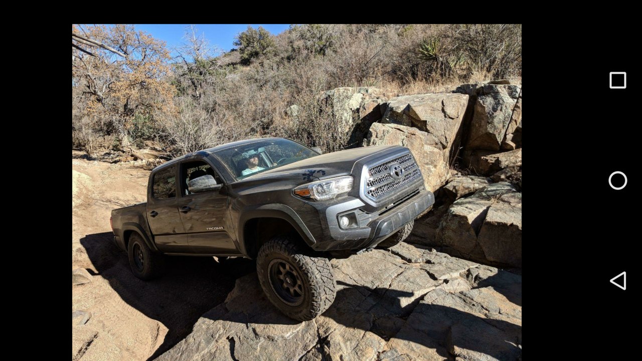

    I'm using fuel trophy wheels with 4.5" backspacing and 285/70/17 tires. Also have a cheap spacer lift (3" I believe) and have no can mount rubbing (no cmc). Only slightly rubbing on UCA at full turn and on plastic fender lining at full turn.
    I wheel my truck often and it works great!
