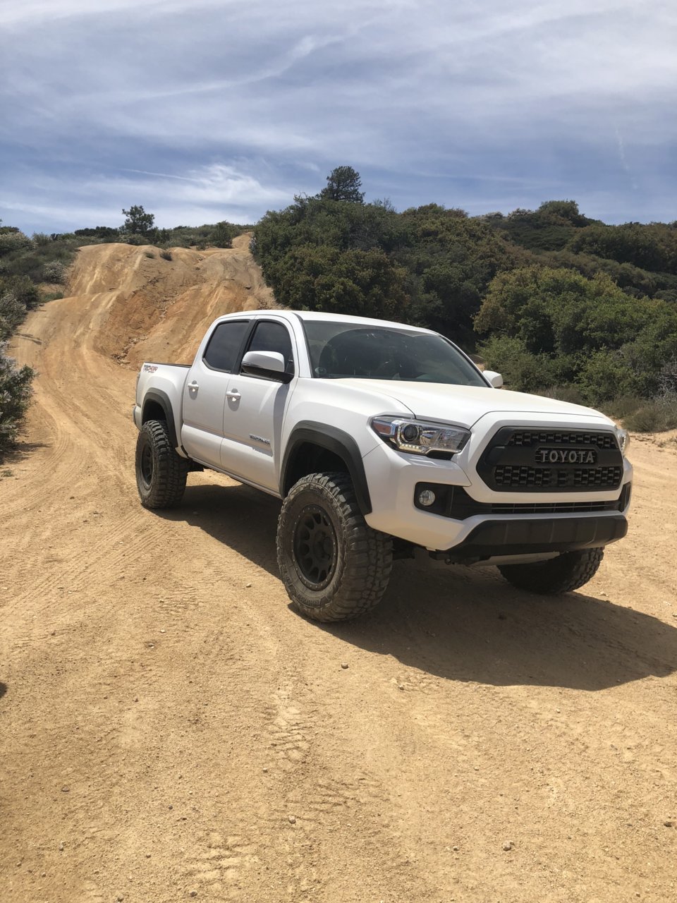

    5100s, 887s and no cmc on 285s. If I run spacers, I absolutely need a cmc. Don’t try and run some crazy low offset without it. I don’t have aftermarket UCAs either.
