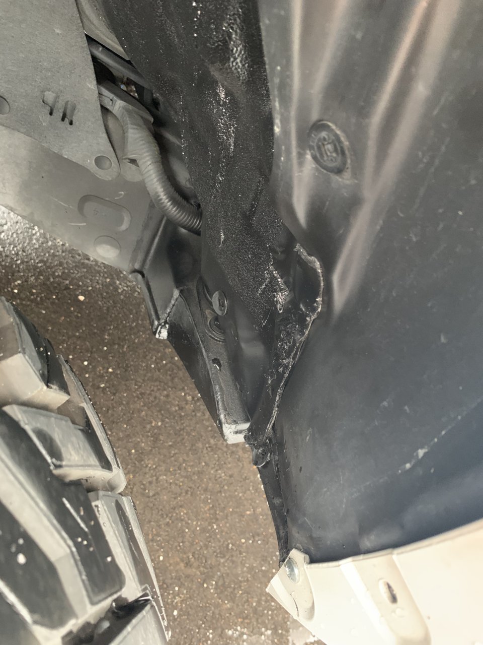

    Annnnd rubbing on the cab mount at close to full lock, especially reversing. At least I can drive on the street mostly. Alignment next, and will ask for 3.5-4 degrees caster since I have the JBA UCAs. Then next week is the CMC

    Lifted 2 1/2" installed the 285/75 16 tires and aligned it, did the CMC and still rub at full lock more so when turning into a drive way... I am preparing to do the pinch weld and probably trim the plastic. see how it goes..

    Was it a guess CMC? I'm going to have my guy stuff my tires with a forklift and measure how much to cut. Whats your wheel offset, including spacers?
