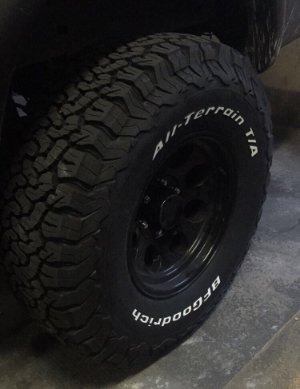

    LOL no I don't think so, I just moved to Nashville and fired a guy last night. There were also three skater punk kids that mischieviously ran away from the area of my truck but I didn't think anything of it till I walked to my truck and heard a hissing noise. Could have been either of them I guess. I was able to make the 3 mile drive back to my house just fine. The hole was just barely enough to do anything. My coworker's tire was also slashed in the same place and he had a rental.
    I ended up getting a KO2 installed on in this morning. Now I have to get a whole set. A little earlier than I was planning but apparently they discontinued the Rugged Terrain as of March which is a shame. Besides the fact that they held rocks like a somebitch, they were a really good tire. If anyone wants three Rugged Terrains with like 50% tread on them, let me know. I'm in the market for three KO2s now. :)
    Thankfully I added a warranty to this tire that covers me for tire slashing and there's no pro-rated tread BS, if it happens, they put a new tire completely for free as long as there is still useable tread.
    At least I have one sexy tire on my truck!
