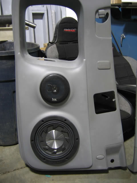

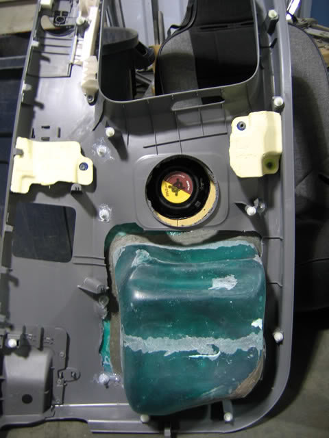

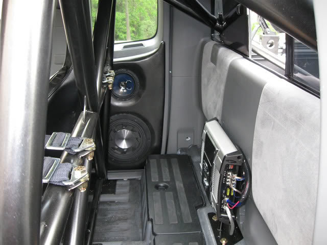

    I fed the rear speaker leads through a low-to-high impedance converter and then an RCA Y-splitter into a 4-channel amp. From there I ran the amplifier outputs back to the rear doors and into the speakers. It's all controlled from the stock head unit so I still have the steering wheel controls. I have an overhead switch to manually turn the amp on and off as I don't always need the bass.
    As for speaker placement, I hacked the hell out of a set of Xtreme Kreations sub boxes to make them work with my cage.
    Each panel has a sealed 1 cubic foot box for the 10" sub that slides into the slightly-modified door.
    As Xtreme Kreations meant for them to look:
    How they look in my truck after I free-hand jig-sawed the fiberglass, flipped the mounts, and re-glassed everything so the speakers were recessed instead of raised up:
    The panels don't rattle at all and the Pioneer subs hit hard.

    Oh yeah, I picked up power straight off a block I installed under the hood. It's essentially right off the battery, which isn't a bad thing if you're running crazy wattage.
    As for grounding, use massive gauge wire and a short run directly to the frame if you can. Engine noise through an amplifier is annoying as hell.
