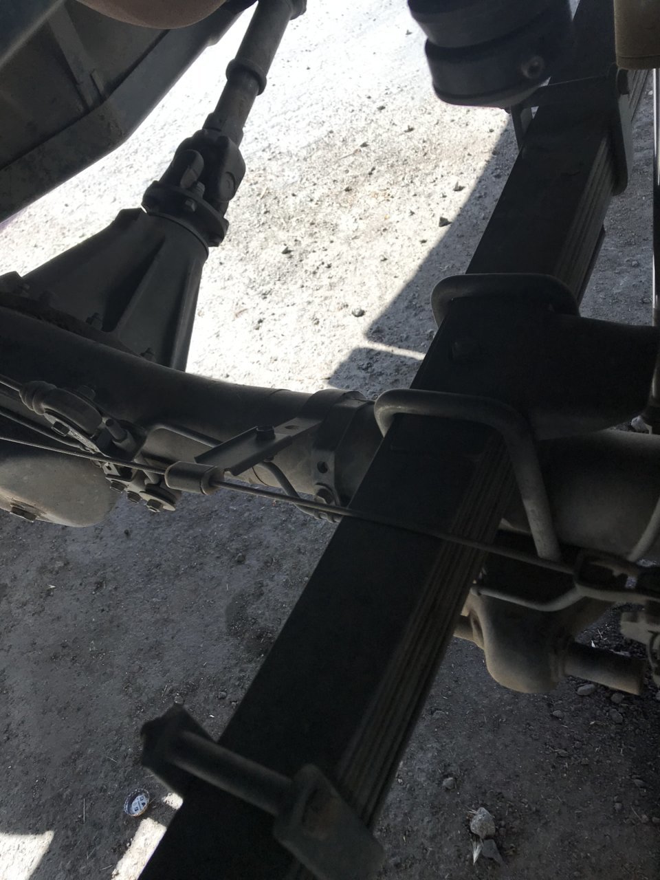

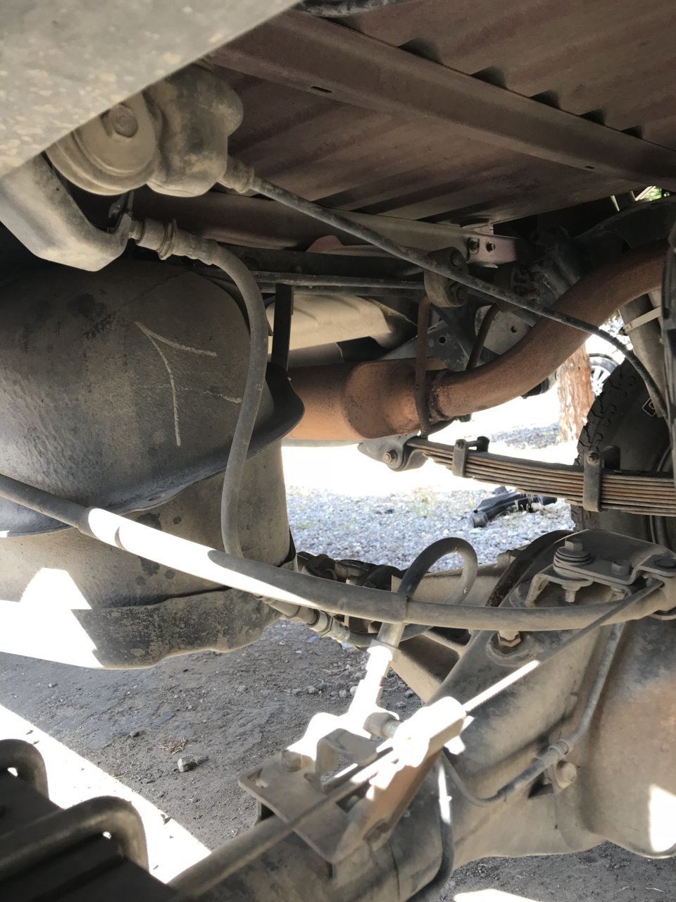

    Here’s a photo of my stock length lines together
    And here is the only issue (when on full droop) the springs pull on Emergency brake line so I have no emergency bakes when I go off roading (I disconnect) but daily use is all tits!
