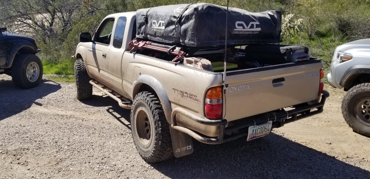

    No been a slacker. There holding weight pretty good so far.20200229_114324.jpg

    Man I just came back frome a 400+mile trip with that load it was pretty good the whole way. I didn't experience my truck jumping lanes. just jumping over cattle guards. I did have it hit the bumps on the big speed humps buy my house coming home but it think my shocks could have been pretty warm.
    I think when I get a tire carrier its gonna be a different story though.

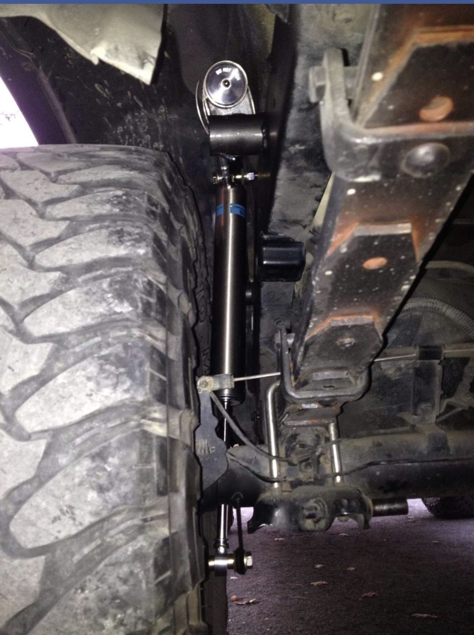

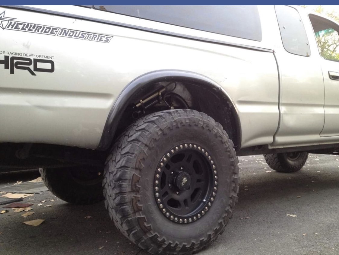

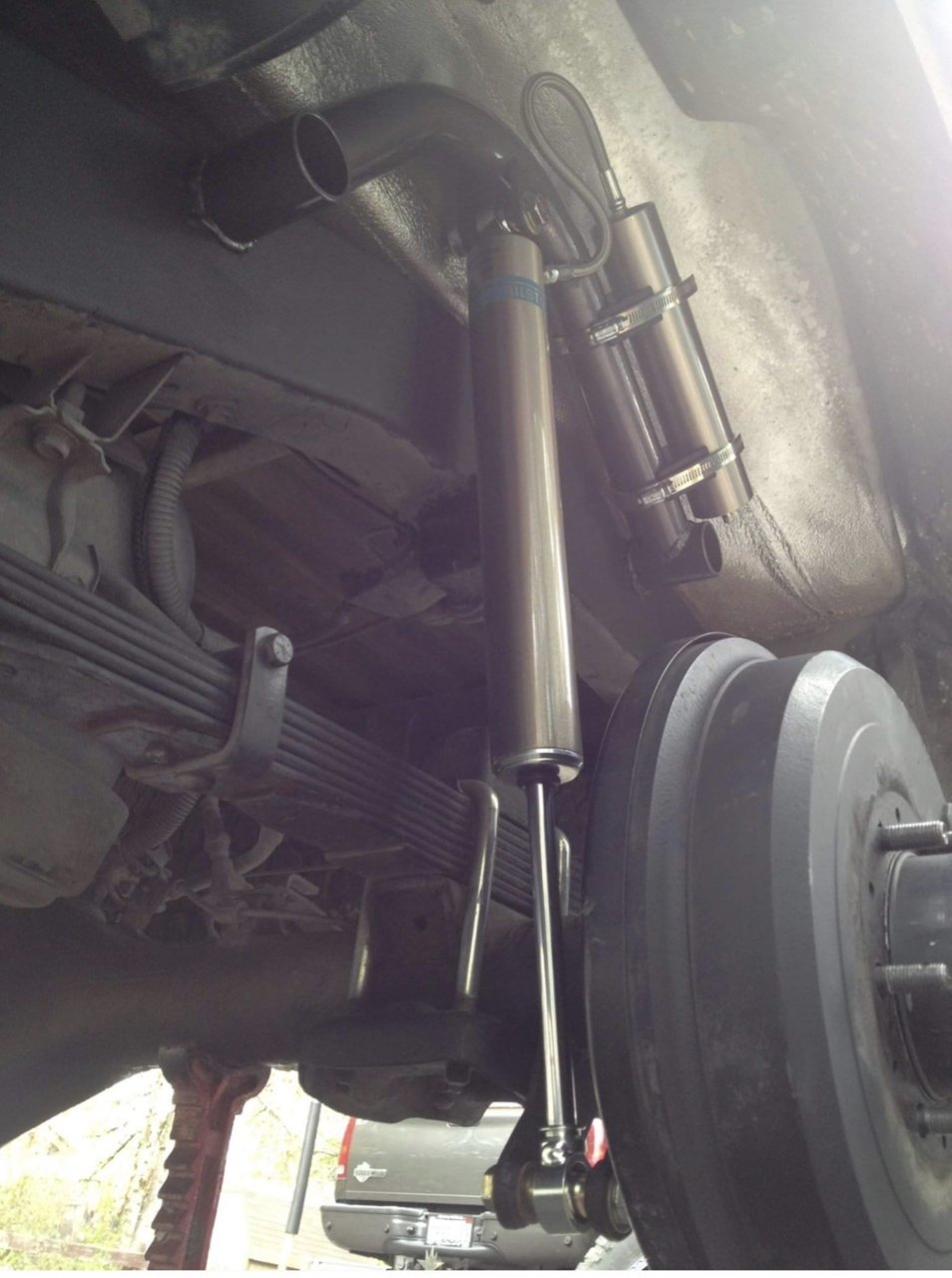

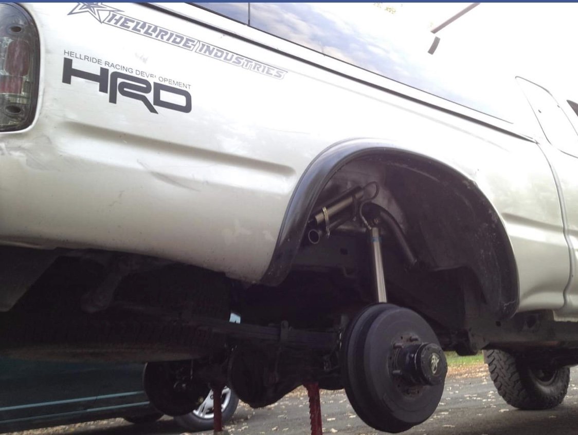

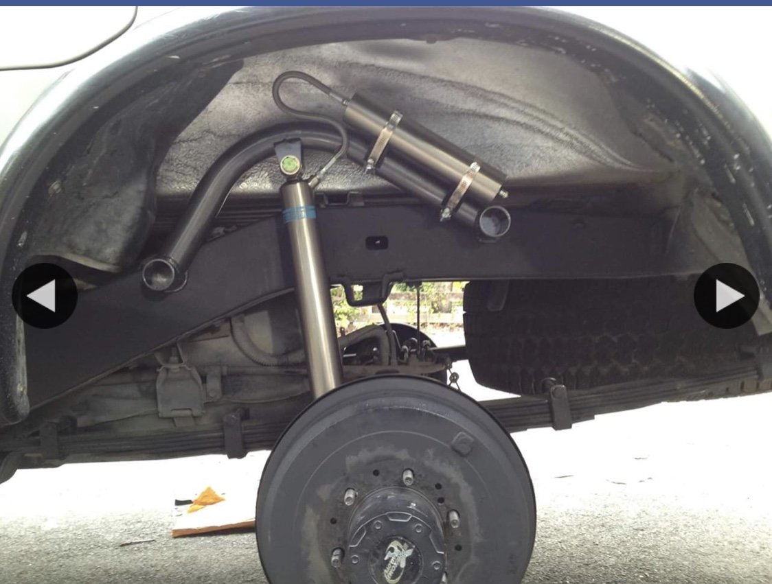

    orangeoutlaw Well-Known Member
    Jan 30, 2014
    #121849
    48
    NorCal
    2000 Taco ex cab
    2.5 sway-a-way coilovers, camburg 1" uniball uca's, Bilstien 7100's rear, Deaver j59 leafs, Solo Motorsports rear shock hoop relocation kit,Pro comp LA paz 16x8 matte black wheels with Toyo MT 305/70/16, 1.25" billet spacers, diff drop, Exedy stage 1 clutch, warn 9000, bent up bumpers, halo proj headlights, led tails and turns, snug-top, kicker comp 12, infinity kappa doors, kicker amps, painted frame, snug-top shell, yakima high roller bike racks

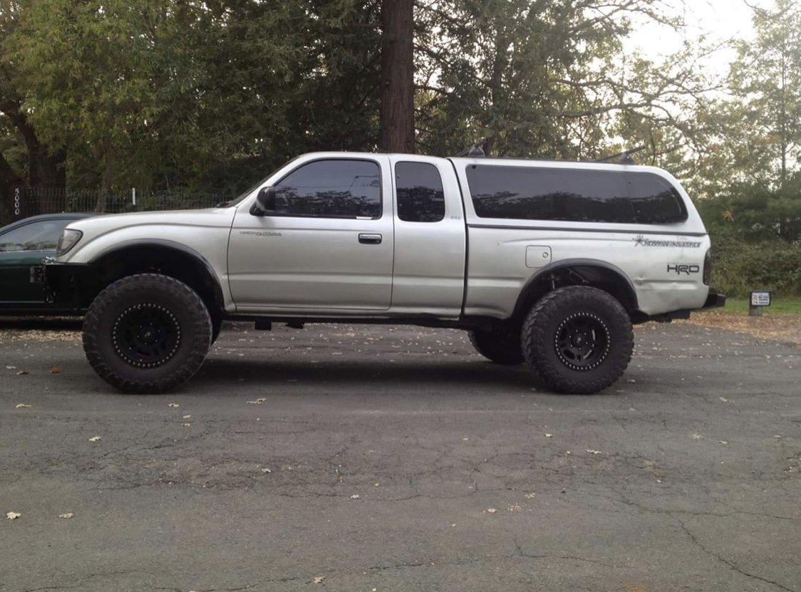

    I've had my J59's on my for 6 years now and I'm ready to get them checked out to see if they've lost tension. I emailed and called Deaver today, but was unsuccessful in getting through. I'm considering an AAL, new springs, lift blocks, or possibly a re-arch if Deaver recommends it. 60k+ miles and they're too soft and have lost lift. Funny thing is these have been 99% street miles and I don't beat on it. I have Solo Motorsports rear hoop shock mounts with 10" shocks so I could use the travel, but considering going back to a more HD leaf pack.

    Are those hoopes outside of the frame?? Got a pic?

    Edit: They're Bilstein 7100's 12" stroke. I have 1.5" wheel spacers now. It's been awhile. 1F992DE5-0106-4F6D-A527-E67F7F9C1467.jpg9002D1FA-3211-49D3-B125-490F90372D82.jpg
    6228E7E4-1B2D-4163-A125-D39B1BDD134A.jpg 96C80615-AD8C-4303-8970-64FCA2643A72.jpg 8E69AEA4-D9C2-4AB8-A469-52385D7F4452.jpg4C2BAD21-17B5-4E2F-87FC-24DC7AD91EB7.jpg

    those look bent in front of the wheel, no?
