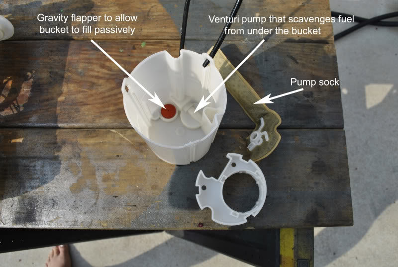

    This is absolutely true, however there is a generous protection on a lot of fuel pumps (I think most all of them now probably) in the form of a little "jug" around the fuel pump that is the absolute last thing to empty.
    Here's an example from a GM because it was the best picture I could find:
    See, I was totally bugging out when I ran my tank down to ~.1 gallon left and I frantically googled up everything I could possibly find about fuel pumps, thinking I had just totally boned mine. Turns out that's not the case, as engineers are smarter than they seem. That cup is your last line of defense for the pump's cooling- as long as you have fuel in it, the pump is going to be cooled.
    So yes, to run completely out of gas and have the pump sucking air is no good. However, the old "driving at under 1/4 tank is going to kill the pump" thing is a myth, at least on cars that have their fuel pump in this sort of assembly... I think maybe it applied to earlier model cars that didn't incorporate this design.

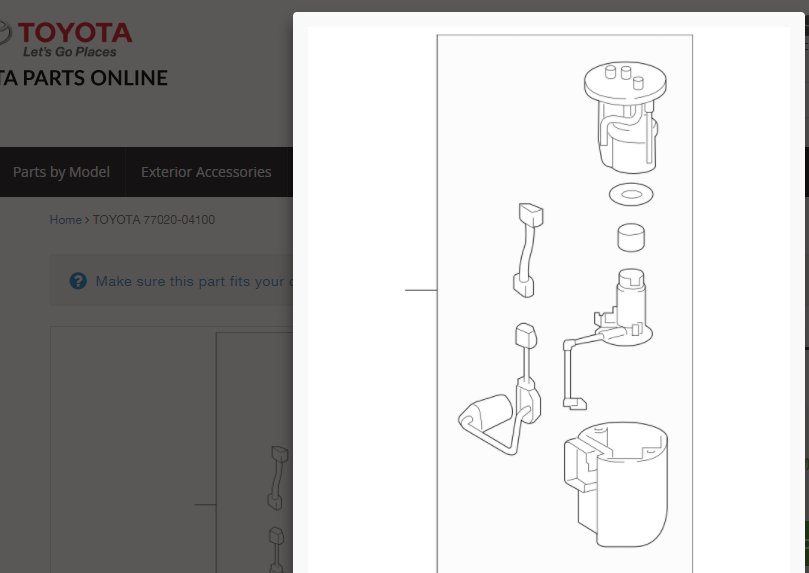

    Found a pic that pertains to your model. This is the pump for your 4 banger... Similar design with the casing. Can see the cup or "jug" as you mentioned, the float on the sending unit, in-tank wire harness, motor/ pump unit, and the rest of the main cap/ feed assembly.
