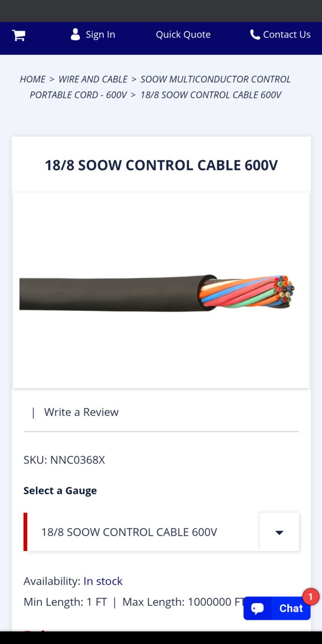

    caribe makaira
    caribe makaira Well-Known Member
    Feb 13, 2011
    #51121
    11,713
    Caribbean, Puerto Rico
    05 PreRunner TRD Offroad AutoTrans
    Hood Struts, My version Fogs always ON, Map & Overhead Light Mod,
    20/8...tinned copper...

    I did the multi-connector cable as others are suggesting. I was able to fit an #18/9C bundle through an existing hole just in front of the glove box. I just had to go like one drill bit size larger to get a grommet to fit the wire and hole. Worked for me because I was putting switches in the center console under the radio.
