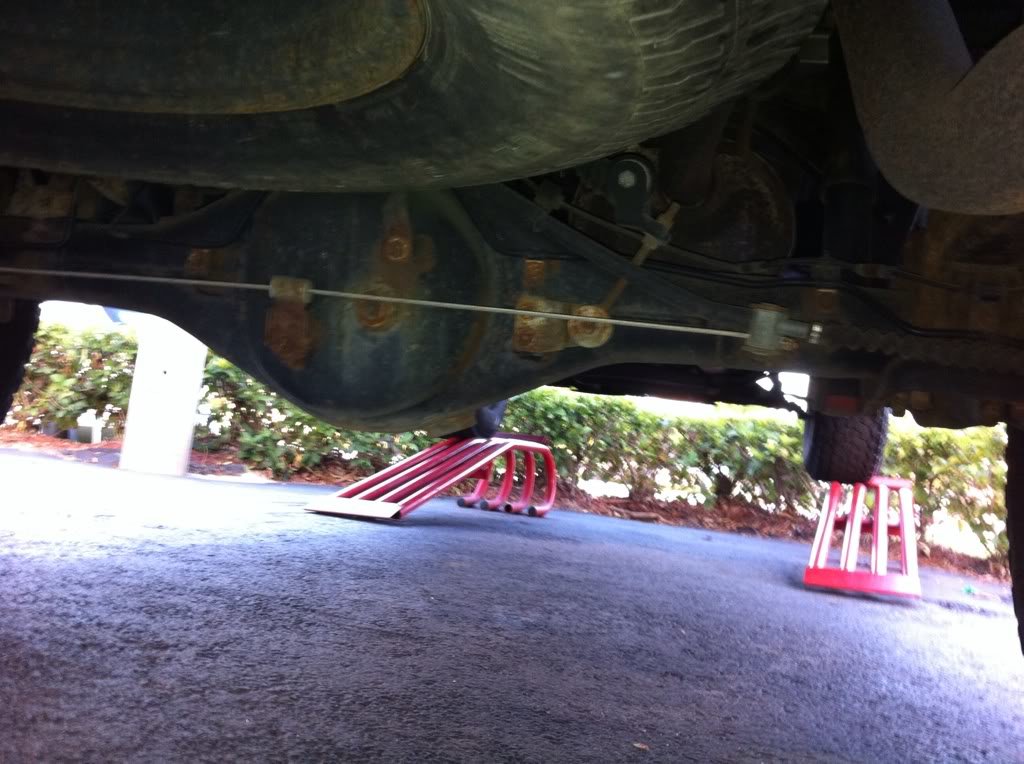

    So in my search for a first gen double cab, I found this truck. On the surface, it's pretty good. Drives terrific, 70k miles, clean carfax and autocheck, immaculate interior, and decent price at 13900.

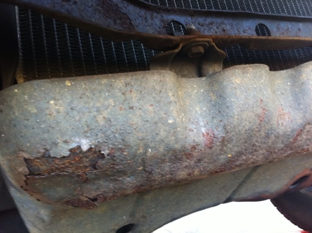

    But it is a northeast vehicle - don't know how concerned I should be about that. I looked underneath, the skid plate is extremely rusty, matter of fact rotted. Are the skid plates made of crap metal or is this an indication of poor care in the trucks life thus far? I've attached pics - where you see the rust on the skid plate I actually touched and put my finger through.

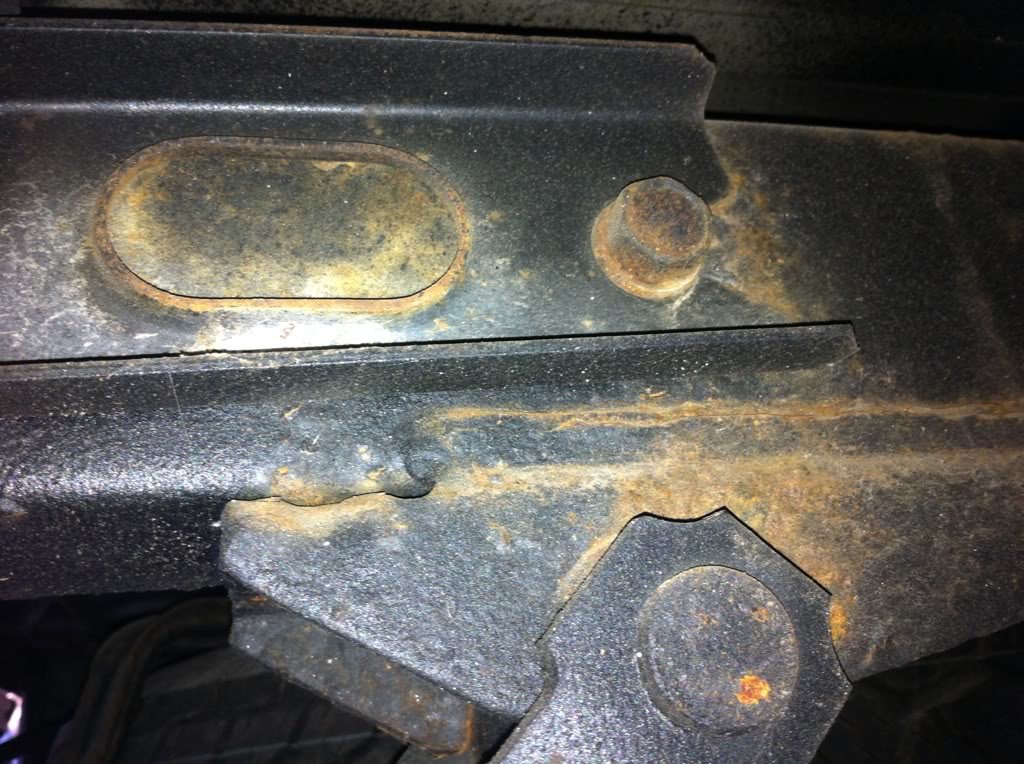

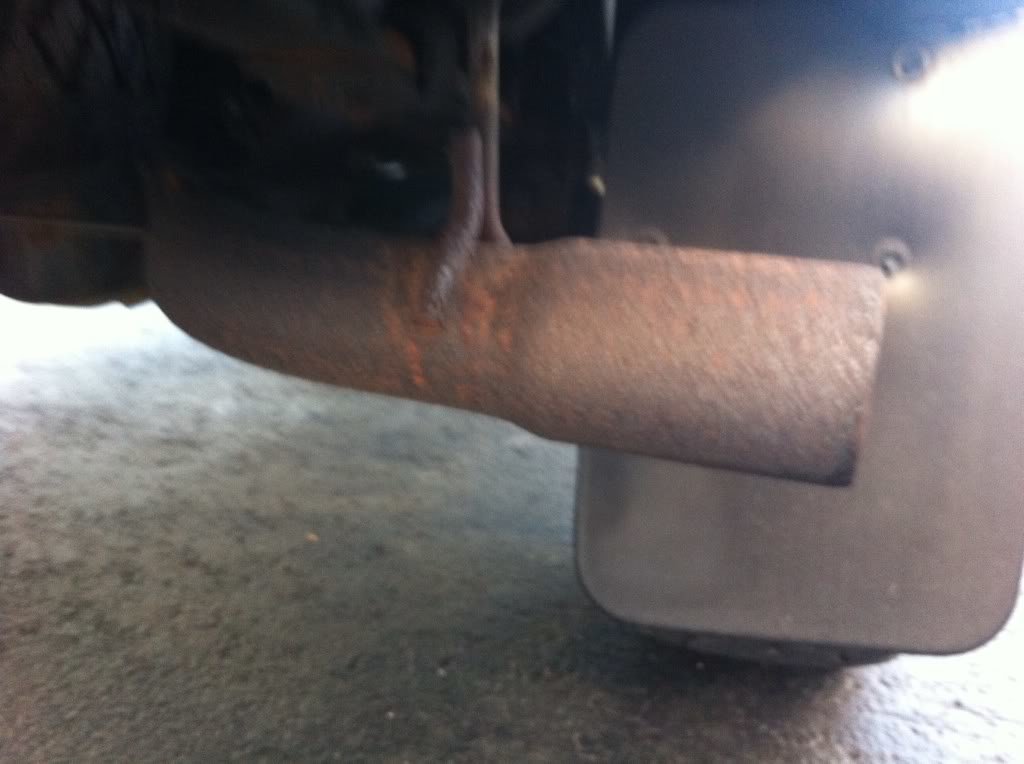

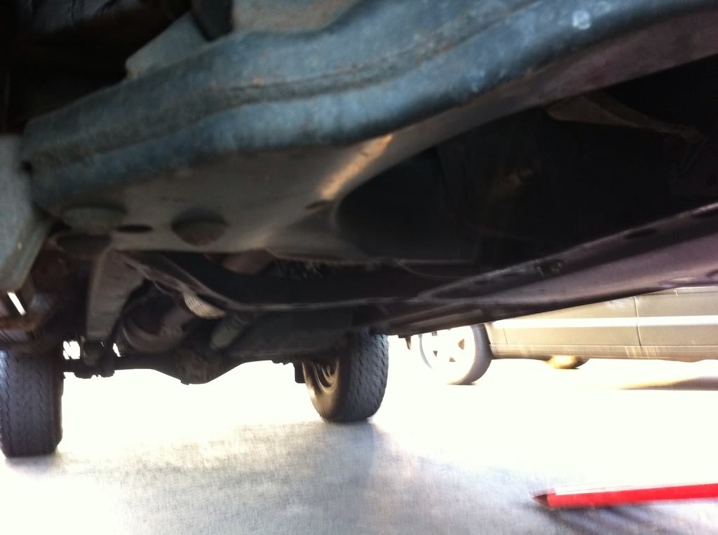

    The frame had what appeared to be surface rust by the leaf spring mounting points, and the exhaust was fine up to the muffler, which was somewhat rusty on its surface all the way back to and including the tailpipe. No rust anywhere on the body itself.
    The low mileage intrigues me, but quality of miles counts more than the number sometimes. I'm wondering if I should hold out for something cleaner even if it's higher mileage or are these normal amounts of rust? Obviously if this is normal, then this truck is high on my list of considerations, but if you guys think this is a bit excessive I'll have to put this on the backburner.

    Definitely have the frame inspected at an authorized Toyota dealer before making any decisions.

    and go back and get pics of the inside of the frame near the front leaf spring hangers. Thats the biggest problem area.

    Im in NY, mine was a plow truck before I bought it, and it is not at all rusty like that underneath. That exhaust and skid look pretty bad. BUT it'll probably fail the frame test, and you'd get not only a free frame replacement from Toyota, but anything else underneath that's rusty and in bad shape (excluding exhaust).

    Tho that plate by the radiator looks bad (replaceable, however) the frame looks good from the pictures you posted. That surfacey looking rust is nothing etching primer can't fix. As TacoMX said, check all around the shackles. Make a friend at you local Toyota service dept, and ask them to run the VIN for you to get more details about the truck...I've found a 6pack goes a long way to grease the skids. And for god sake, be careful under that thing...the front ramp looks sketchy!

    anyone else think the frame rails look a little oh idk bedlined? like from the rattlecan? if so the rust is even showing through the liner. just an observation

    I'de pass. Also those skid plates are expensive, the bottom of the radiator looks like its ready to leak,I wonder what the brake lines look like? give it a good going over if you can't resist the buy.

    Wow, if you go back to reinspect it........don't get under it again until they fix the ramps.
    And I second TacoMX's post. That's wear mine starting going first. And the skids are just thin sheet metal.

    And the frame rails - someone mentioned spray on bed liner. I was wondering myself what was on the frame. It actually felt like some sort of coating, but it wasn't stuck to the frame. It was oily and I could scrape it with my fingernails.

    That means it has past the frame inspection and was undercoated at the dealership. More than likely the previous owner traded it in shortly after.
