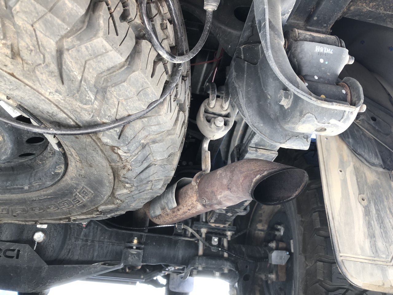

    So back in March I painted my tail pipe and I just noticed today that all the paint was gone. I have driven it maybe 1200 miles since March. Anyone know what other paint I should use? I really liked the black look.

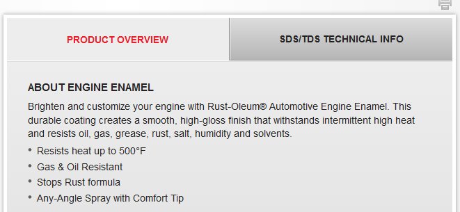

    I used Rust-Oleum 248938 Automotive Rust Preventive Engine Enamel Spray Paint. It's supposed to be good for up to 500 degrees. I guess it got hotter than it could handle.

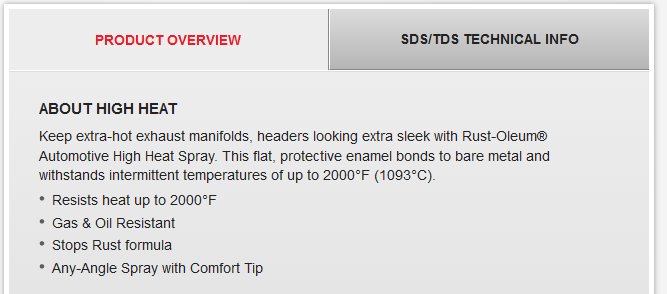

    if i remember correctly VHT has a header paint thats temperature range is 1300-2000F

    There's also Rustoleum High Heat paint which is intended for use on headers and the exhaust.

    Yup, that is what I should have used. There's quite a difference from 500 F to 2000 F. Lesson learned.

    Usually the highest temperate indicated on the paint is only for intermittent exposure and not continuous use.

    Lifted right off of Toyota's site:

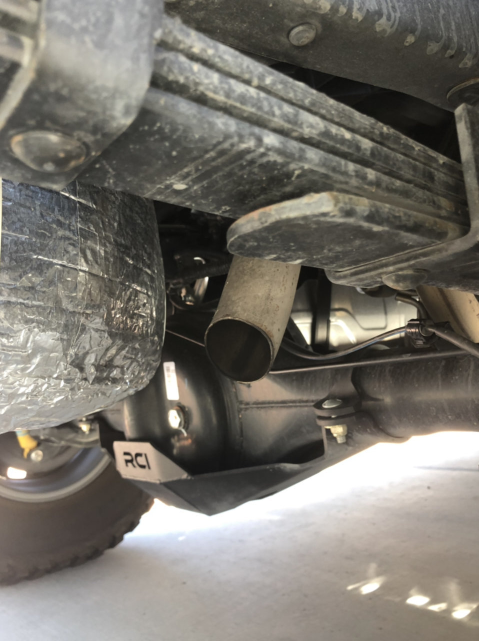

    I cut my bedsides for my high clearance bumper so it still woulda looked funny if I bobbed it I think. Either way, I was using the sawzall so off it went lol.

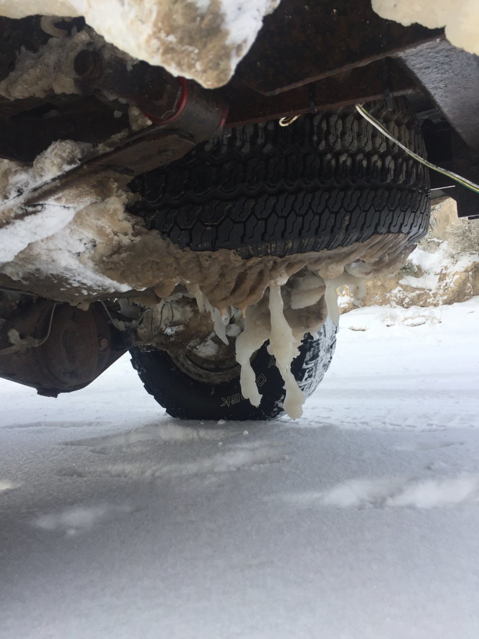

    #281744
    289
    Please explain that spare tire. It looks melted, worn, or both. lol
  18. Aug 20, 2019 at 8:50 AM
    #18
    JKO1998
    JKO1998 Well-Known Member
    Jun 2, 2015
    #156578
    52,949
    Utah
    Looks like it’s wrapped in something
