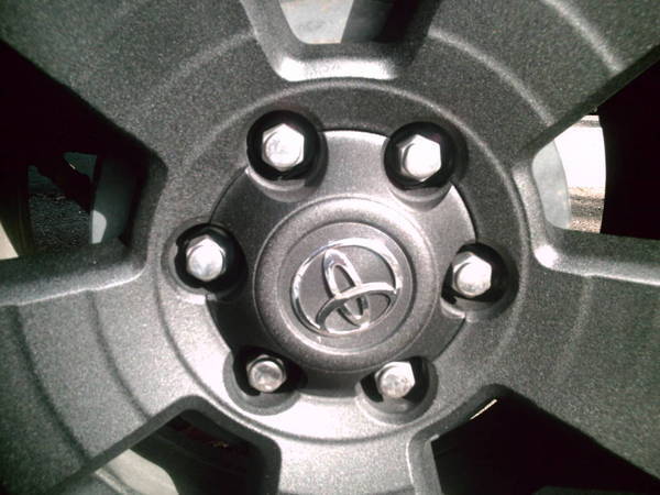

    First, I sanded the wheels and rinsed them off. Next, I taped everything off I didn't want paint on. I sprayed two coats of self etching primer on. Lastly I sprayed about 3 coats of the Rust-oleum bedliner.
    It's easy to touch up, I tape off the lug nuts and center cap, then put plastic grocery bags behind the wheels and spray. It has held up well through winter the biggest chip I have took off metal so I can't blame the product. I think it would hold up well on a valance too. The pictures look more shiny and gray in direct sunlight then they actually appear, the color is more of a matte black.
