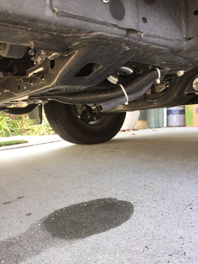

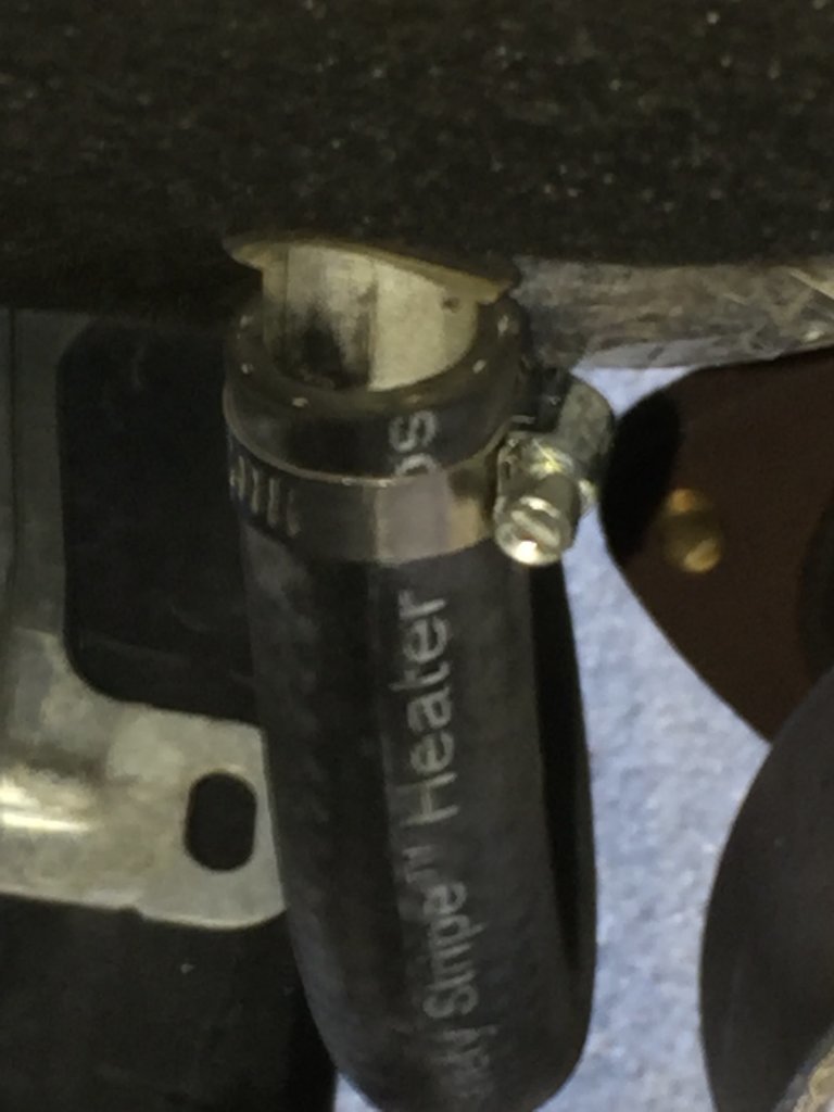

    Today it was a very delightful day in SoCal so I decided to do this mod to my 1yr old 2016 Tacoma TRD Sport DCLB 3.5L......I went to O'Reilly Auto Parts and got 3" of " ⅝ OD heater hose " , I had a clamp and went home....Let truck rest for 45 min and went out and slid the hose over the OEM ac drain hose and routed it out and down along the beam and zip tied it in three places...I wanted to make sure that there was a "Downhill" flow to any condensation so it would leak out....
    I must say that is the year I have had this truck, I have never seen any water on the ground after rides or when a/c has been used....it was very concerning because all my cars drip water like crazy....so I did the mod and turned on A/C full cold and let run....After I started the engine, went around and look to see water pouring out! then if started to drip rather briskly.....let run for 15 min and looked to see what it looked like.....small drips of water which makes sense.....there is a small amount of air puffing out when the engine is running but that is normal...
    So thanks to everyone who wrote up their process and to OP for starting post...I have learned a lot form all you guys and gals.....here is what mine looks like....please don't laugh at white tie wraps.....all I had....they will be replaced....:)
    Total cost of parts: $4.47
    Tibetan Nomad and Riding Dirty like this.
