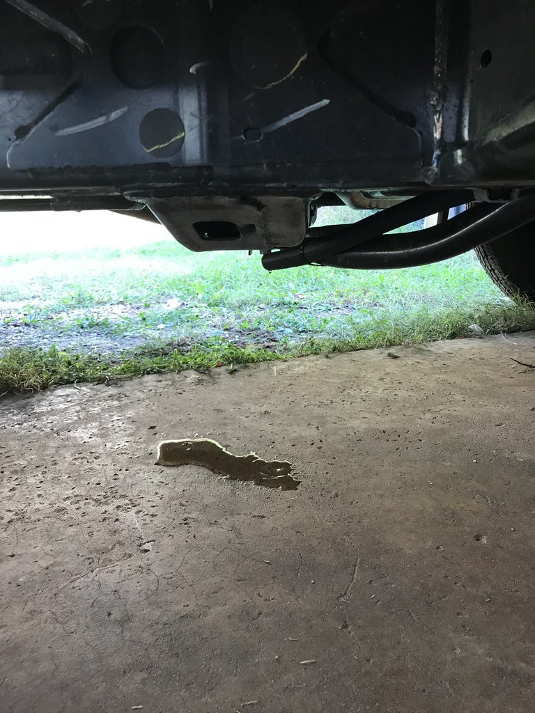

    Not sure if you remember, but do you recall what size that barb connector was? Mainly what size you used for going into the existing drip hose.

    I did the same on mine:
    For anyone that wants to know, I used a 3/8" to 5/8" adapter barb fitting. The 3/8" side going to the drain tube was pretty tight, so be warned.
    I did not like the raw tube sticking out, so I added a hose fitting and a stainless steel screen on it:
    Overkill, I know... but, I wanted to make sure crud and critters did not get in the tube and wanted it to look decent.

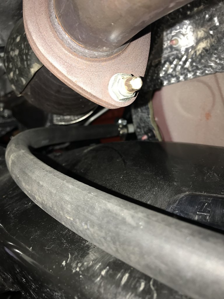

    I did not see any rust on mine (knock on wood). I could not see the inside of the front inner rail, but the top looks good and you can see that in my pic above. I'm rather happy mine looked pretty decent after I saw what Uptown2k had.

    Would love to meet the idiots responsible for that design... Actually create water and drip it on the frame where the exhaust system heats the frame. Hard to get any dumber.

    Did that tube routing work for you? I started down that path, but got worried about heat from the exhaust. Have you had the chance to really heat that thing with an extended idle under a hot sun with no wind?
