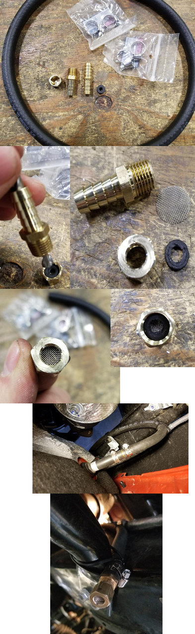

    My take on this fix.
    PARTS
    - 3/8" x 3/8" Barb Hose Splicer
    - 3/8" x 1/4" IN Barb Adapter
    - 1/4" IN Pipe Cap
    - 3/16" x 7/16" x 9/32" x 5/16" Rubber Grommet (Lowes# 884624)
    - faucet screen
    - 1/4" to 5/8" stainless hose clamps.
    - 2 feet of 3/8" ID Hose (Advanced Auto only had gas line)
    1) Let the truck cool down - haha
    2) Put the grommet inside the pipe cap and screwed the barb Adapter into the cap so the grommet cannot move. Then drilled straight through the assembly. Take apart and make the hole in the grommet and cap a little bit bigger.
    3) Hand cut the screen to to the diameter of the grommet, which fits perfectly inside the cap.
    4) Cut the grommet in half (this makes it like a rubber washer now)
    5) Put the screen in the cap, then put the Grommet/washer in and tighten down the barb Adapter on top.
    6) Connect the rest and zip tie like everyone has done.
    Thanks for the idea guys!!

    Good point and a good reason to use clear hose. At least you'd be able to see if it froze up.

    Gonna tackle this today. Anybody have any issues with the heat off the exhaust there being so close to the hose? Or is that a non issue when using the heater hose?

    non issue
