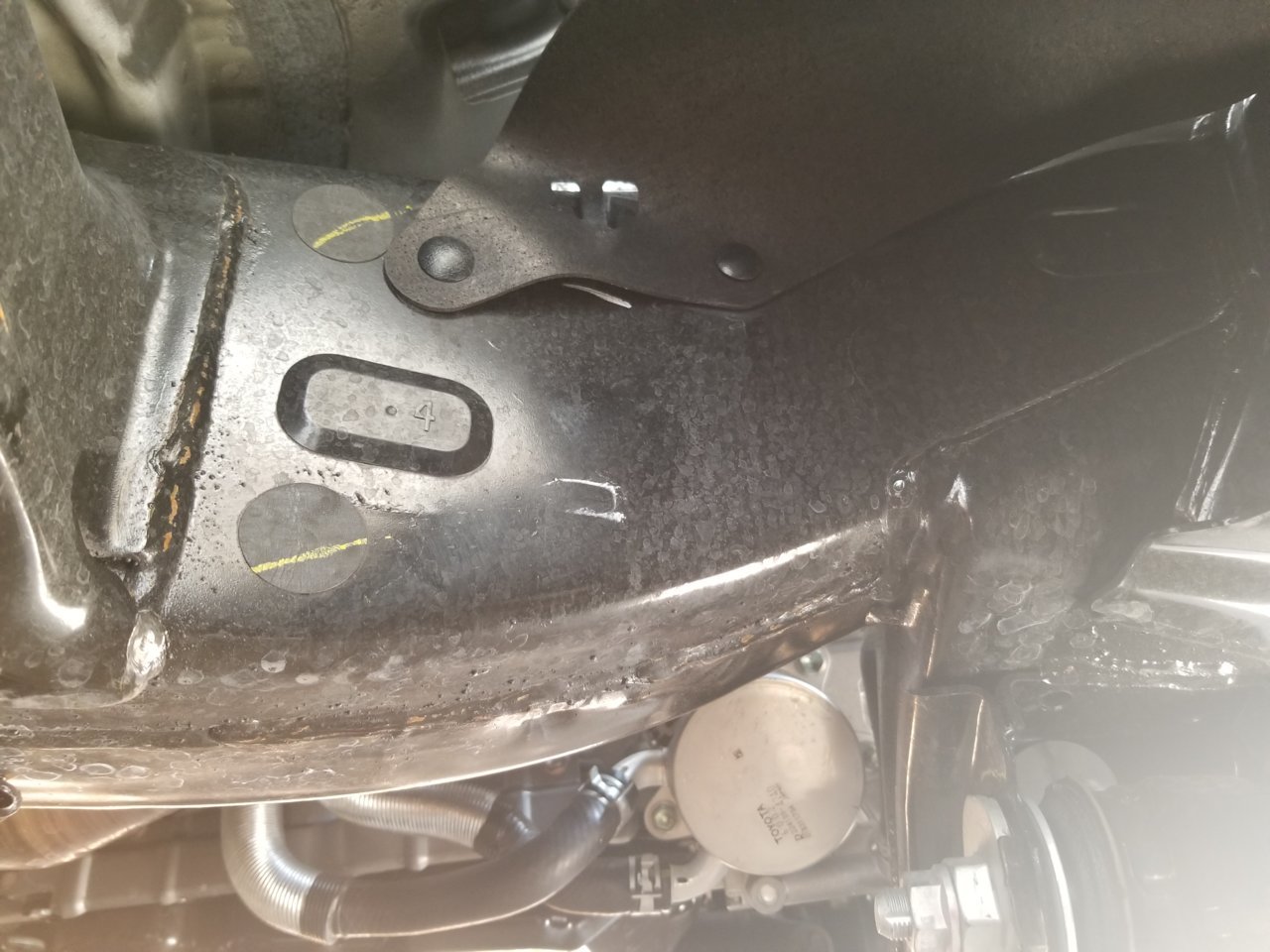

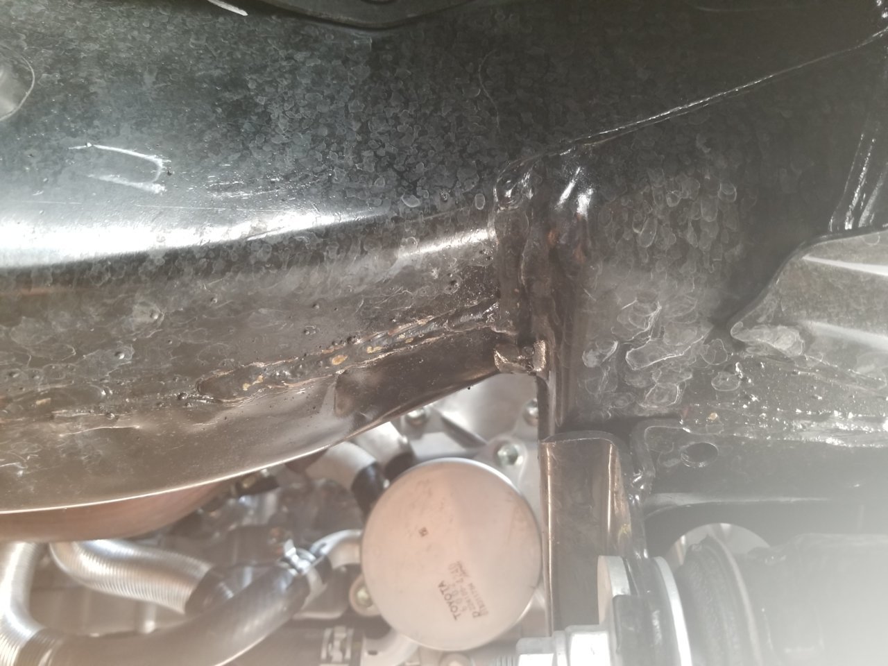

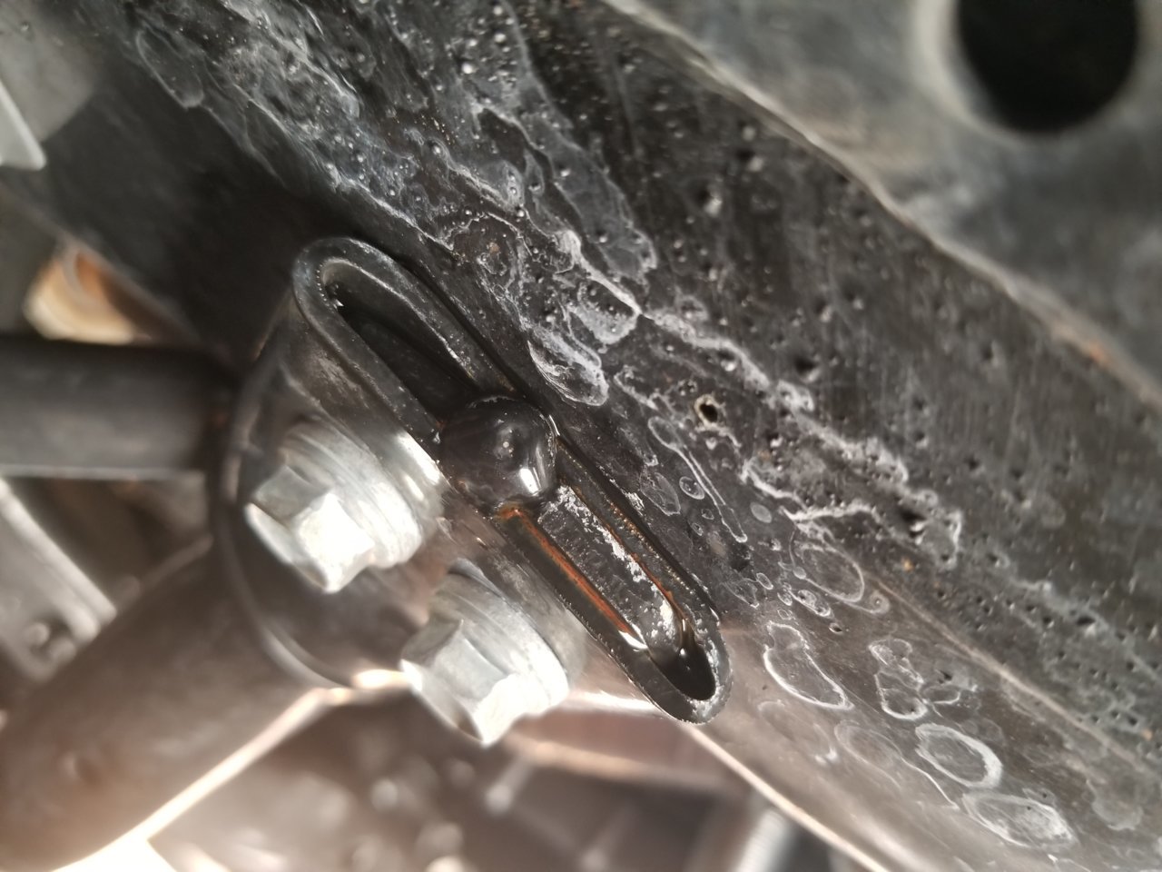

    Decided to do this today and found little rust in spots

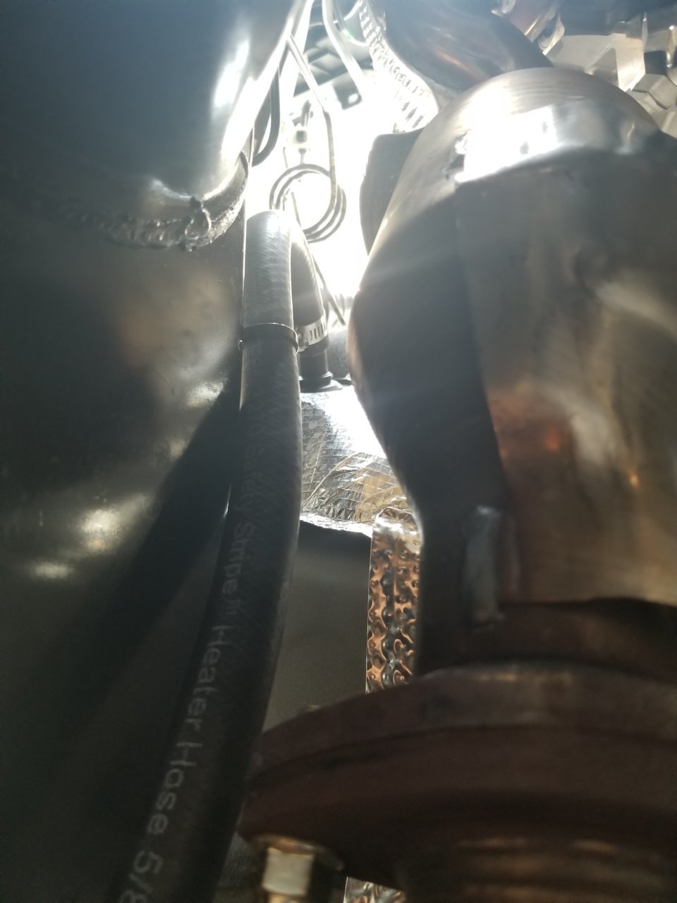

    Hose added...
    Any suggestions on the little rust spots?
    Thanks TW

    Some of that isn’t rust, its weld spatter that didn’t take too well to the paint. For mine, I painted over these areas. For rust spots, I dabbed rust reformer on them, the next day I painted them over. Then fluid filmed everything.
