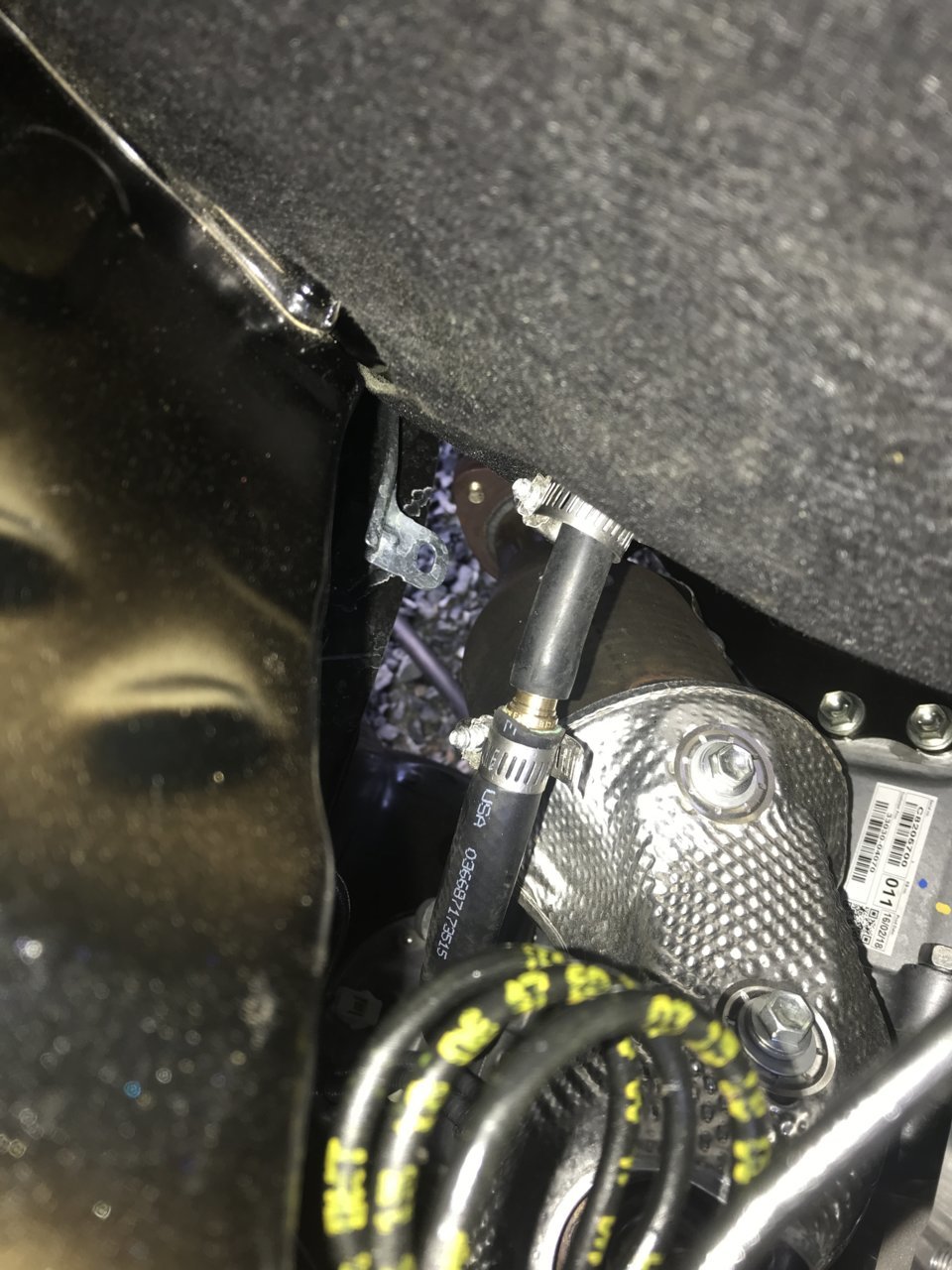

    Can someone check my routing of the heater hose? I'm "mechaniclly challenged" and tend to tear stuff up. Thanks in advance

    Looks ok to me, just make sure it doesn't touch the exhaust. Best to keep it as far away as possible

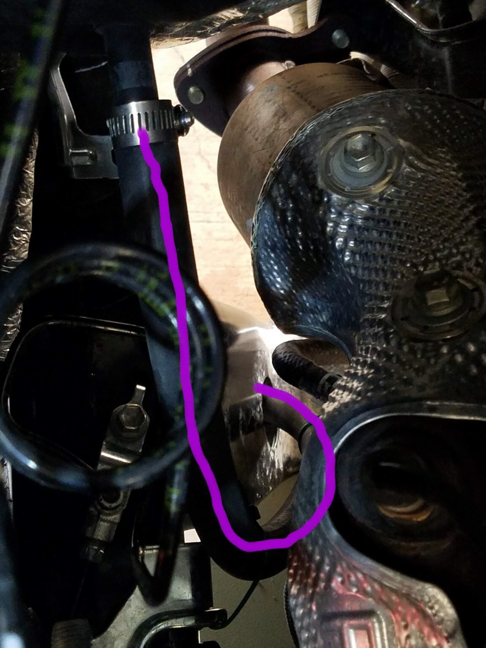

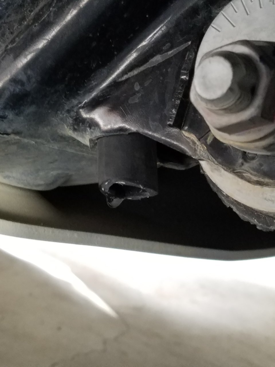

    Did mine this morning. Pic1 shows where I attached the 5/8 heater hose with minimal bend and secured it with a zip tie. Pic2 shows where it enters and exits the frame crossmember.Pic3 is a snapshot of where it exits and trimmed it down to 1/4". I had O'Reilly auto parts cut me 28 inches and it cost me about $4 bucks.

    You could just zip tie it to the crossmember like I did on mine (see post #338) to keep it far away from the exhaust. Other than that it looks great.
