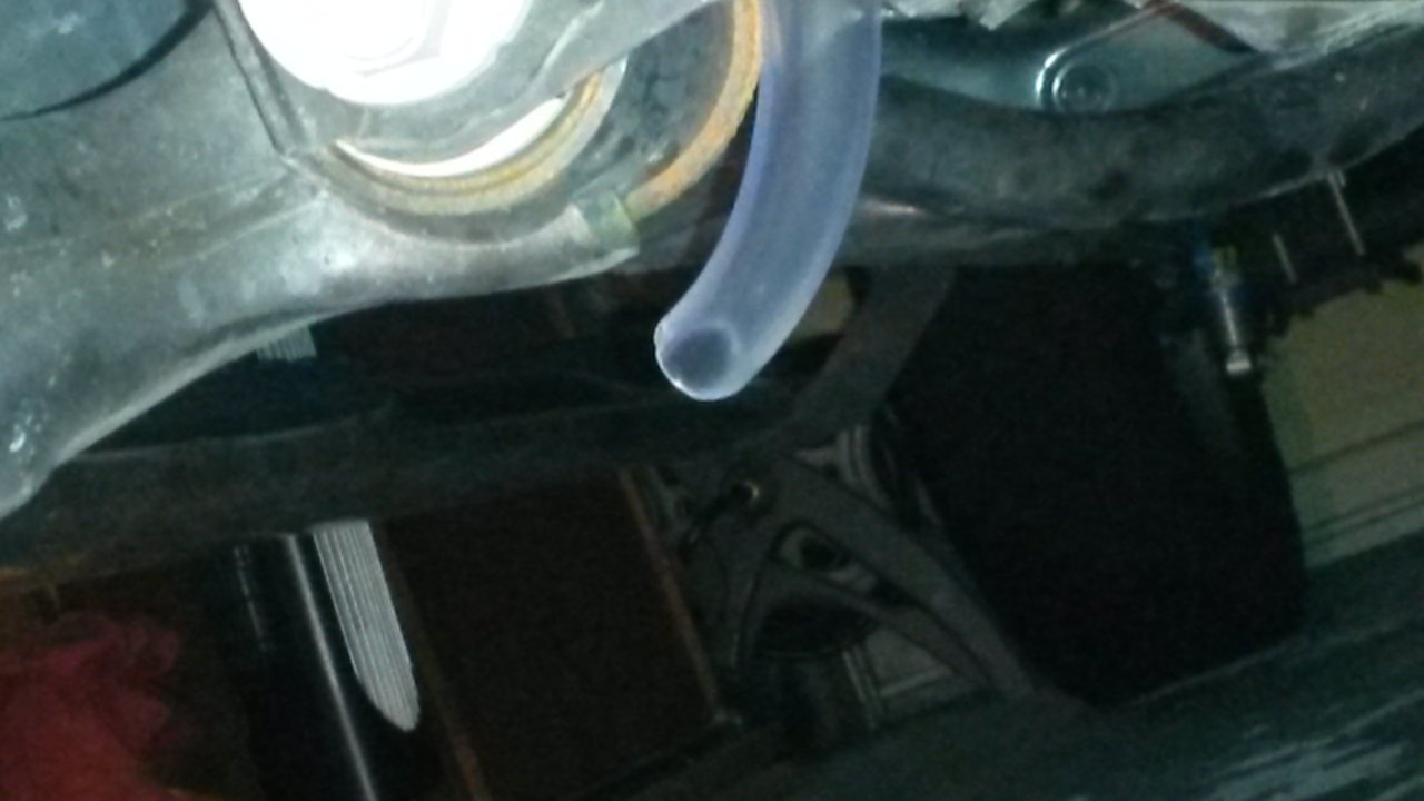

    I just did this with 200 miles on my truck. First problem i ran into, the 5/8 hose dis not slide over ac drain tube easy. Hose would retract into firewall. Got it more than halfway and clamped. Second problem was routing which i finally figured out after a few tries. Keeping away from exhaust was important. Runs under trans and feeds through crossmember where it sticks out 1/2". Drains well and makes me happy lol

    I did the same exact thing and feed it through the crossmember. I felt this was a better route and almost a straight downward flow of the condensation.

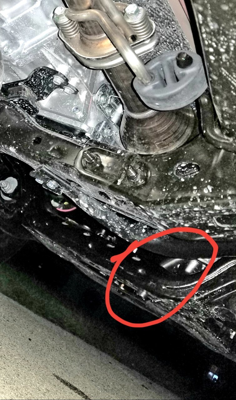

    Rough photo but i circled the hose underneath the vehicle. You can see the wet spot on concrete where it drains.

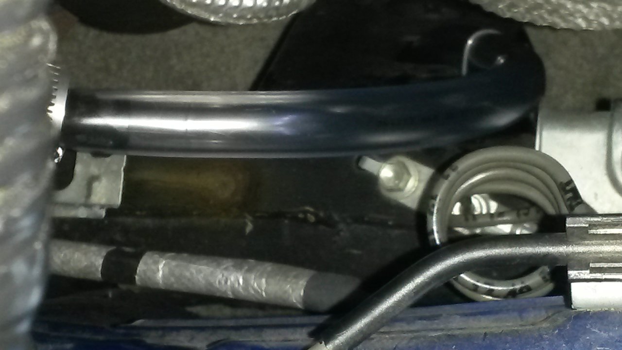

    This was my main concern.. is the hose supposed to be "lose" like that?

    Not sure. Sketched me out too but i just made sure it was draining. Plus ill just keep an eye out for leaks. None to be seen, besides ive got a shiny new warranty thatll fix that if i have problems within 3 years

    True just be sure to remove the hose before taking it in for service!

    Yea it would take less than 5 mins to remove. 2 zip ties and one clamp.
    I will be keeping an eye on it to make sure the hose never kinks, gets clogged or anything like that. But the benefit of not having water running onto my frame every time i turn the AC on outweighs any potential negatives to me. Preservation up here in WI is important lol. I bought 3 cans of Fluid Film that ill go to town with in the fall
