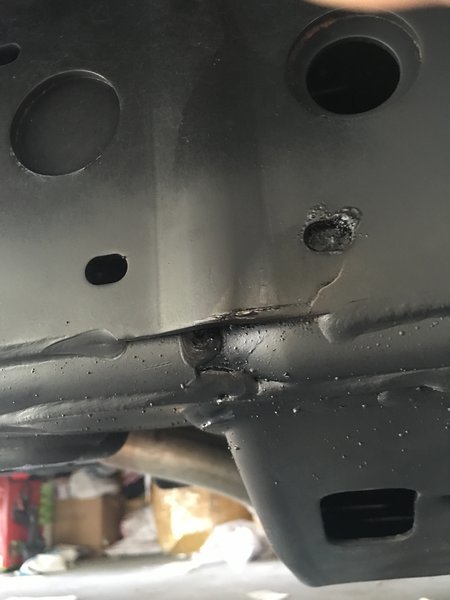

    For those of you with rust, where exactly is the spot (I can't tell from the picture in the first post)? Can you see it looking down from under the hood? I have an RCI skid plate, would that block me from seeing it?

    I know I may just be dumb but is that 5/8 inch the inner or outer diameter of the hose?

    Thanks guys, I'm going to get this done today. I'm kind of scared to see the rust after 5300 miles, especially since I'm down here in Florida

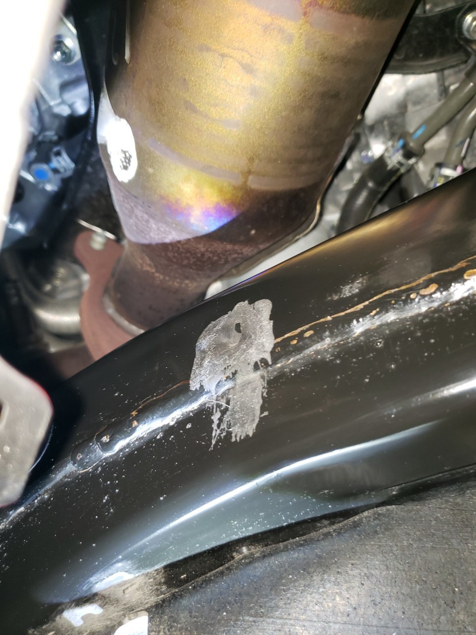

    Here's the pics of what I found under there and the work I did. I'm spraying the frame with the rust resistant spray paint.
    I'm also wondering what that patch of rubber type material is on the frame right under the AC drain pipe. Anybody know?

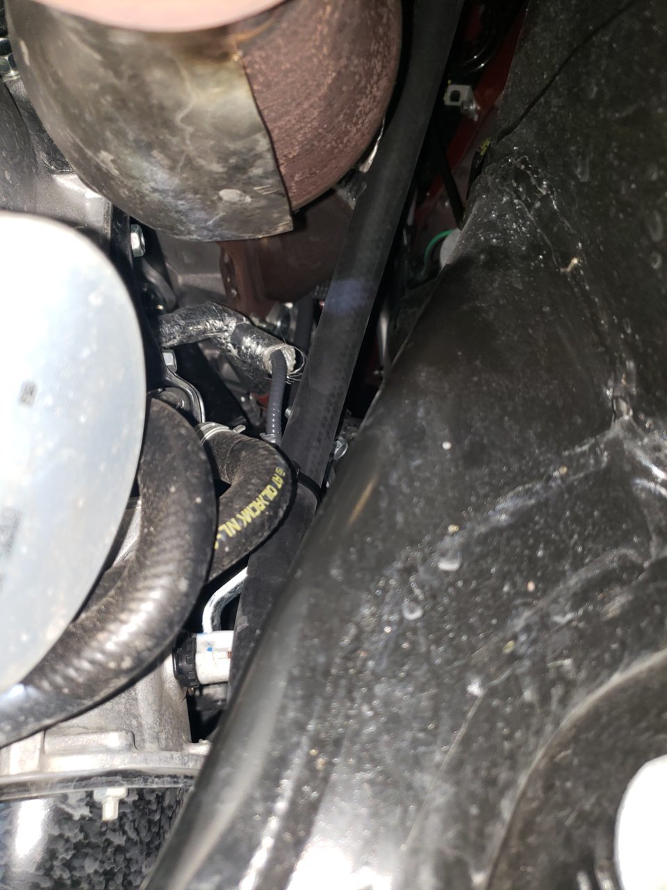

    Not sure the hose is but I zip tied my extended AC hose away from it just to be safe.

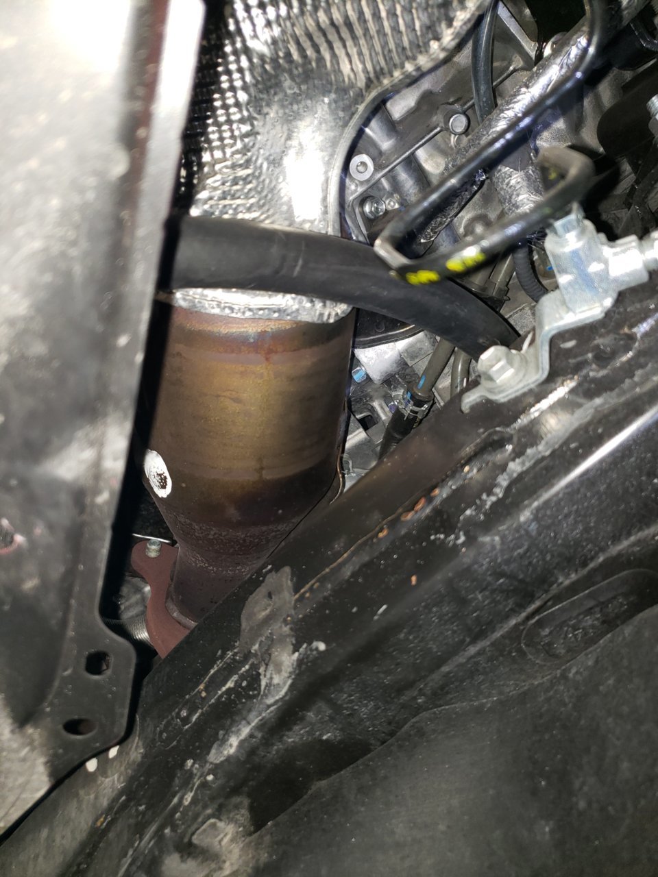

    Quick question, does Fluid Film be another alternative to this problem? I did this mod but my concern is that its pulling and pressuring the little OEM drain hose that sticks out from the truck. Not really sure what this OEM hose is being held from the inside, but my fear is while driving bouncing taking holes etc will eventually do some damages and perhaps yank the oem drain hose out.
    Any thoughts or second alternative other than the A/C drain mod??

    As long as you keep the hose zip tied in place away from heat sources as best as possible, you'll be fine.
