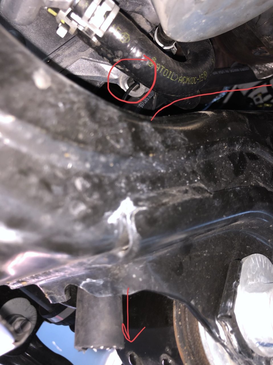

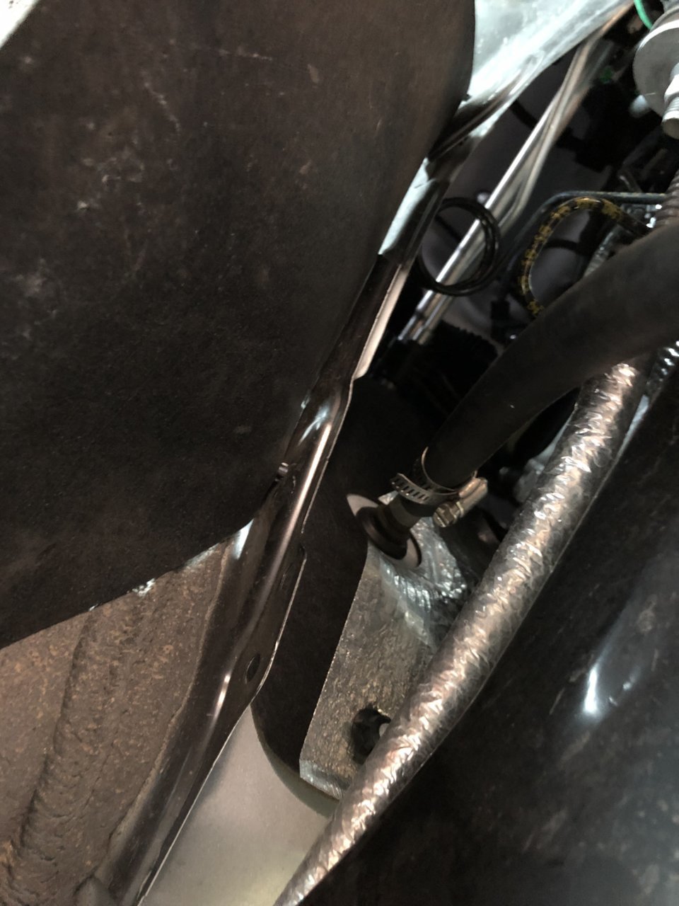

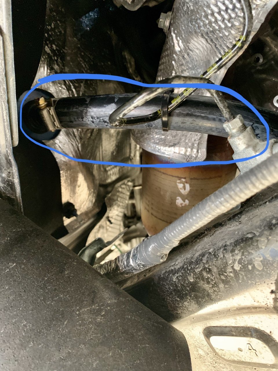

    56699272-68B8-4D4D-8B87-40DE7795AB3B.jpg 6A9638EB-11D7-4E02-837F-DE94DDC538C3.jpg A0656886-0272-439E-AD17-5C7A13BDD718.jpgJust completed the mod after 10k miles. Didn’t notice any rust. Thanks op for the detailed instructions.

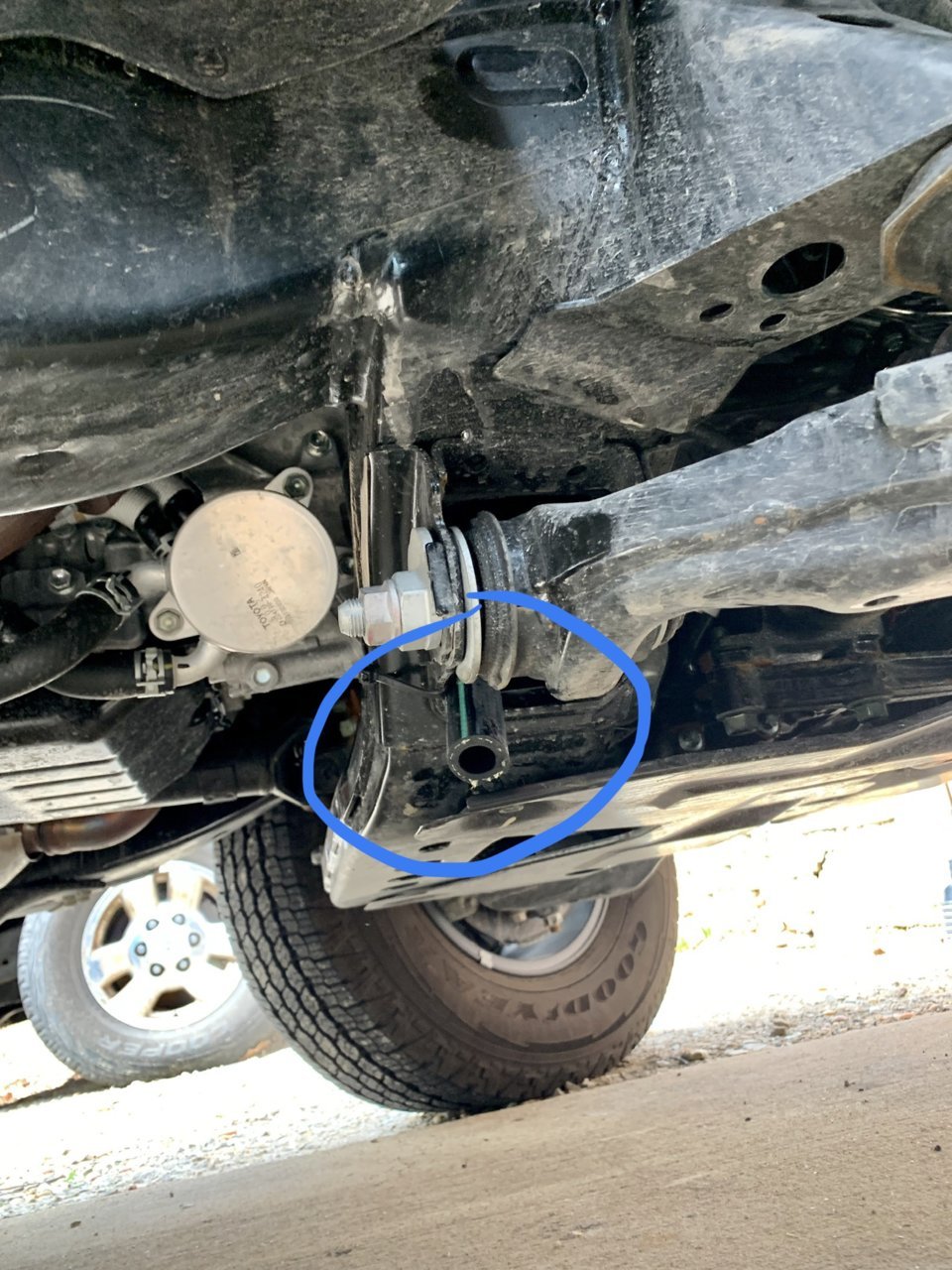

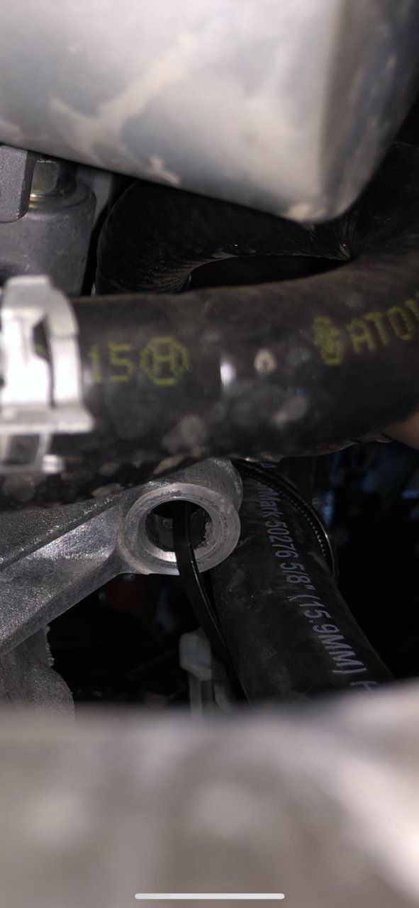

    Did this real quick this morning. Haven’t used the AC yet, but it’s starting to warm up here in Missouri, so I figured I’d get on this! Easy 15 minutes.
    1FE7C901-B7E6-4510-A9FE-BB0E7D14D495.jpg 8033AE68-B87D-47E6-895B-432C95931AD4.jpg
