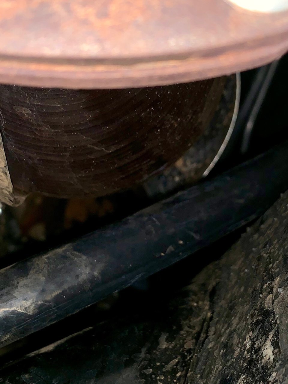

    -Bds 6 in. lift, Fox factory 2.5 coilovers with dsc + remote res and factory 2.0 shocks with comp adjuster + remote res. -Fab fours front bumper -Method MR305 wheels -35/12.50 R18 Milestar Patagonias -Header back 2in. I.D. true duals with 2nd cat deleted (X pipe turbo muffler) -Af Dynamics Intake -Ovtuned running 2.0 SFOB Premium tune with @92ehatch and @tonered throttle edits (1st version with high tip in and sensitivity) -URD Stage 3 clutch (Ceramic/Kevlar) -Custom trail rash and dented bedside
    My buddys 08 tundras frame is completely rotted through and seperated between the cab and front strut mount and toyota wont do a thing about it for him. He bought it back around 2010 and its been treated well ever since the body doesnt have any rust and the frame is still painted for the most part but where the ac dumped on it has completely destroyed the frame in that spot. Shits no joke take a few minutes and do this it could save you in the long run

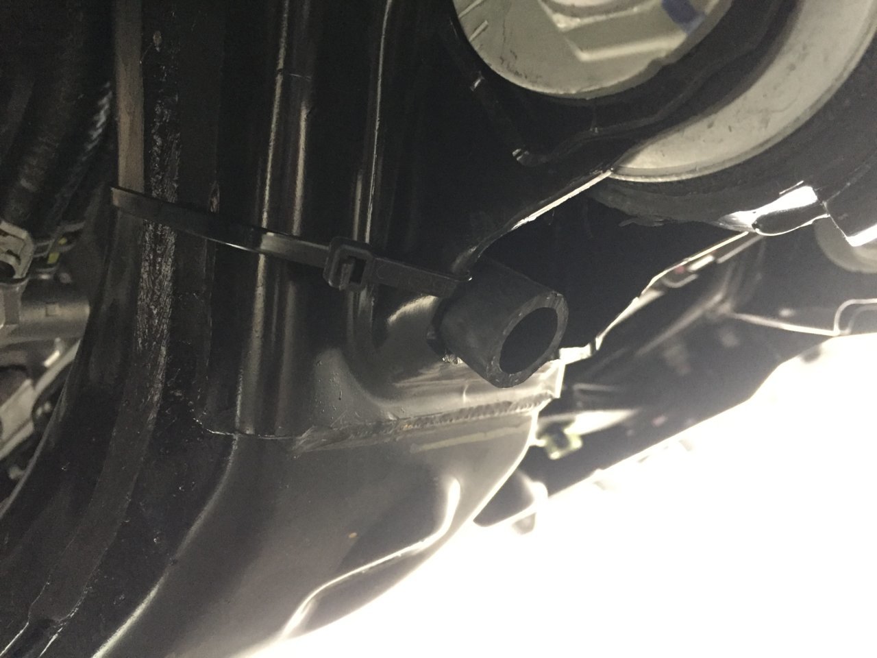

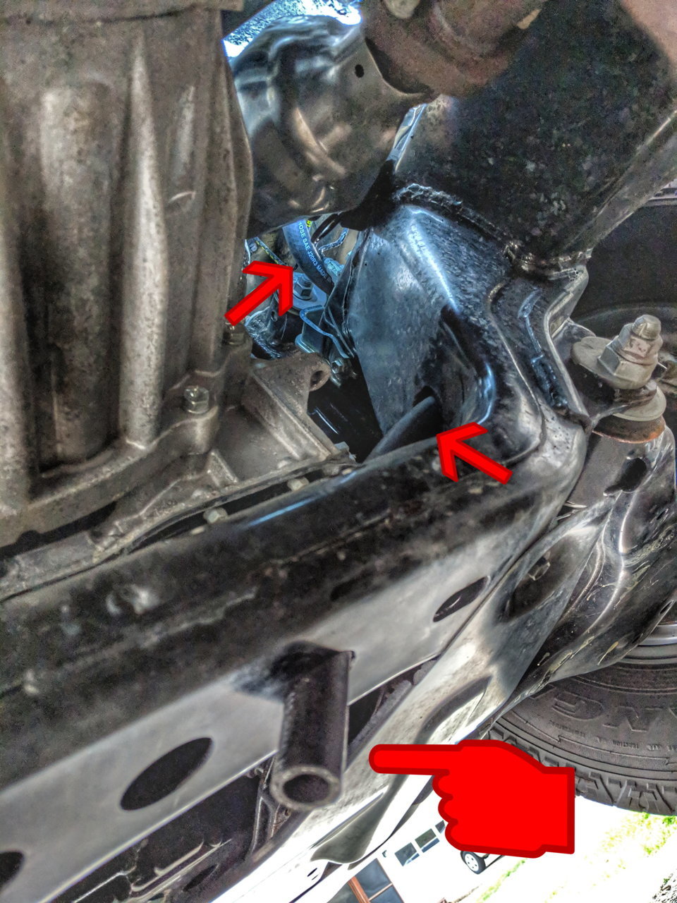

    I'm sure this has already been posted, but found a perfect route for the hose that requires no zip ties. I still used one at the bottom (after I took this photo), just to increase the diameter of the hose to prevent it from tucking back into the crossmember, but overall it's protected very well from the exhaust.

    Just to clarify, these pictures are looking from the outside of the passenger wheel well,? I did not do this yet so if someone can tell me the process I will get to it

    I’m yet to do mine too...looks like you are looking like your head is under the tranny looking toward the Pax side front corner. Pax tire is on the right of the photo.

    In the picture I posted, I'm looking up to the passenger wheel well from under the truck, right below the tranny.
    There route I took, goes from the original drain tube location, into the support for the cross member, out the top of the cross member, then back through it to the ground. This keeps a good chunk of the hose isolated from the exhaust.

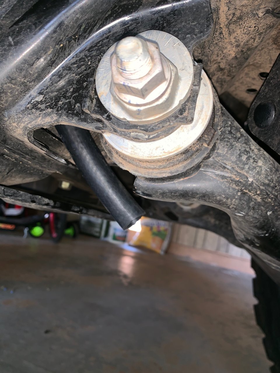

    Just did the AC Drain Mod and i ran the hose as most people did but popped it out near the lower control arm. My question the hose comes pretty close to the exhaust system only about .5" apart. Will that be an issue? IMG_2471.jpg IMG_2470.jpg
