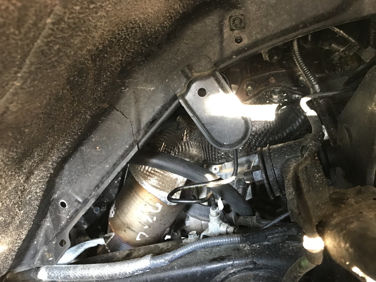

    Damn. I think I ran it inside the, not through it. Totally missed that holes once it enters.

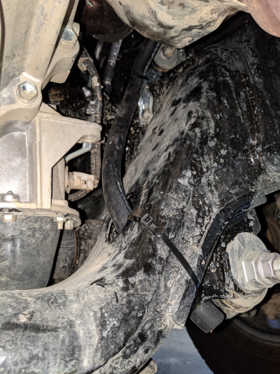

    Frame openings look different on my 2019:

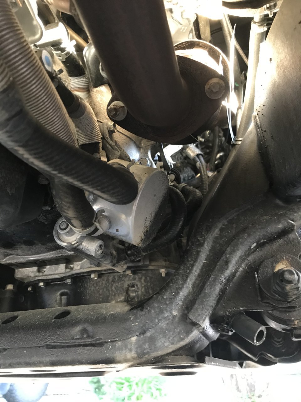

    Wanted to share where I routed the hose and get some opinions on it.
    I did cut the hose shorter haha

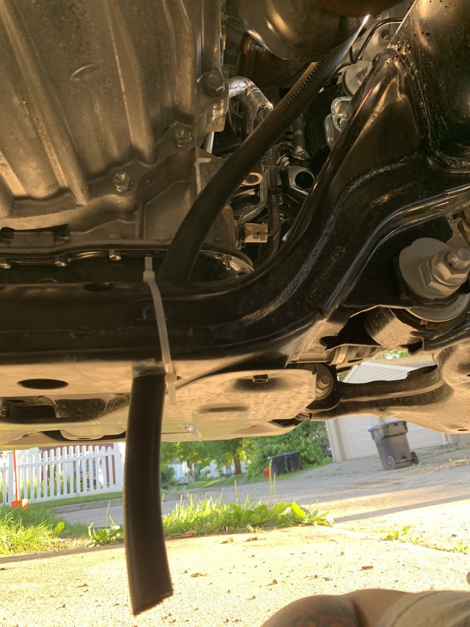

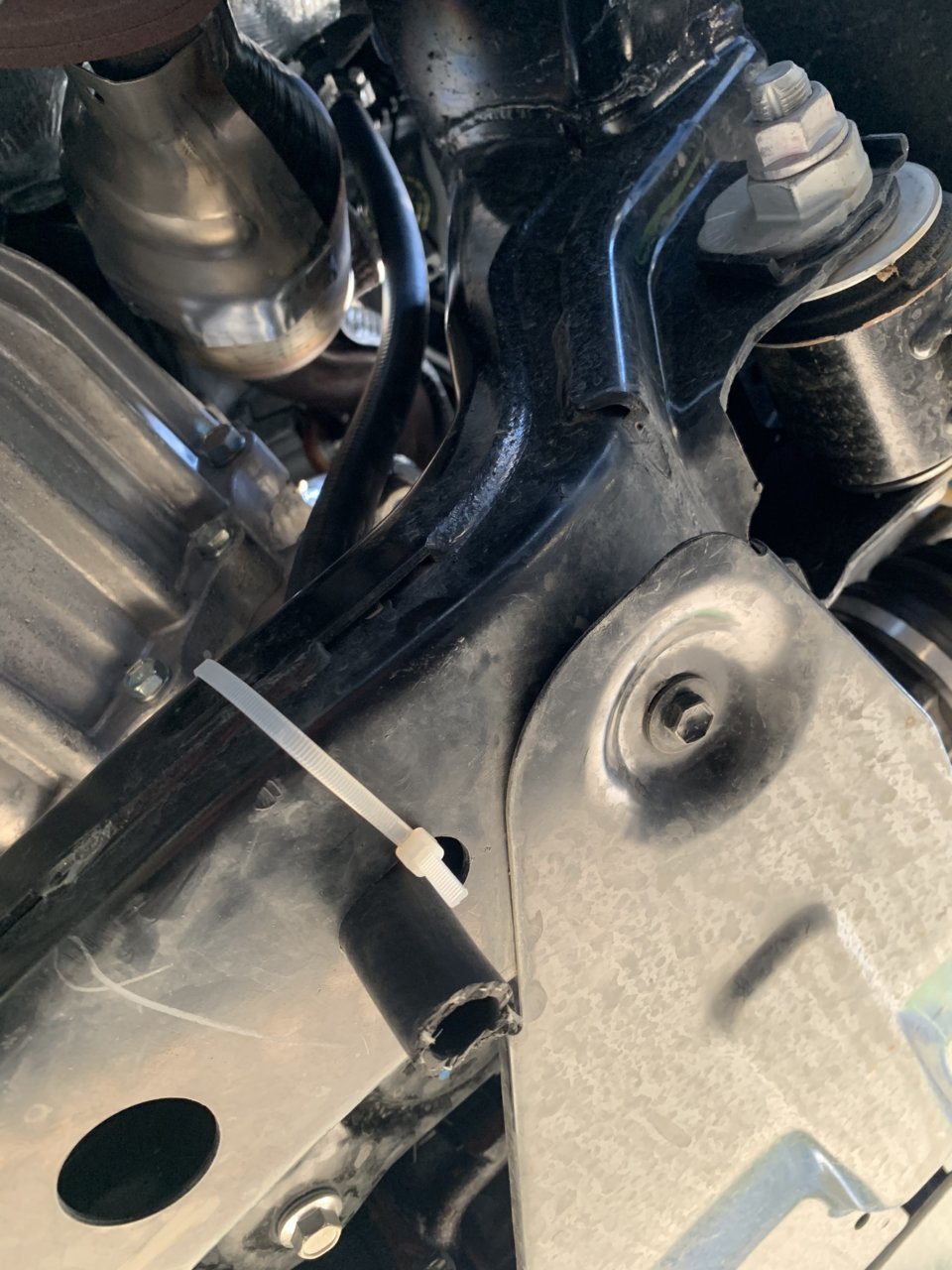

    Just did my 2018 AC as well, using 5/8” ID heater hose. Kept it away from exhaust with two zip ties to the brake line bracket. Anything to slow the rust down. I have enough hose left to do this to my dads 2012 as well. I’m assuming 2nd gen Tacoma’s have the issue as well.. Thanks for the info!843B19EA-4214-413B-B212-678C27CBDA3A.jpgEA00A727-F4BF-45AD-A850-F757C1B80969.jpg

    I'd get that hose further away from the exhaust, but that's just my two cents.

    I'm still trying to figure out where this is :LOL:. Left mine real long so everyone keeps saying something about it. I'll get around to it. Was messing with it at night and there were too many bugs. I'll have to find that entry hole.

    I agree, I've been keeping an eye on it.
    Got into 30 miles of the DBBB in Slade Kentucky yesterday & had no hiccups.
    I still keep an eye on it, might just add another ziptie for peace of mind.
