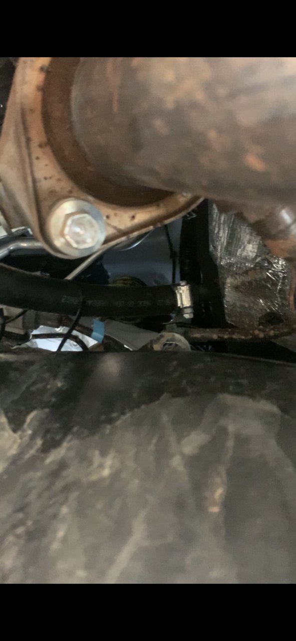

    Quick and easy fix! Thank you! Ran the heater hose down through the crossbar of the frame. Had a good video but it wouldn’t allow me to upload
