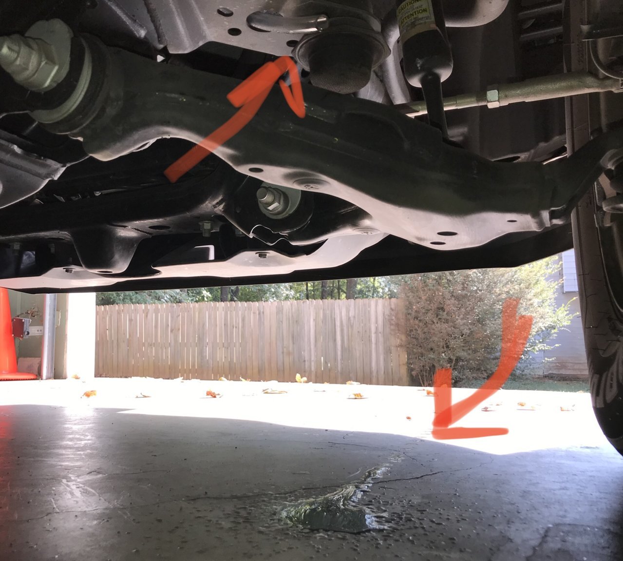

    Just picked up a 2017 access cab with about 40k. Checked for the Ac drain mod. Not present. Extended the hose and happy with the results. Thanks TW!

    Thanks for this mod! It's been just 1 month since I took my truck off the dealer and I could see the mark of the water dripping over the frame already. Super easy to fix no more than 15 minutes.
