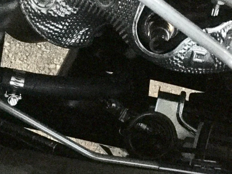

    Not many zip tie points.. any suggestions?
  17. Aug 12, 2016 at 3:13 PM
    #57
    Riding Dirty
    Riding Dirty Sinner; saved by grace
    May 27, 2016
    #188065
    2,391
    Before: '16 TRD OR 4x4 AC QS//After: 17 T4R Pro 040
    PlastiDip
    I zip tied mine to the bottom of the bracket holding that odd looking coil shaped wire in the engine bay (looking down from the hood over the wheel well), it seems to hold it just right in place. Sorry, I don't know what the correct name is for that part. I don't have any pics right now or I would post it.

    Can you post a picture when you get a chance?
  19. Aug 12, 2016 at 5:29 PM
    #59
    Riding Dirty
    May 27, 2016
    #188065
    2,391
    PlastiDip
    Here goes......if it isn't good enough to distinguish, I'll have to try later.
