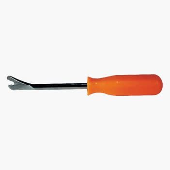

    How do you remove the 2 clips? Just putting pressure with a flat screwdriver? I do not want to break them, thanks

    I have an actual clip puller. Made it very easy.

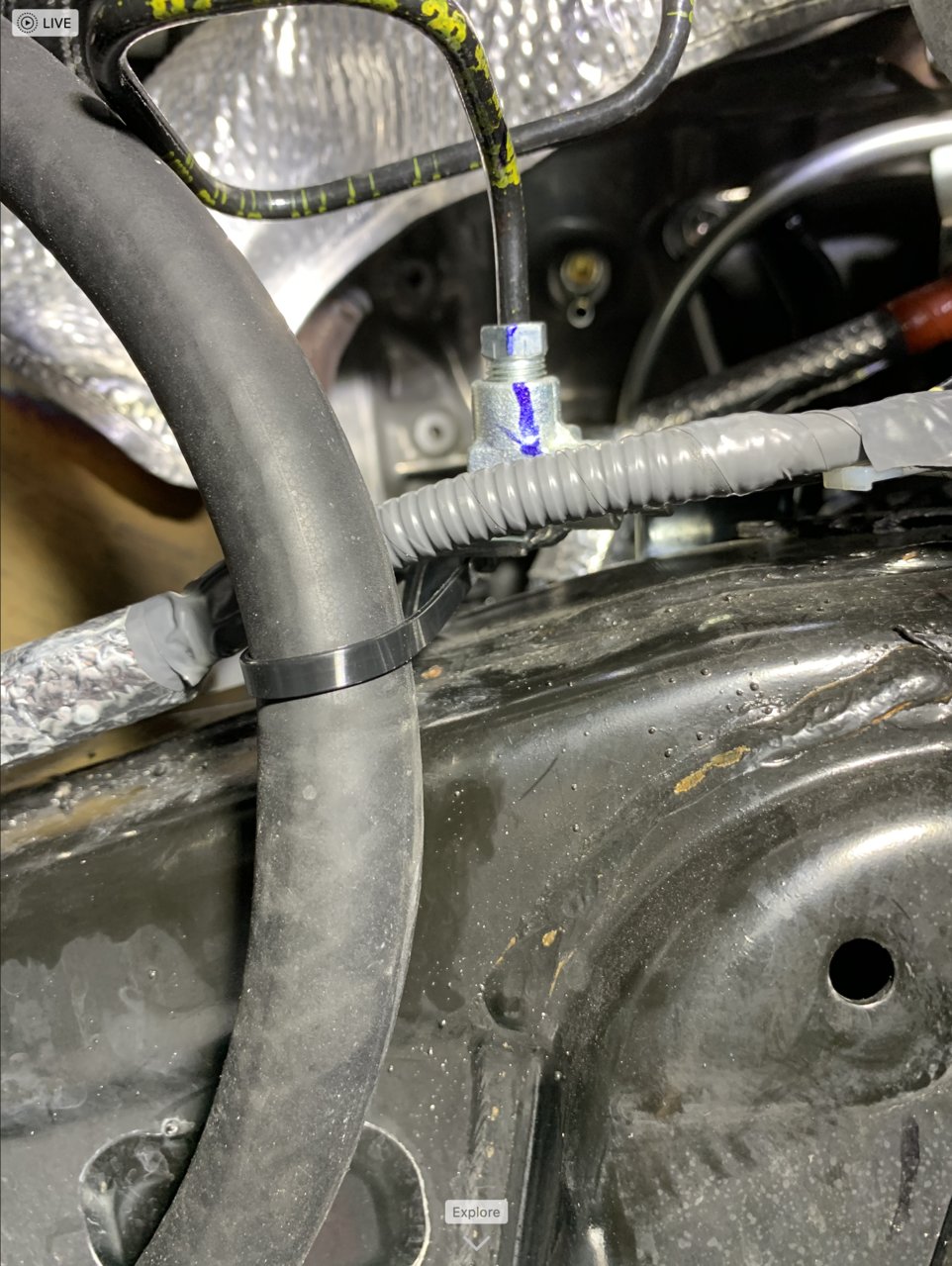

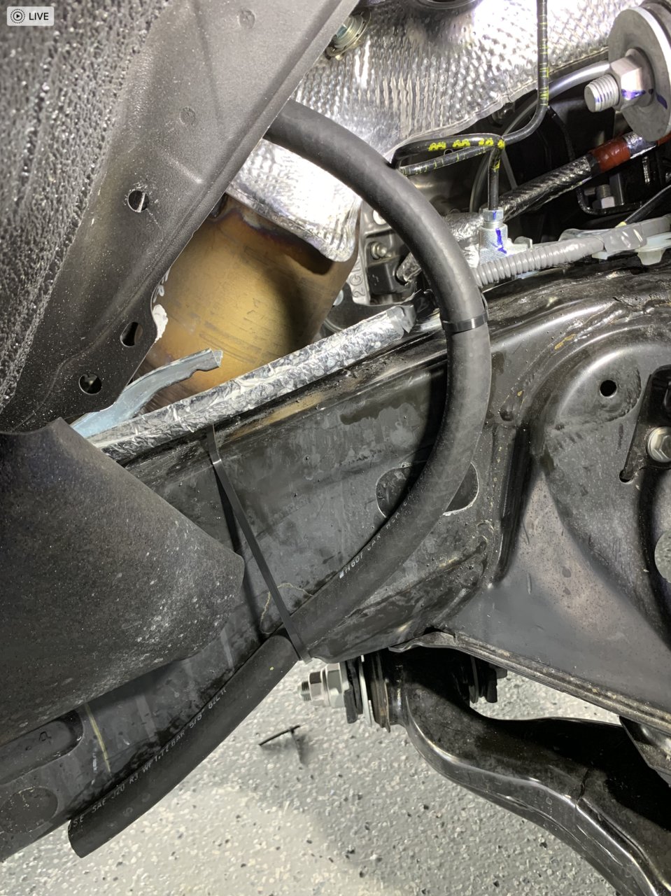

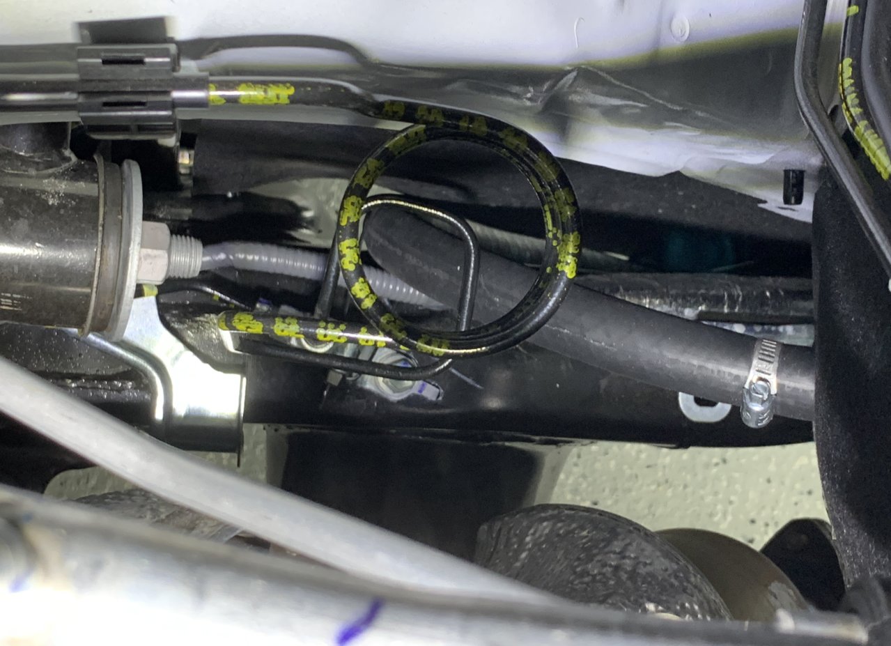

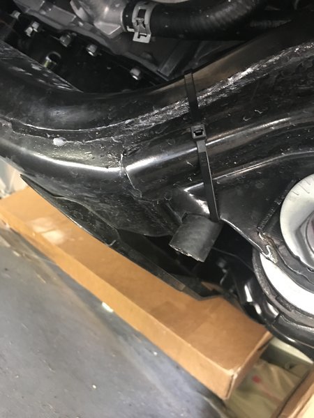

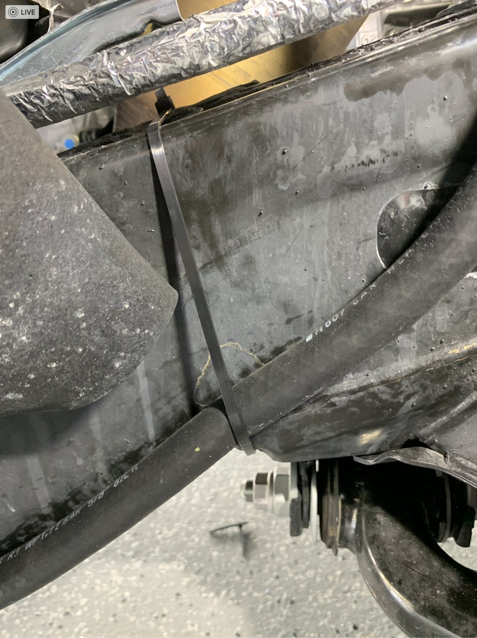

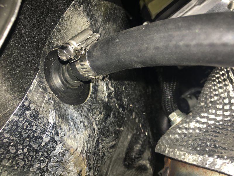

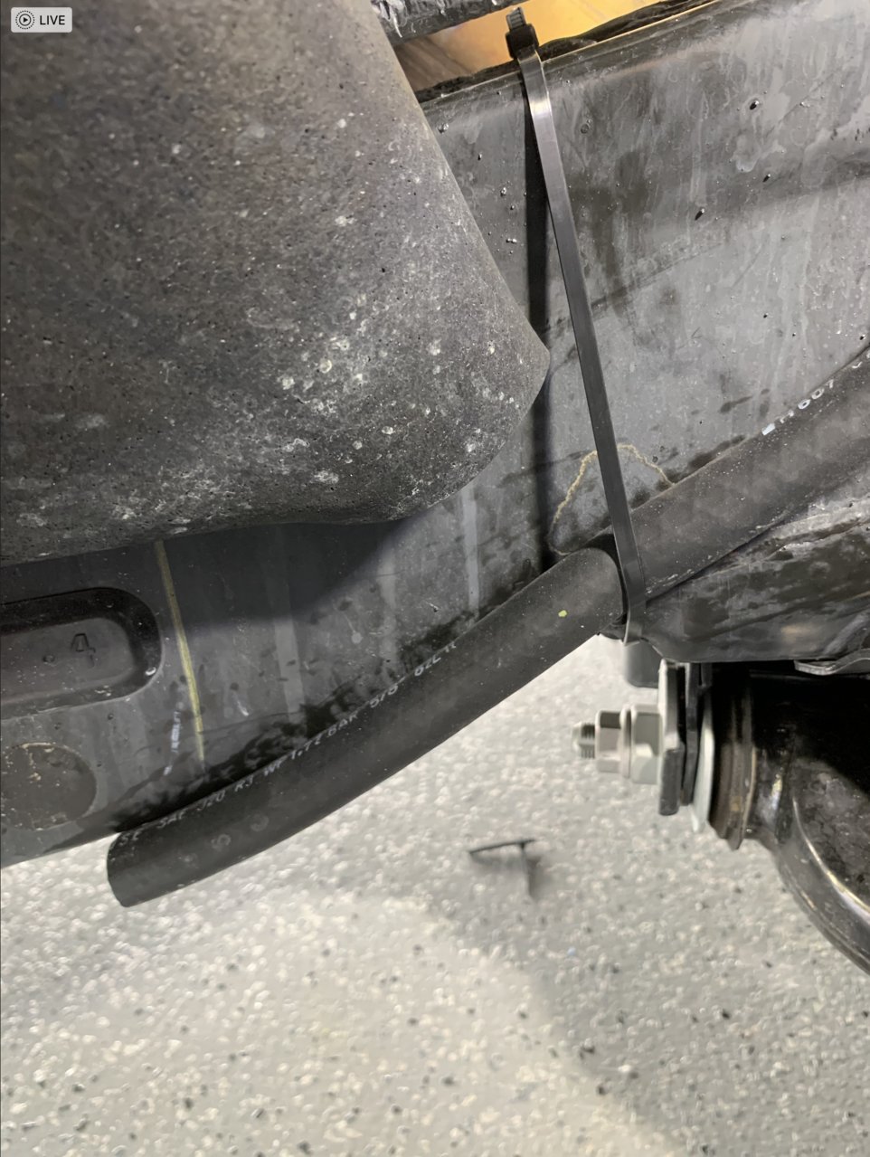

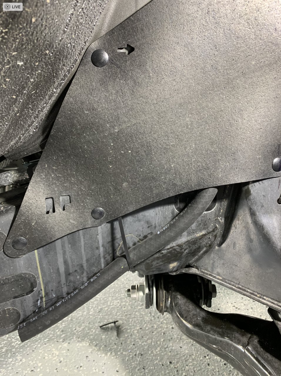

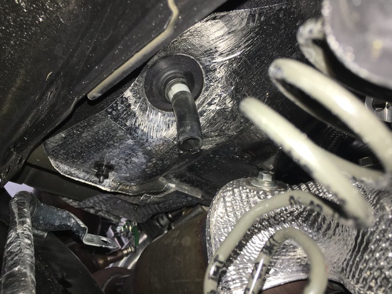

    I ended up routing the hose through the external side of the frame, as far away as possible from the exhaust, I think it ended up well.
    upload_2020-6-14_13-58-35.jpgupload_2020-6-14_13-58-47.jpgupload_2020-6-14_13-59-2.jpgupload_2020-6-14_13-59-16.jpgupload_2020-6-14_13-59-31.jpg

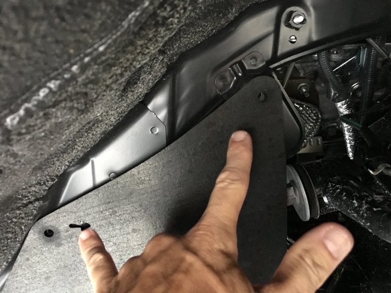

    Anybody know where I can get replacement clips for the little liner? Took them on and off a few times to get it perfect and now the liner flops loose from time to time

    i also needed to replace the clips on mine, so i went with this. the way that i saw it, doesn't hurt to have these lying around in case your truck or other vehicles need some replacements too. plus, there's a removal tool that comes with it! i use one from the bottom row in the first photo.. from L -> R, either the 2nd, 3rd, or 4th. i forget, but it is very secure.

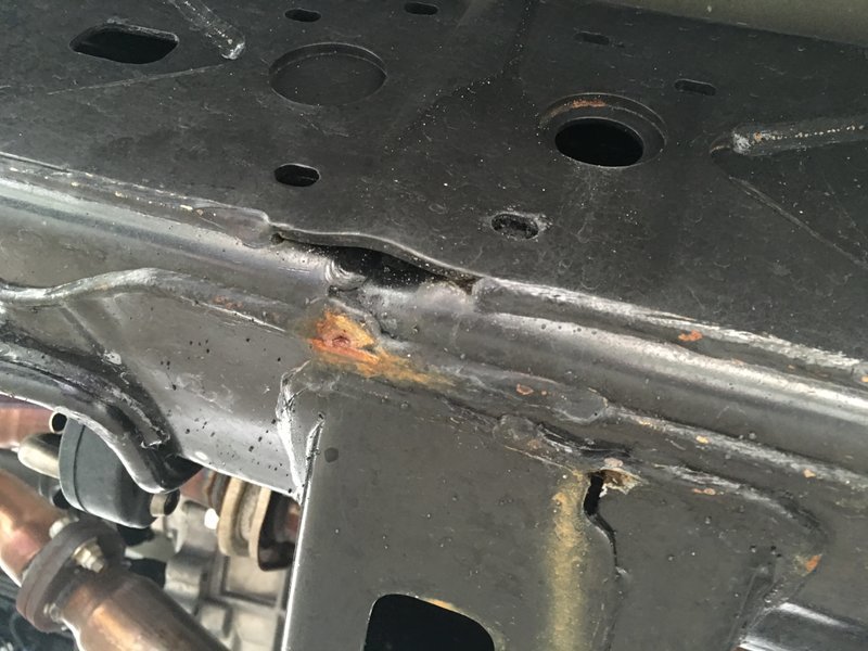

    The A/C dripping on my 2001 1st gen taco was the final nail in it's coffin.
    The a/c drip over 18 years finally caused the right lower control arm to break; least I mention the failed Toyota frame under-coating "solution."
    Do this mod.

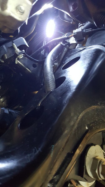

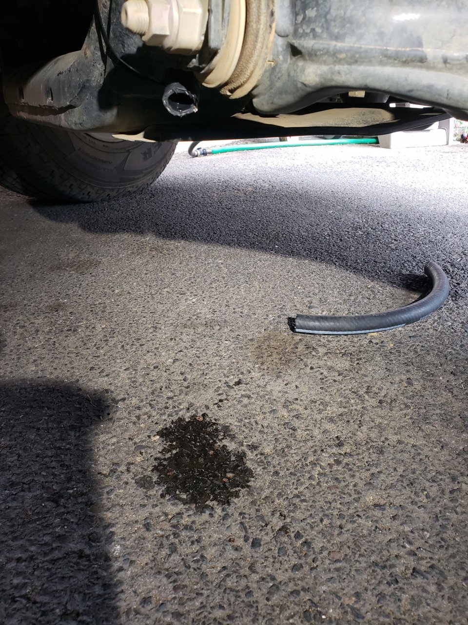

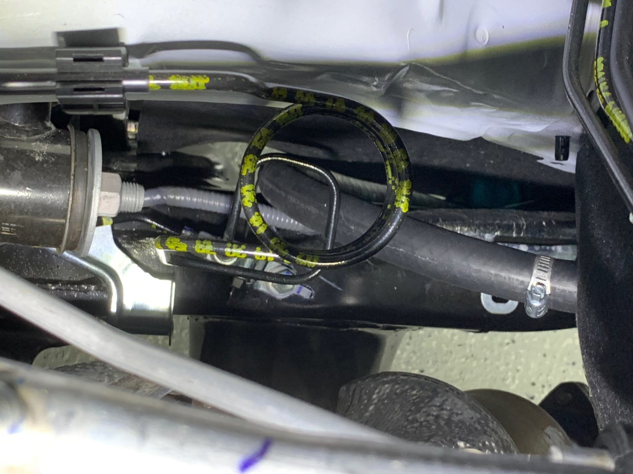

    Did this mod to my truck this week. Thanks for sharing OP!
    7k miles and no rust yet, but this was easy and cheap. No reason not to do it.
