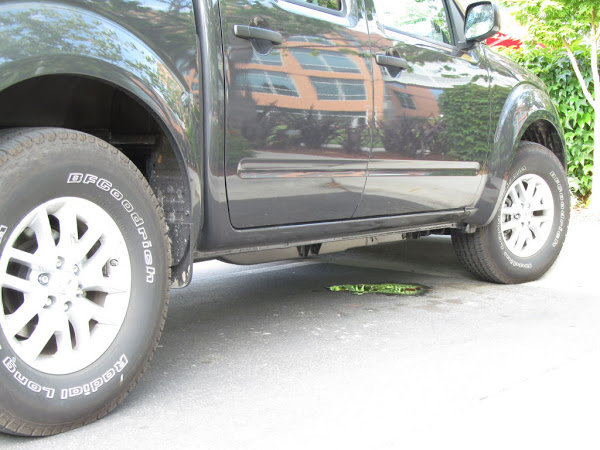

    When you cool ambient air, some water condenses. That's why almost all A/C units, whether vehicle-mounted or stationary, have a hose draining water from the evaporator. It's basically distilled water, very clean. That's why Toyota doesn't care the water drips onto the frame. If you drive through any kind of salted roads in the winter, the condensate water has a negligible effect on frame corrosion.
    Nissan Frontier drains at the same spot:

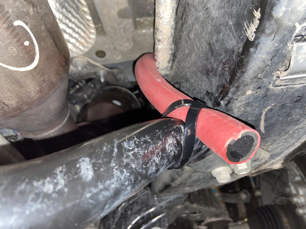

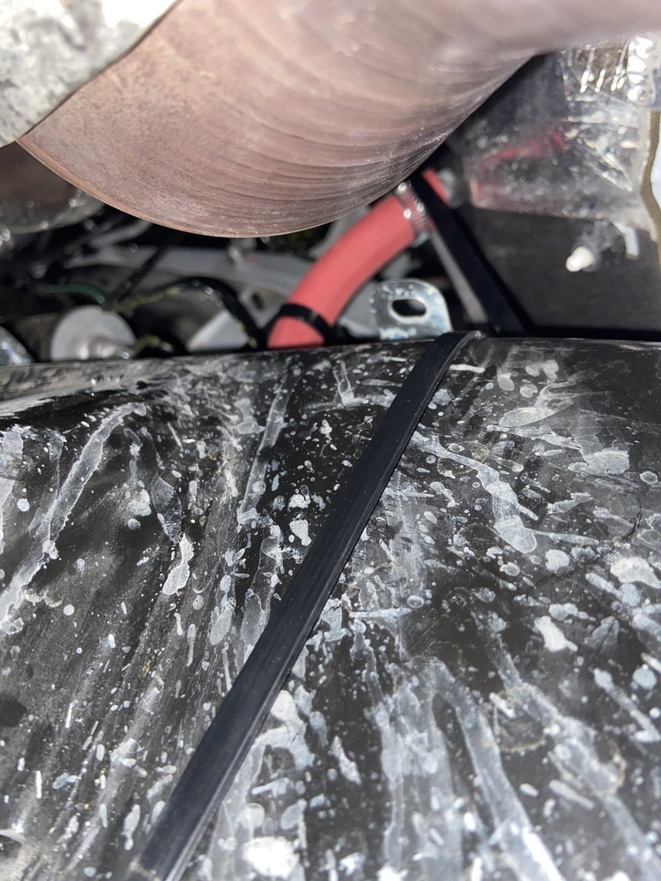

    Did a gentle curve down along the frame and out before the cross member. I reinforced the new hose with zipties that hold the new hose in a curve to take pressure off the factory drain hose. I also used oil to work the new hose all the way over the factory hose. Fingers crossed, but seems pretty stable.
