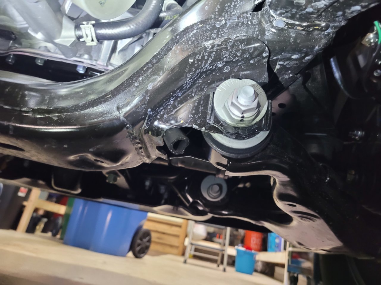

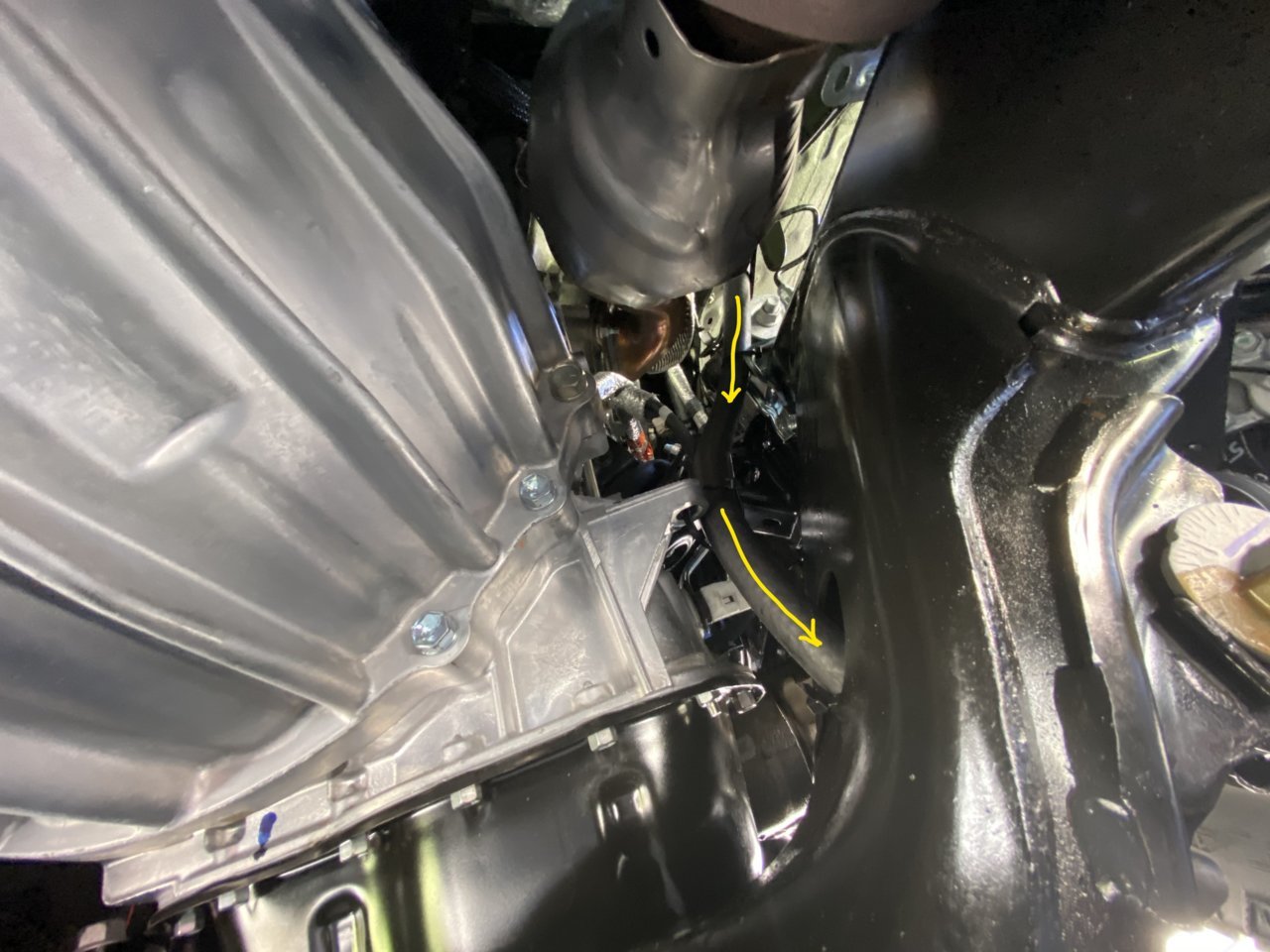

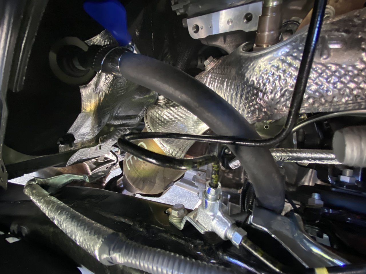

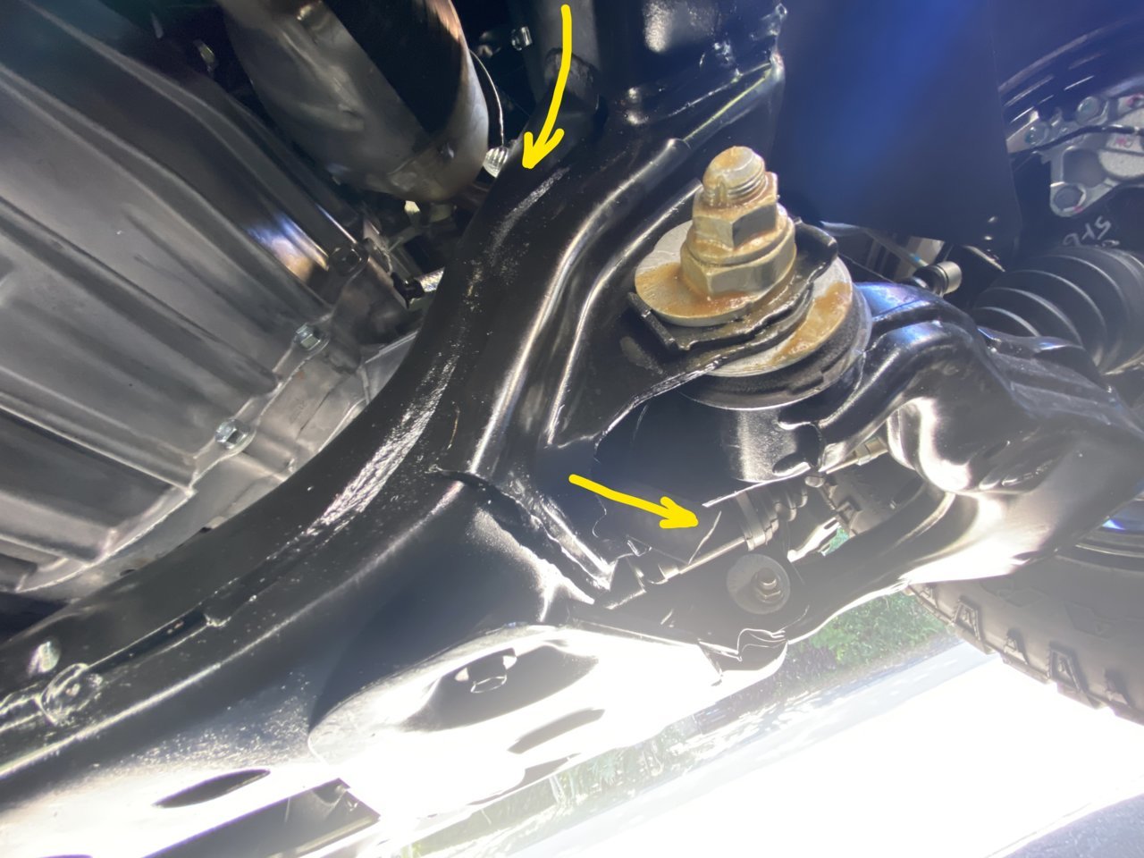

    Got this done today on the Taco. Easy mod and it already works! I'm thankful for all the wonderful people that make this great community! IMG_5392.jpg InkedIMG_5394_LI.jpg InkedIMG_5396_LI.jpg IMG_5403.jpg

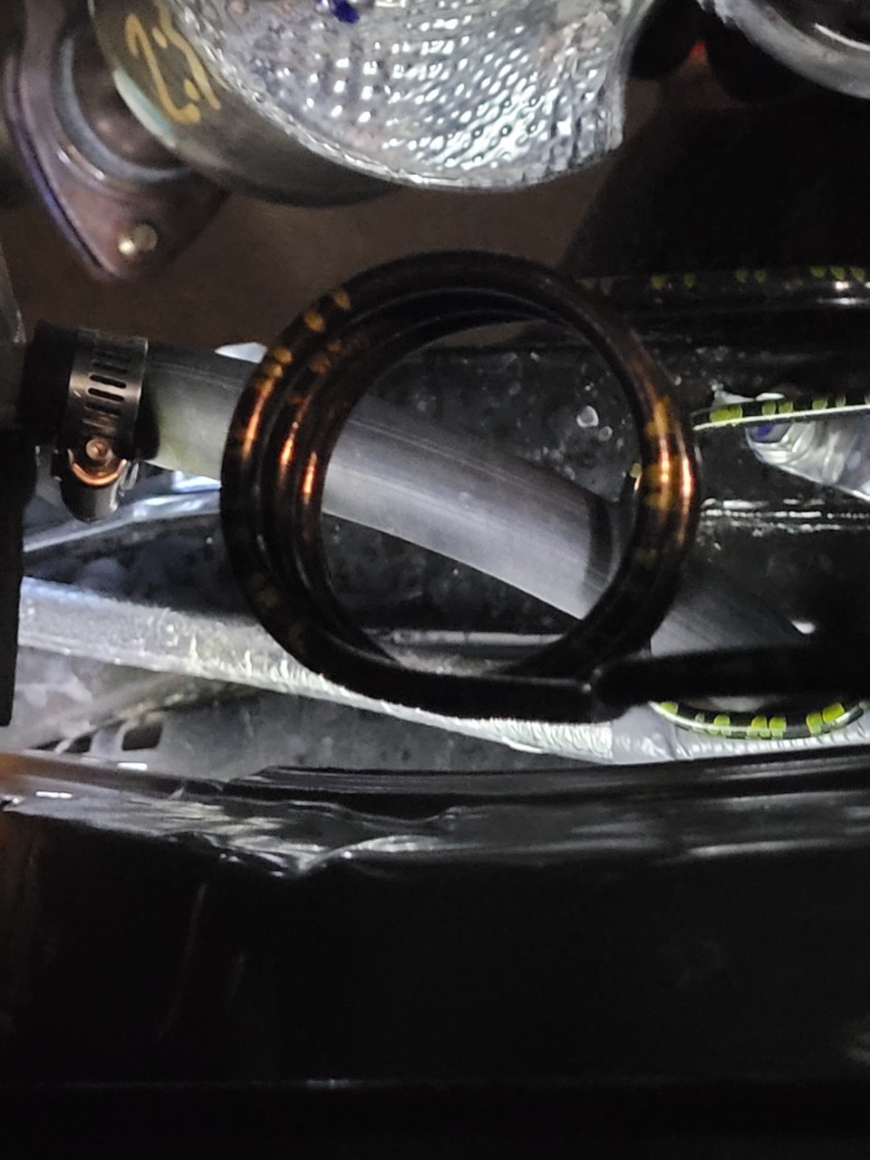

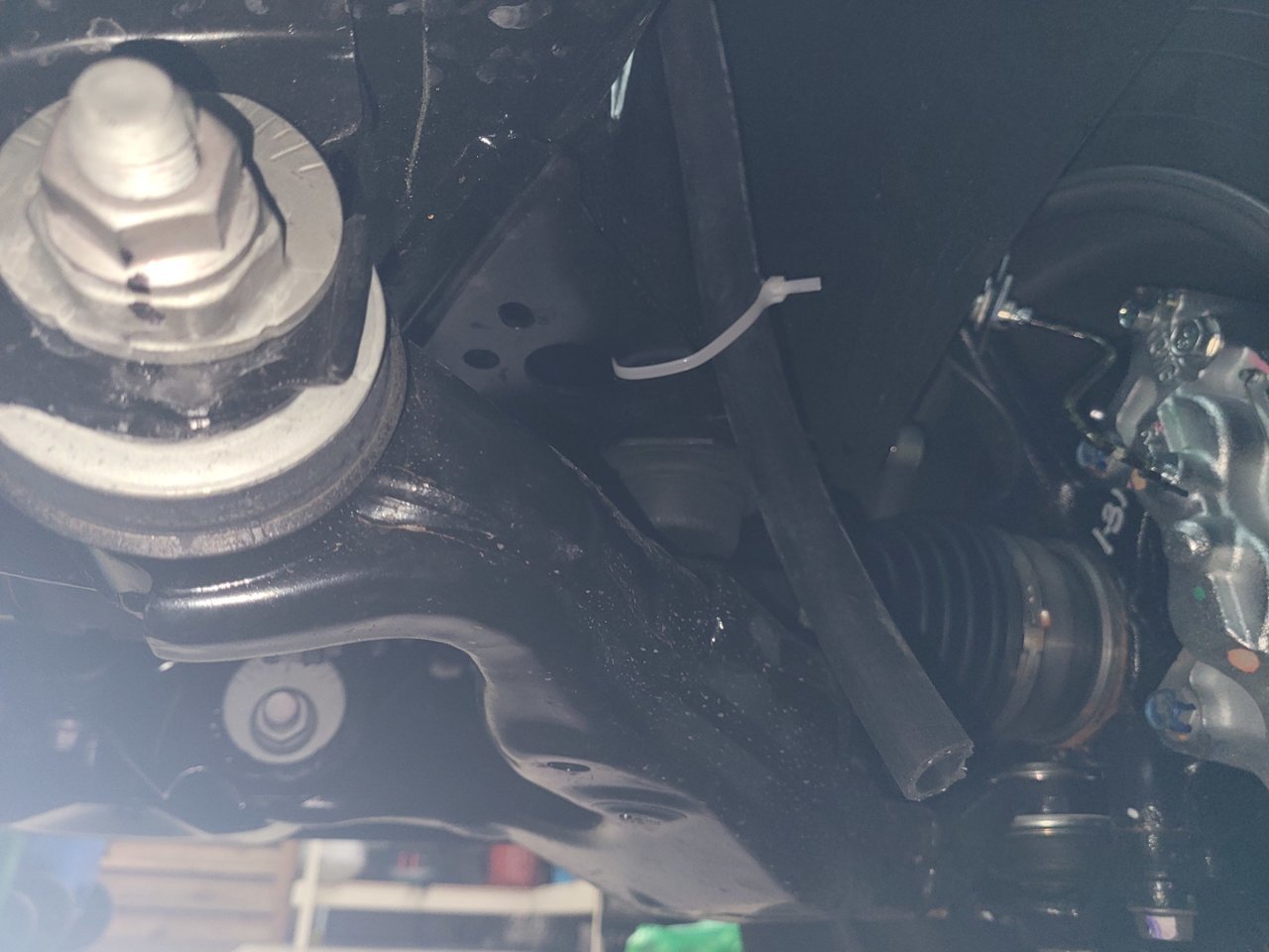

    Just did this mod, thoughts on placement? I'm not 100% sure this is the best location but I don't think it will hit the moving parts and it vents low.
    thomasburk likes this.

    I'd route it a little differently with the drain hose fed through the rear engine/transmission cross member, and out the rear LCA attachment. There's ~1" holes on the inside of the cross member to feed the tube into. I'll take a picture and post in a bit when my truck is back in the driveway later today.

    On second thought, post #821 has the routing I just described clearly illustrated. The only thing I did differently is used a brass 2x male 3/8" coupler (HFT air line adapter) to make the connection to the stock drain.

    Thanks JMAC, I'll take a look at that post and route that way. I appreciate the guidance.
