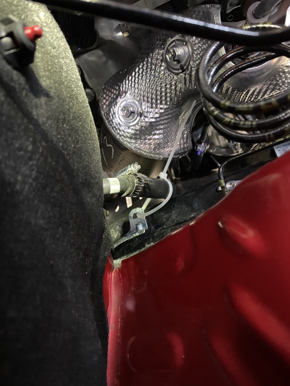

    I went through this process and got it connected. I ran the truck (parked) for 20 minutes, max AC and it did not drip at all. I did not crimp the clamp down that tight... is that normal?
