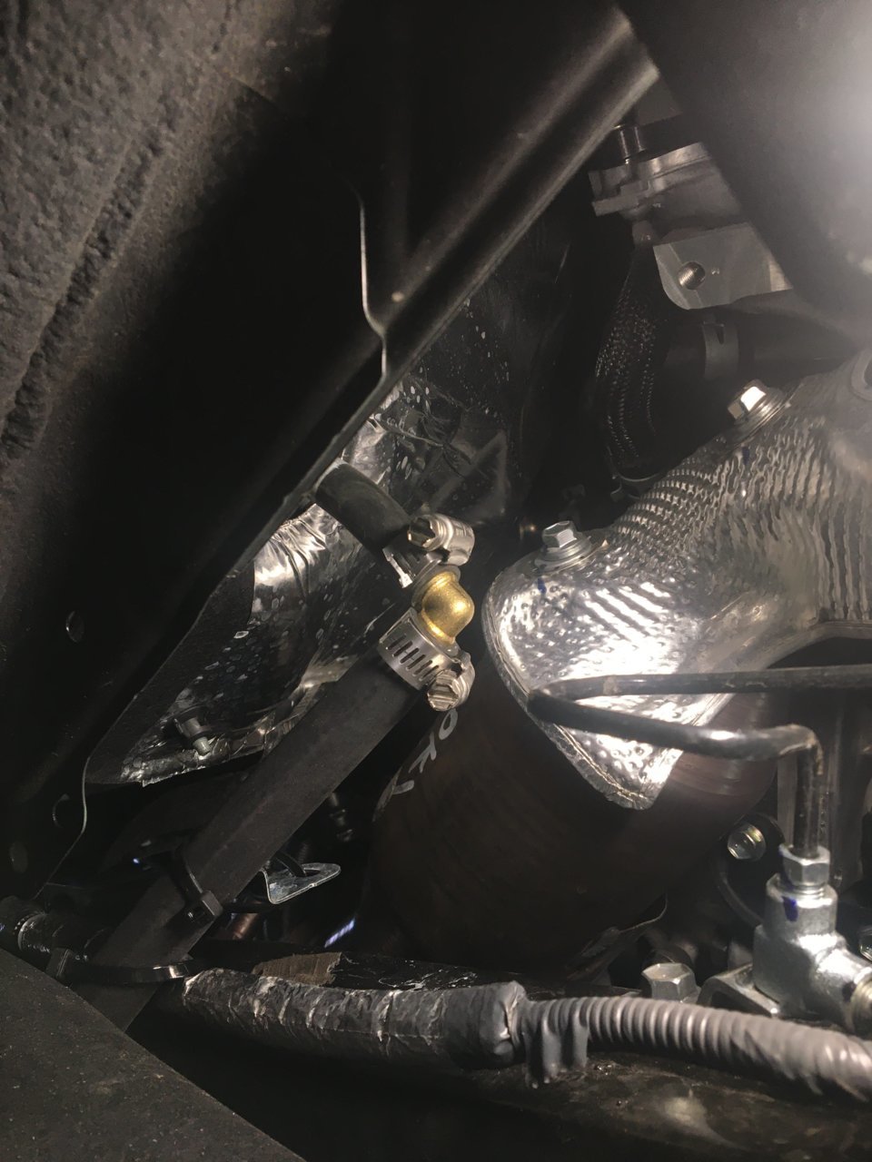

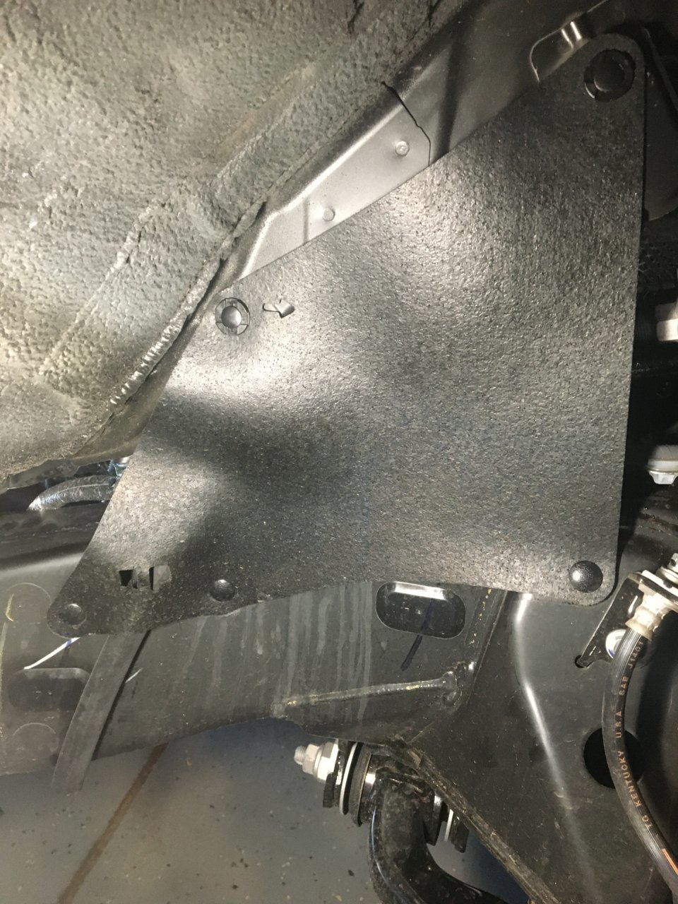

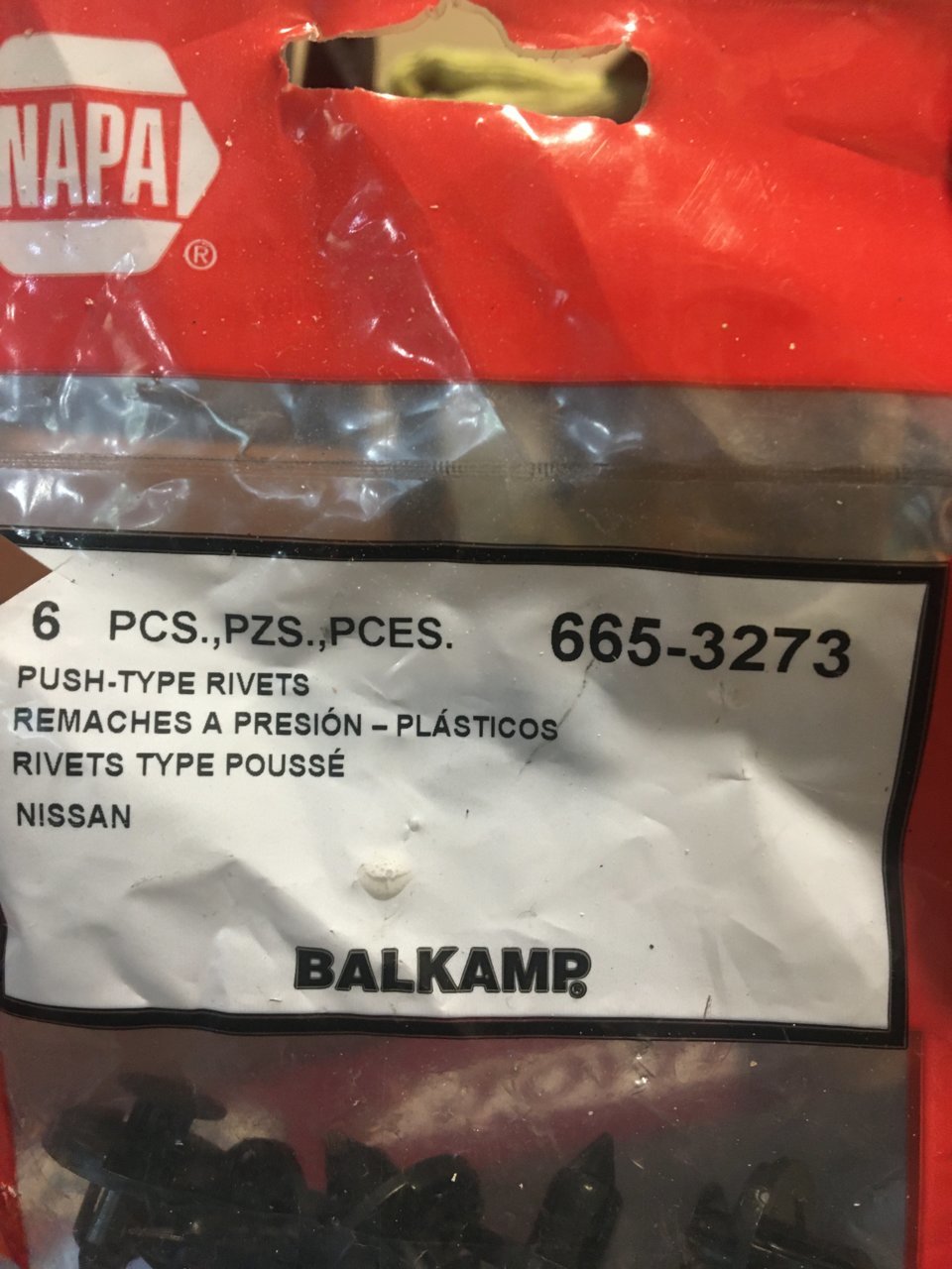

    Did this mod yesterday. Used a 1/2 90 degree PEX connector and 1/2 ID heater hose from ACE. Took the simple and direct route. I will have to reinforce / zip tie the hose as it exits the splash shield. BTW the NAPA Balkamp push rivets fit perfectly in the holes for the splash shield (and for the radiator shield,I used these on my 2nd gen), are reusable and are more snug in the holes. The ones on the splash shield snapped upon removal - perhaps due to my impatience.IMG_2750[1].jpg IMG_2751[1].jpg IMG_2754[1].jpg

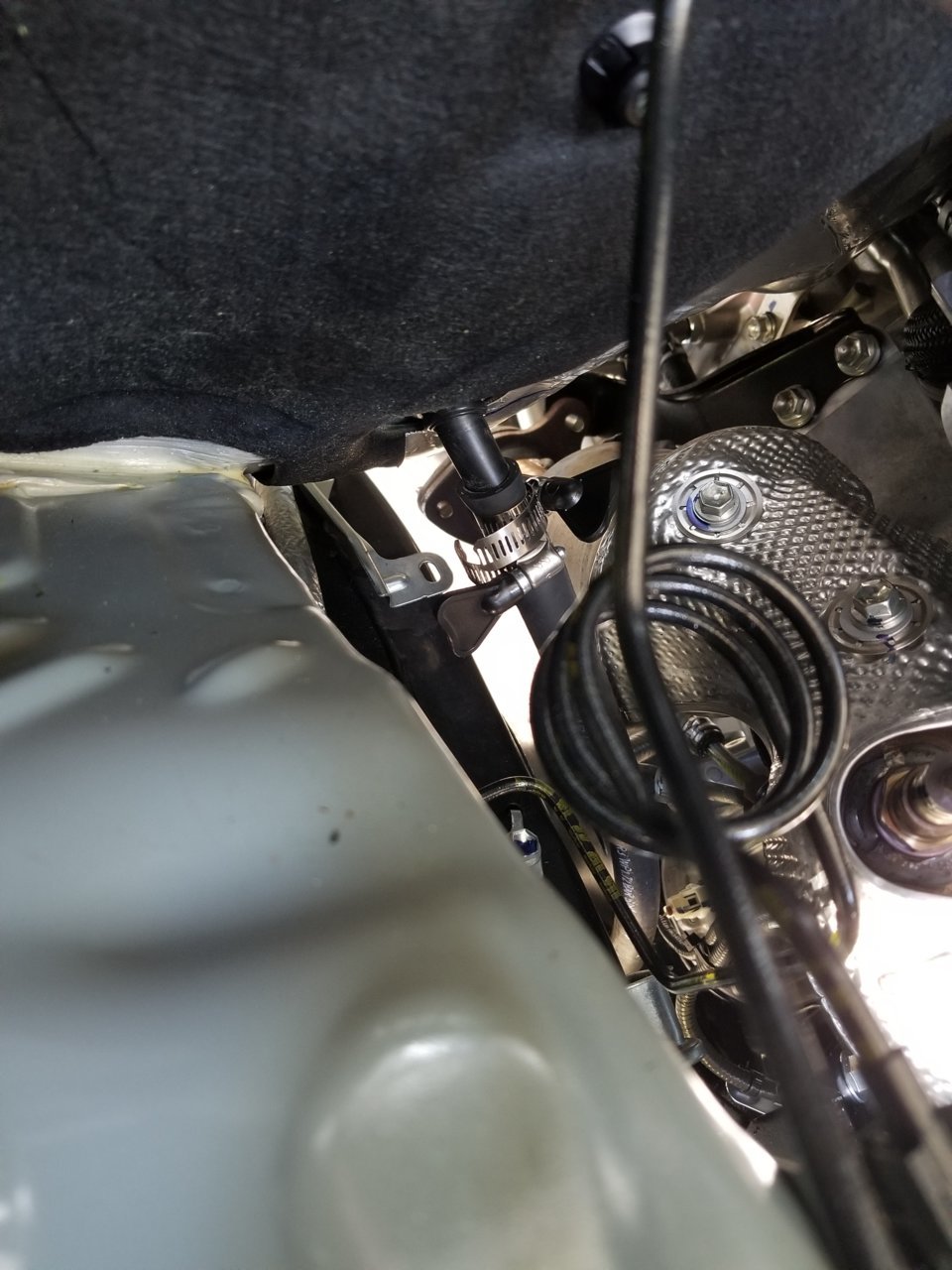

    Thanks for this tip. Just completed. Less than 500 miles and already sprayed with rust proofing but cheap and easy PM. 20220710_171957.jpg

    I just did this mod as well on my 22 Tacoma. I've only had it for a couple of weeks, but thought its very cheap insurance, and it gave me a chance to get to know my truck a little better. Now off to NAPA to get those replacement clips that @jneutron was nice enough to upload a photo of. $7.50 for a package, whatever number that is. Thanks to all !
