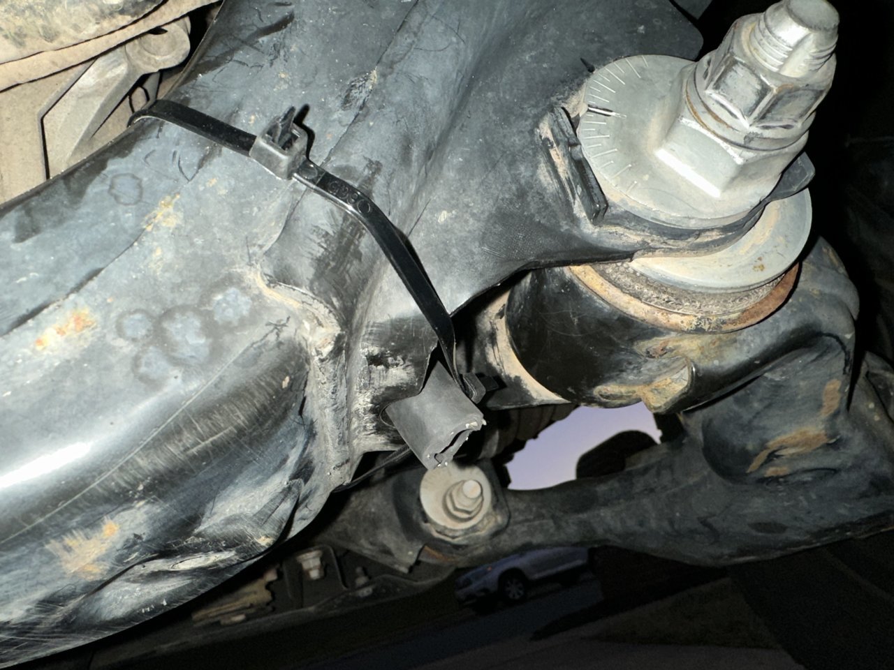

    Gone through a lot of this thread. It does look like a dumb output spot, but it seems like more people are going to get rust from Zip ties rubbing on metal components than from the line dripping.
    TexasWhiteIce likes this.
  5. Oct 12, 2022 at 5:01 PM
    #885
    Lunartic
    Lunartic Well-Known Member
    Feb 14, 2022
    #390155
    97
    New Jersey
    No zip ties used here. Out of the drain I turned left and passed it down through the cross member. It's not going anywhere.

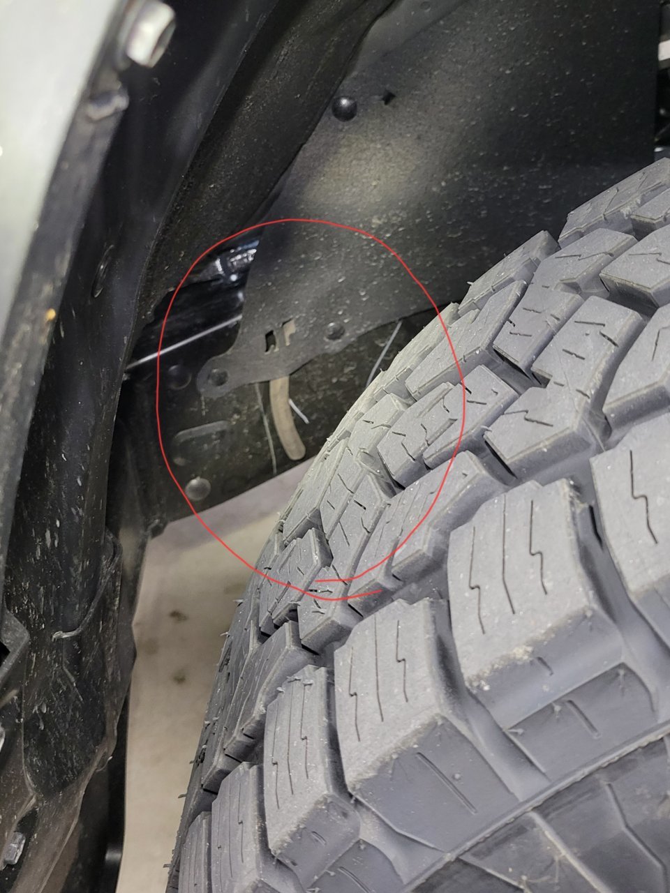

  6. Oct 28, 2022 at 5:48 AM
    #886
    AZ23OffRoad
    AZ23OffRoad New Member
    Oct 27, 2022
    #409165
    4
    Peter
    Cave Creek, AZ
    2023 Tacoma TRD OffRoad
    Thanks for sharing, thats a really slick idea.

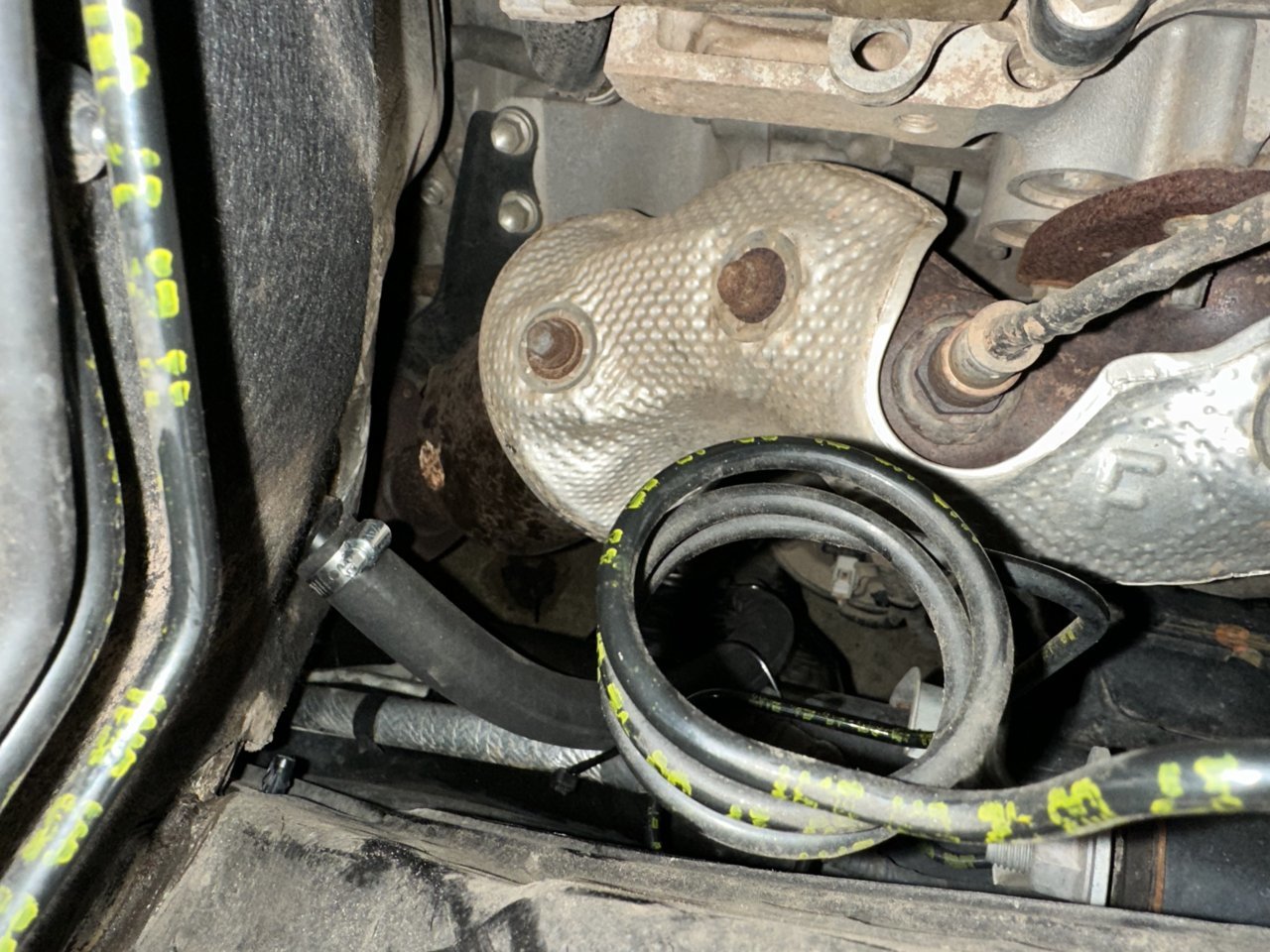

  9. Dec 29, 2022 at 2:25 PM
    #889
    baltimorebirds2
    baltimorebirds2 tacomama
    Mar 12, 2022
    #392483
    355
    Brooks
    Maryland, United States
    2018 MGM Tacoma TRD Sport DCSB 4x4
    TRD Pro 17” Wheels, Toyo Open Country AT3 33s” (255/80/R17), Hooke Road Offroad Roof Rack, LEDs (Low Beams, High Beams, Fog Lights, Interior Lights, Reverse Lights, License Plate Lights), Diode Dynamics SS3 Sport Fog Lights (Yellow), Sequential Turn Signals, OME Nitrocharger Plus, OME 4004's & HS 0.5 Spacer for 3" Lift, JBA UCA, Icon RXT Option 2 Leaf Springs 2.25" Lift, Yukon Clamshell Bushing, Alpine ILX W-650 Stereo, Infinity Primus 6004a Amplifier (140w*2), Sound Ordnance M75-4 Amplifier (75w*4), Infinity Kappa 693C Component 6x9 Speakers, Infinity Kappa 63XF 6.5 Speakers, TRD Shift Knob, Black Emblem Overlays, TRD Grille Badge, OEM Door Sill Protectors, Driver’s Seat Jackers, Pop and Lock Power Tailgate Lock, AJT Designs start button and trim, 4x4 knob, shifter trim, and cupholder trim, MESO Customs Vent Rings and Door Handle Covers, Gasshole, Drop Stops, AC Drain Mod, Bed Lights, Rough Country Roll Up Tonneau Cover, Window Tint, KDMAX Tune
    Shouldn’t, I mean all you’re doing is slipping a rubber hose over the original and tightening it a little bit with a hose clamp.
    What I was a little worried about was the fact that some more tubing came out when I pulled on it a little bit because it took a minute for me to figure out that there wasn’t a nipple there at the firewall.
    May have been a little slack in hose? Since a little bit more came out. I mean you would have to give it a real big yank for it to come off of the evaporator right? I’m assuming it’s clamped to a nipple on there? I just want to make sure it didn’t start pulling off internally or something. Or is it built into the evaporator somehow?
    It wasn’t loose so should be good there. Kind of curious if anyone accidentally managed to yank their factory drain line out. :confused:

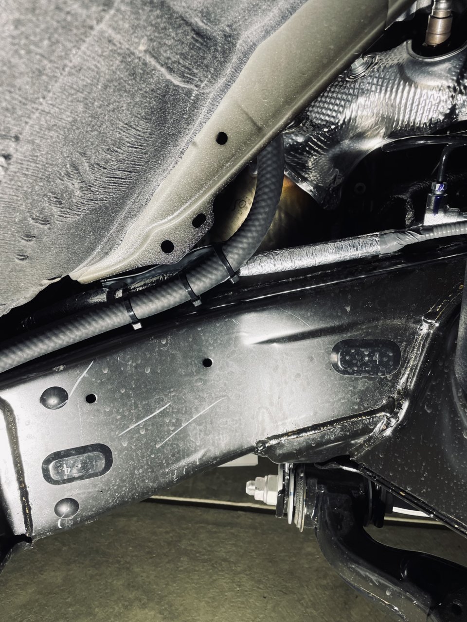

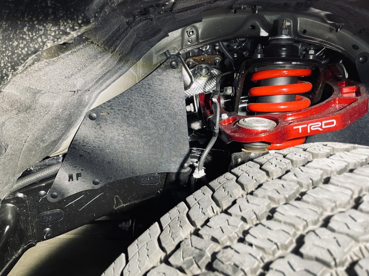

  10. Dec 29, 2022 at 2:37 PM
    #890
    baltimorebirds2
    Mar 12, 2022
    #392483
    355
    Brooks

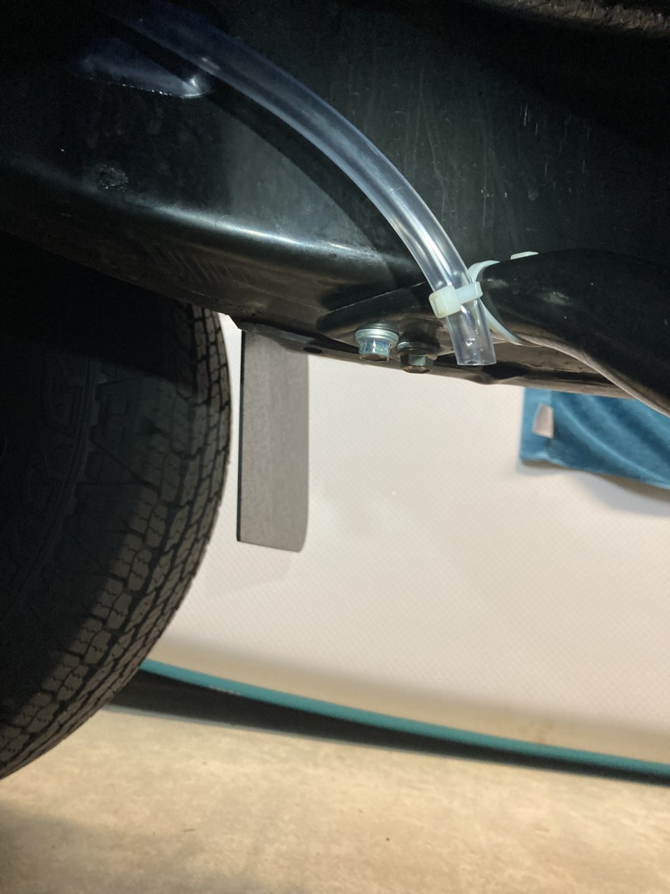

    Managed to get mine installed fairly easily. Got some continental 5/8” heater hose from autozone, 7 bucks I think. Then got a 5/16” to 7/8” hose clamp, (looking back I should have gotten one a little bitter at maybe an inch or so I have a little more wiggle room to get it on the hose.)
    Basicslly slipped the hose over the stock drain hose. Silicone spray helped. Ran it down near the cat, right next to the trans cooler lines, through that hole in the frame, and then out at the bottom next to the lower control arm.
    You can see I attached zip ties to each other to wrap around that part of the frame. Some of you were mentioning a lack of zip tying, so there you go, haha. It works, haha. The rest is self explanatory I guess…
    908tacoma likes this.

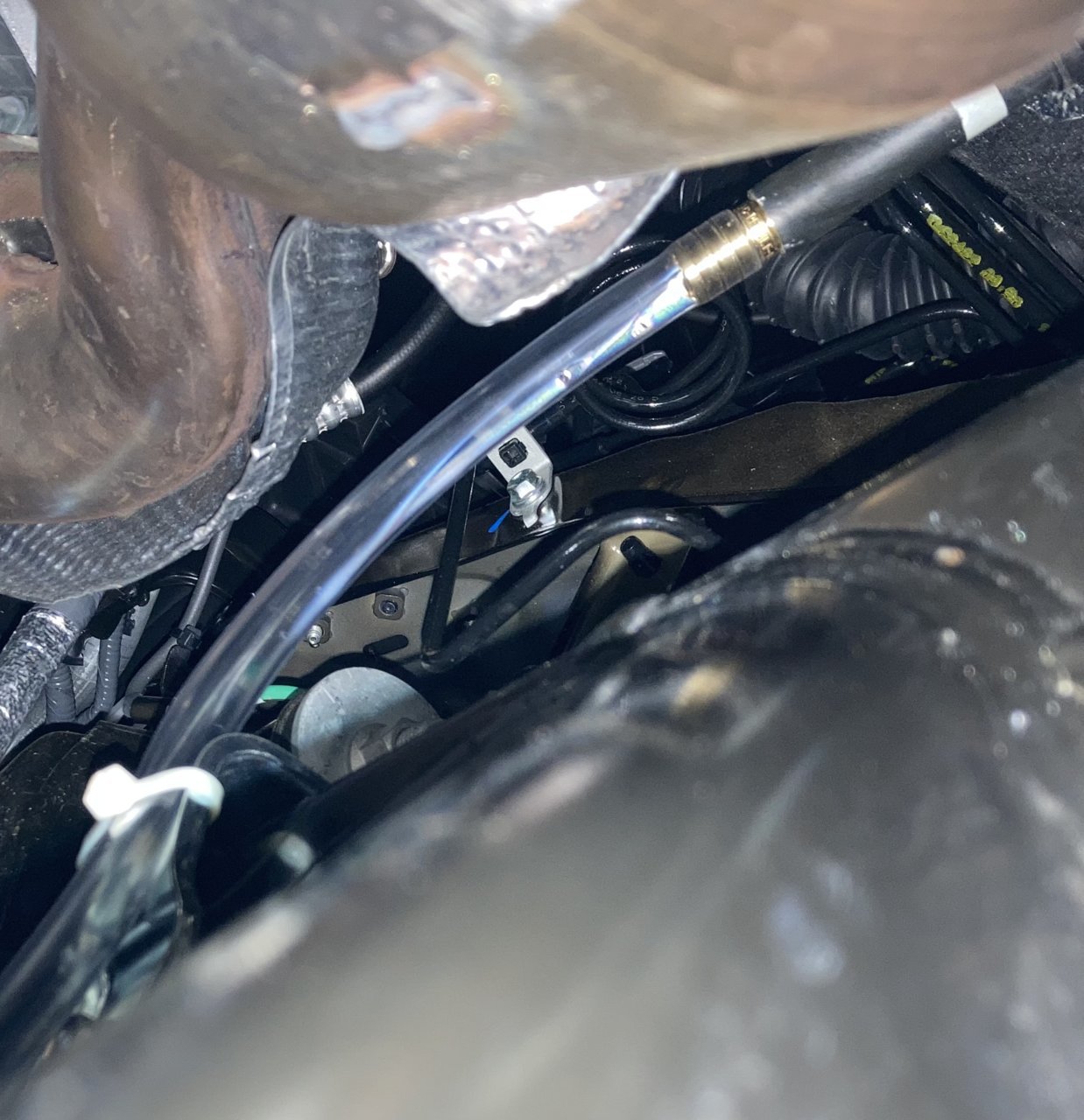

  11. Jan 5, 2023 at 5:56 PM
    #891
    rybern
    rybern Well-Known Member
    Apr 3, 2017
    #215281
    2,698
    N Alabama
    2025 TRD OR & 2000 SR5
    I just did this on my 2023. One plastic 1/2" PEX coupling and a piece of 1/2" ID thin wall rubber hose and this looks like it came from factory. No clamps needed.
    I did use one zip tie to keep the tubing in position.
